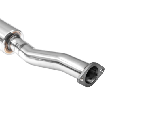

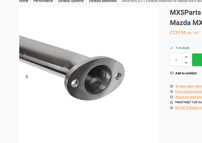

My backup choice is the MX5Parts manifold. And I’ve no problem hitting “Buy Now”. But, theres a slight difference in shape when it comes to the flanges that bolt to either side of the cat (or bypass in my case). I’ve posted picture below to illustrate, but was wondering if I need to worry about whether they would fit together without leaks etc.
For brevity, the bypass has the same shape flanges as the Cobalt midpipe/backbox system I have fitted already (picture #2). By all means, I’d love to have the full Cobalt system, but £670 for a manifold is just a little bit crazy for me :smiley:

As long as the diameter is correct and bolts are the same distance apart it should be fine - 1st photo looks like there’s just “extra” metal left on the flange.
