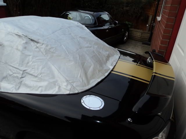

 I have something in the bat cave which sounds like what you are looking for, i’ll dig it out and post some picsWink
 mx/roadster hood cover 1
It looks like a dealer thing?

Mazda-mender, where did you get that cover sheet from? It looks fab. Its a shame you can’t get anything that only covers the interior trim when the cars parked though, be great if I could drive mine to work on a sunny day, leave the roof up with the windows down so it didnt get too hot and just cover the trim. I can always put seat covers on the seats to protect them.
