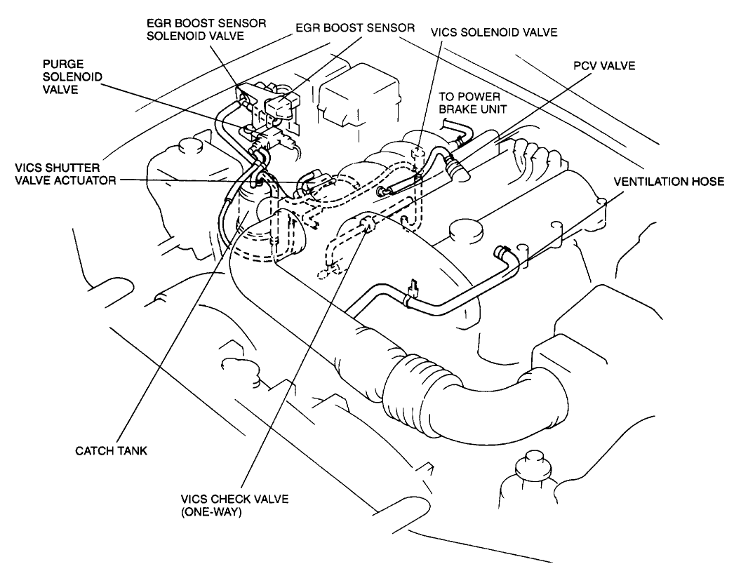

Your symptoms are still consistent with a fault in the fuel vapour EVAP system, but as pointed out, also a dozen other things.
This is the layout on a NB; what is labelled as a catch tank is a charcoal canister
If this system is faulty, it will lead to a saturated canister, and fuel vapour will just bleed through the numerous rubber-on-metal joints.
