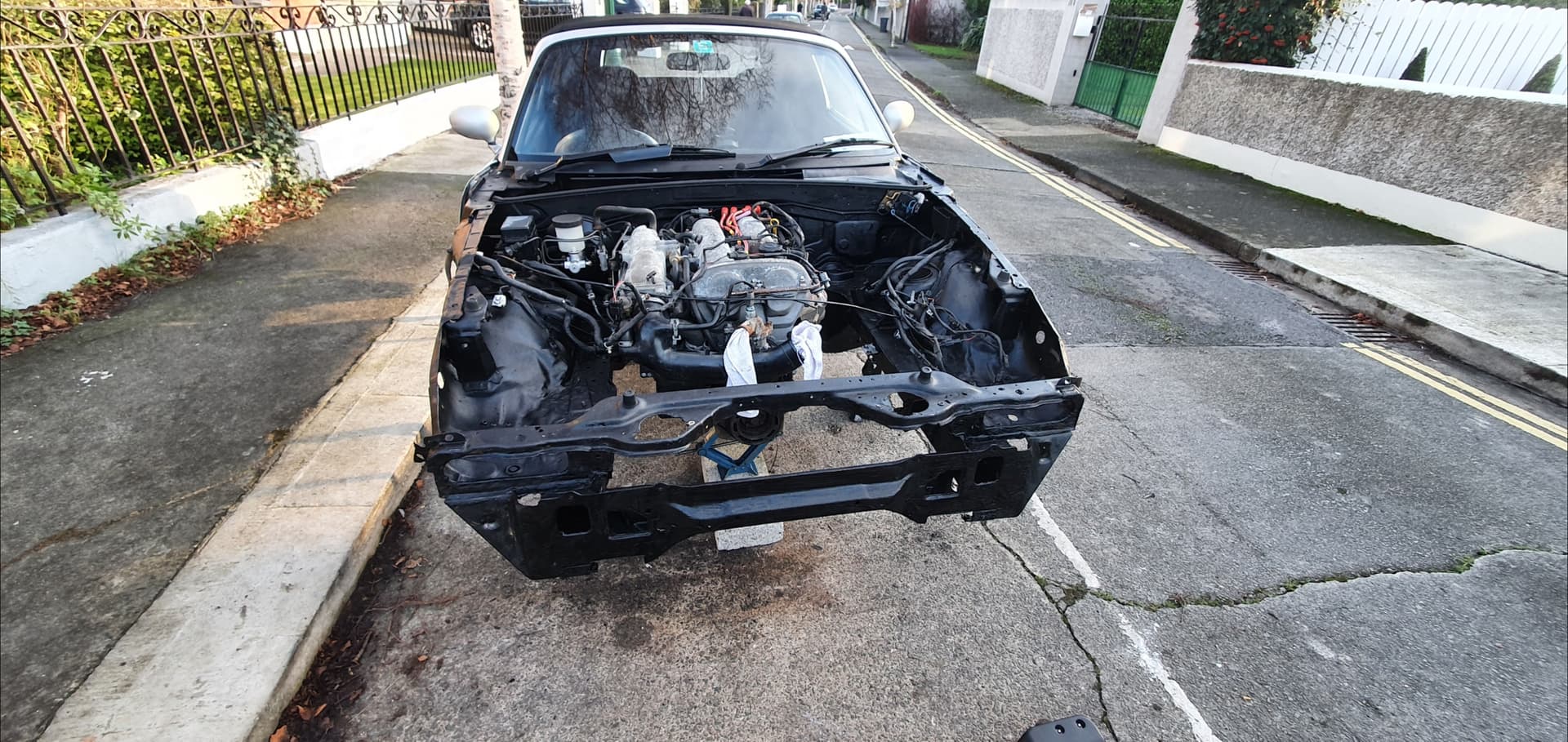

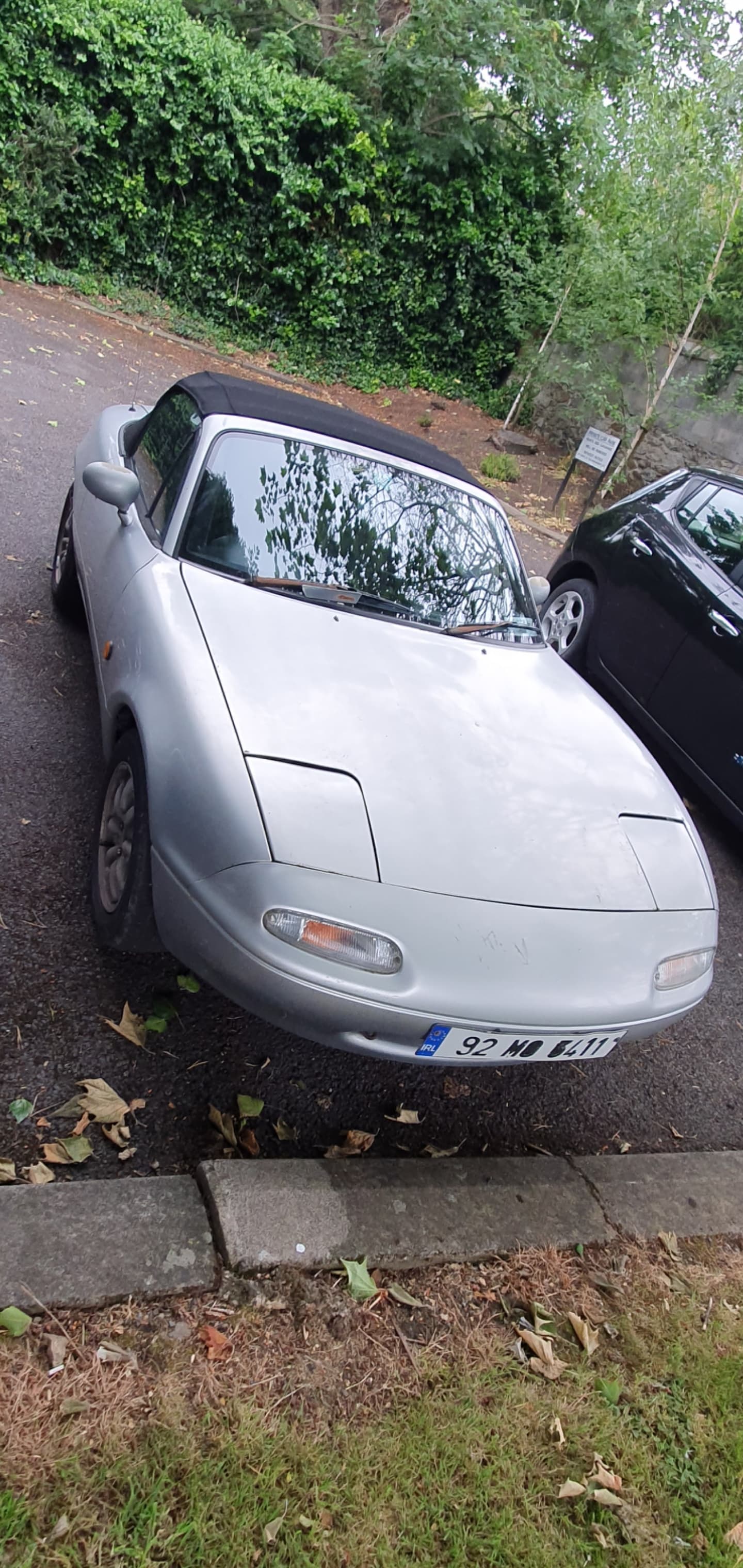

Finished main parts of my build. Now to enjoy and make lists for the engine parts
Got this 1992 1.6 eunos a few months ago for free. 50k km on the clock and was laid up in a yard for about 12 years. Finally finished all the major work before I’m moving on to the engine mods over the next however long it’ll take, but will drive her on stock power for a while.

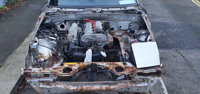

Work done:

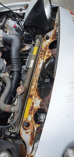

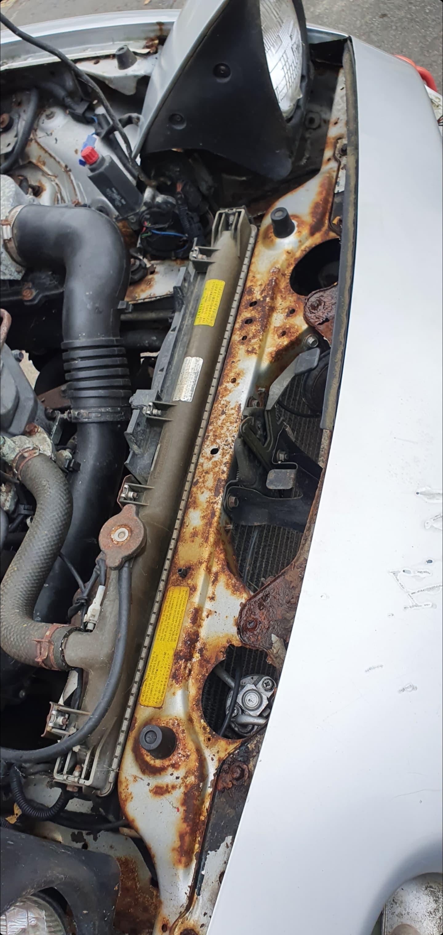

All rust removed under body and in engine bay, painted with 2 coats of hammerite waxoyl. Including subframes and control arms, sway bars, etc. Rust, bye bye.

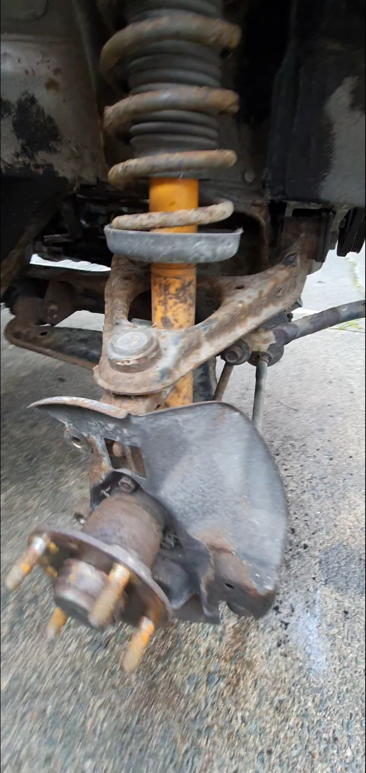

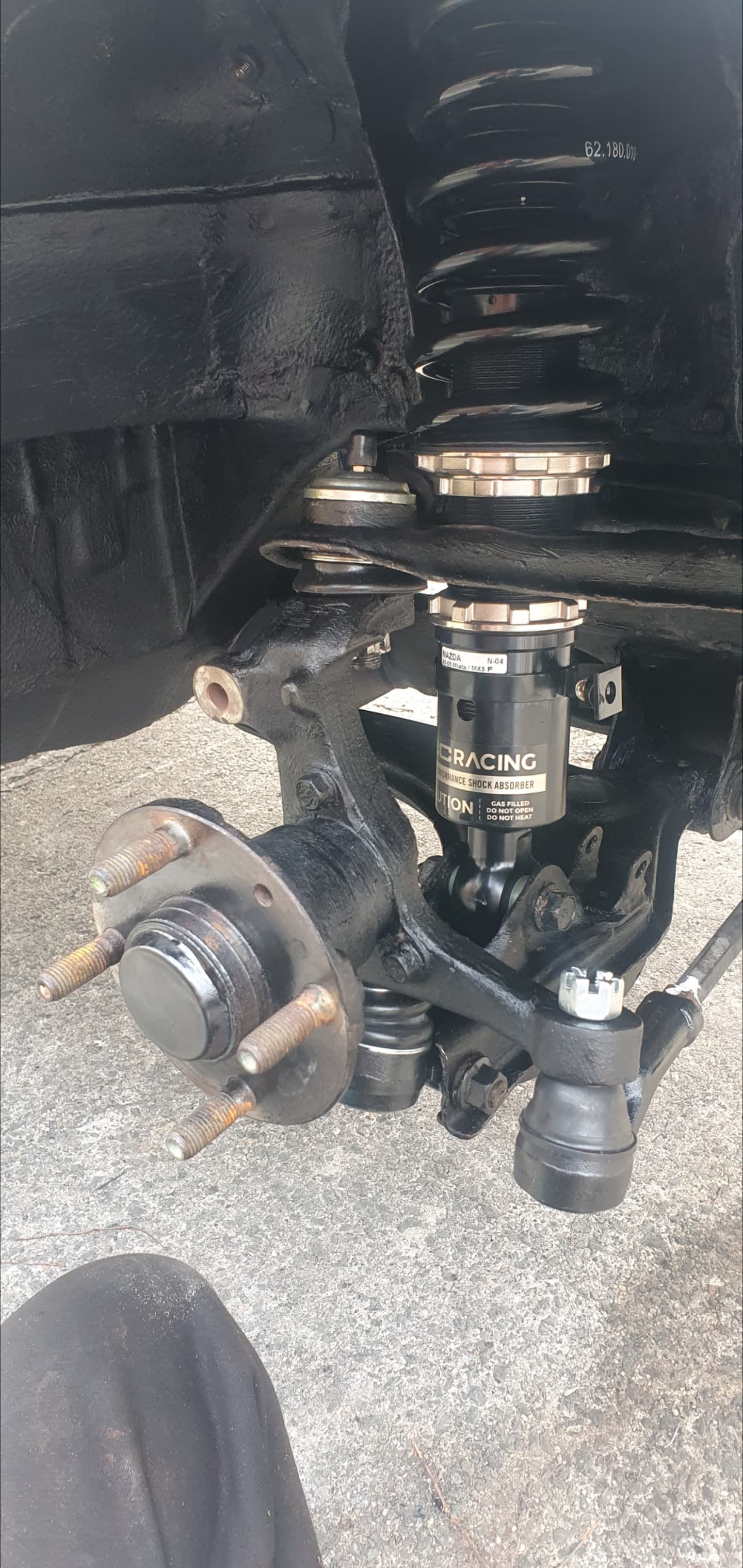

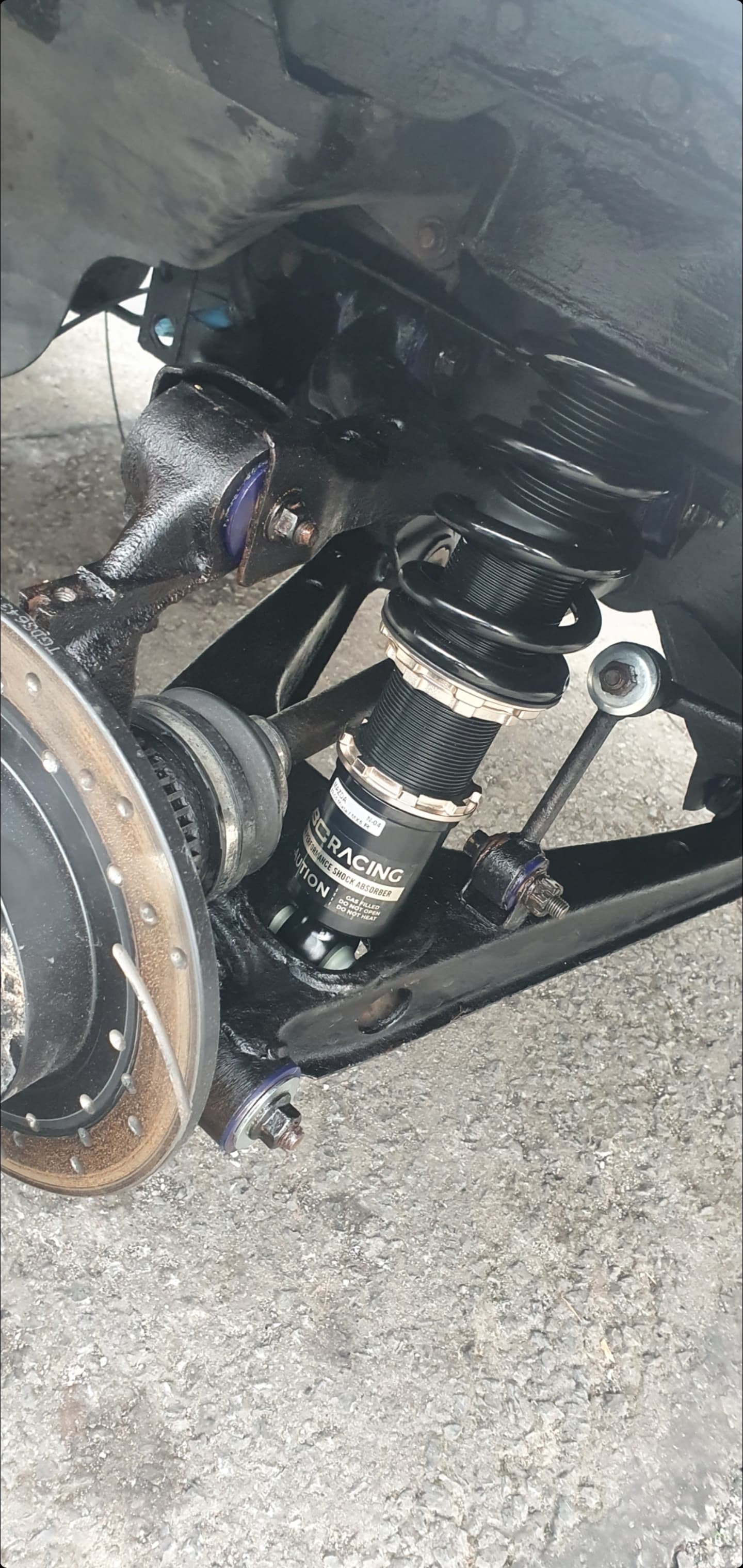

Superpro polybushes for suspension, sway bars and diff mounts.
Polybush engine mounts.
BC racing coilovers.
Tie rod ends, upper and lower ball joints.

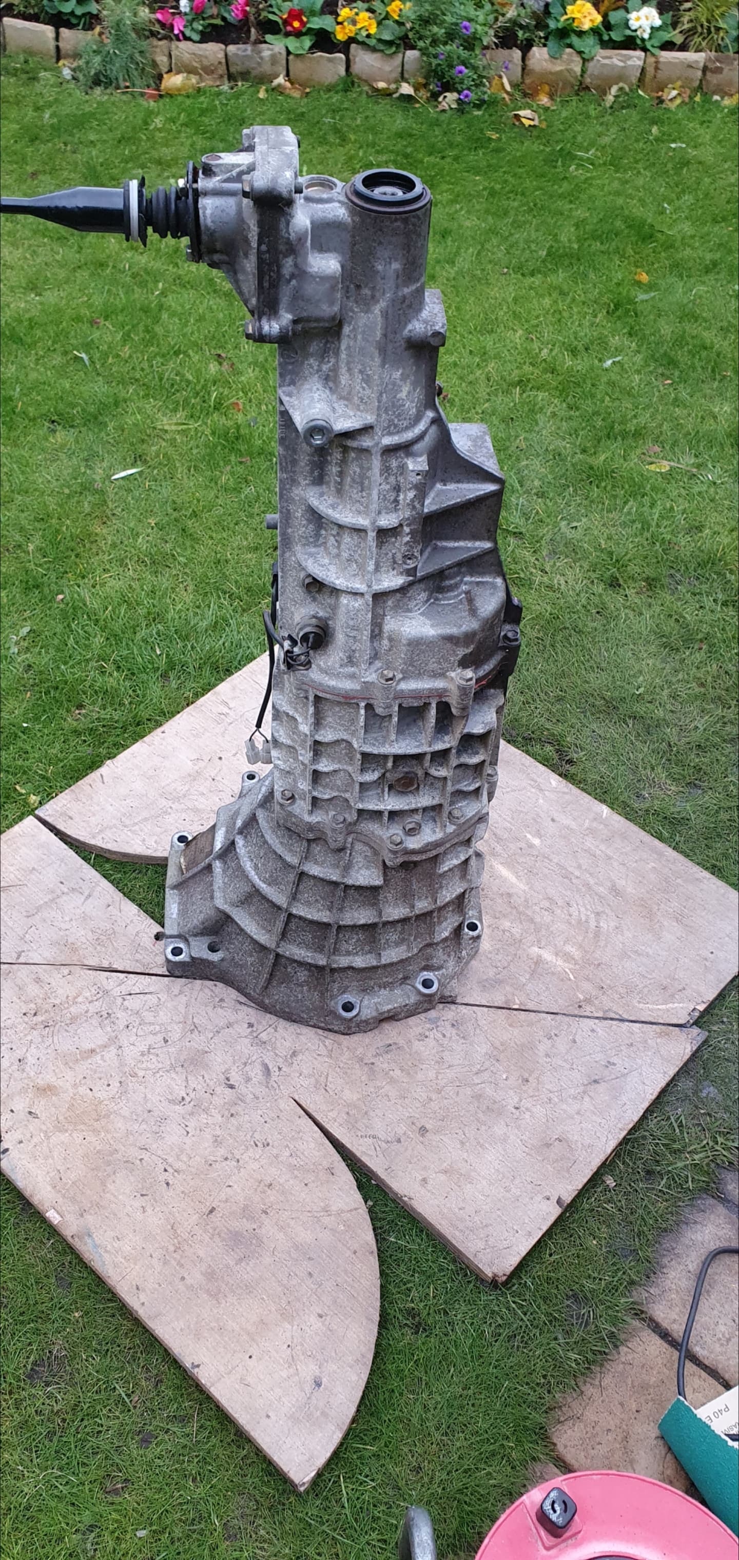

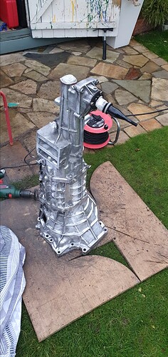

Torsen type 2 lsd from a 1.8 NB, with prop and drive shafts obviously.
6sp box from NB.

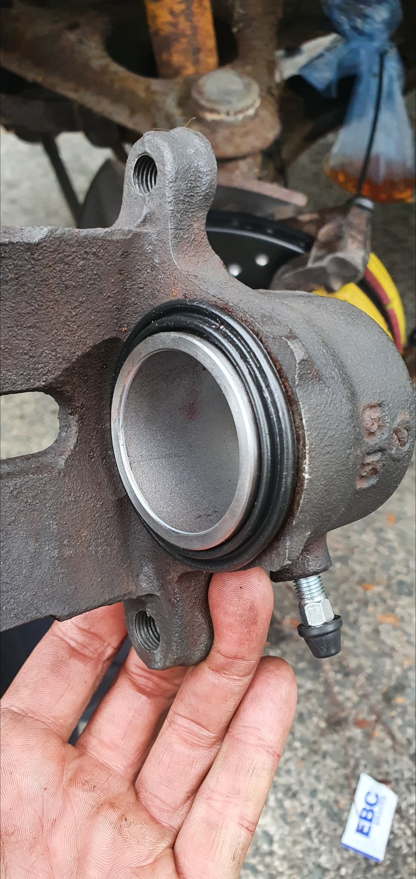

Ebc yellow stuff pads and turbo slotted & drilled discs.
Caliper rebuild kit.
Hel braided lines with high temp brake fluid.

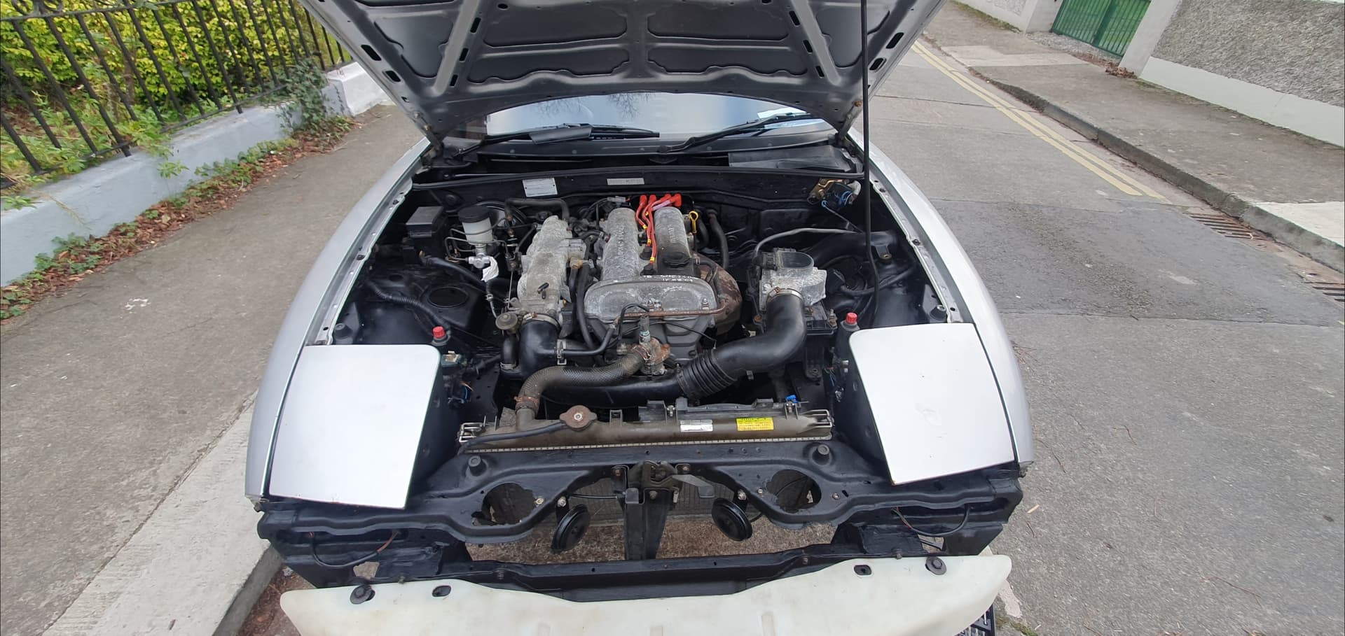

Custom aluminium coolant overflow tank.
Usual service stuff: oil, coolant, fuel filter, drive belt, air filter, HTC leads, spark plugs.

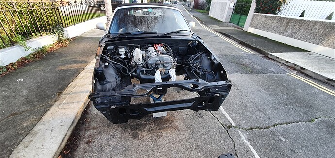

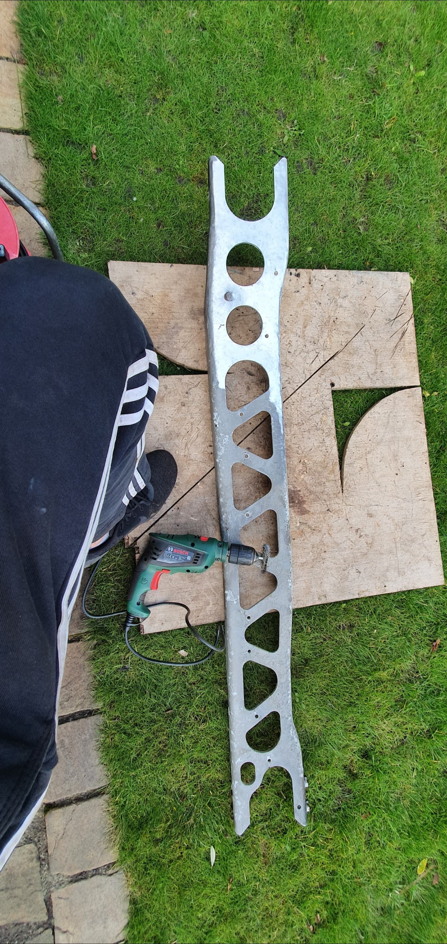

Engine bay: charcoal canister, washer bottle and coolant overflow tank deleted. Clutch and front left hardlines relocated. Mini wire tuck. Left the fuse boxes where they are cause ■■■■ taking a fender off to change a fuse or rewiring everything to the cabin.
