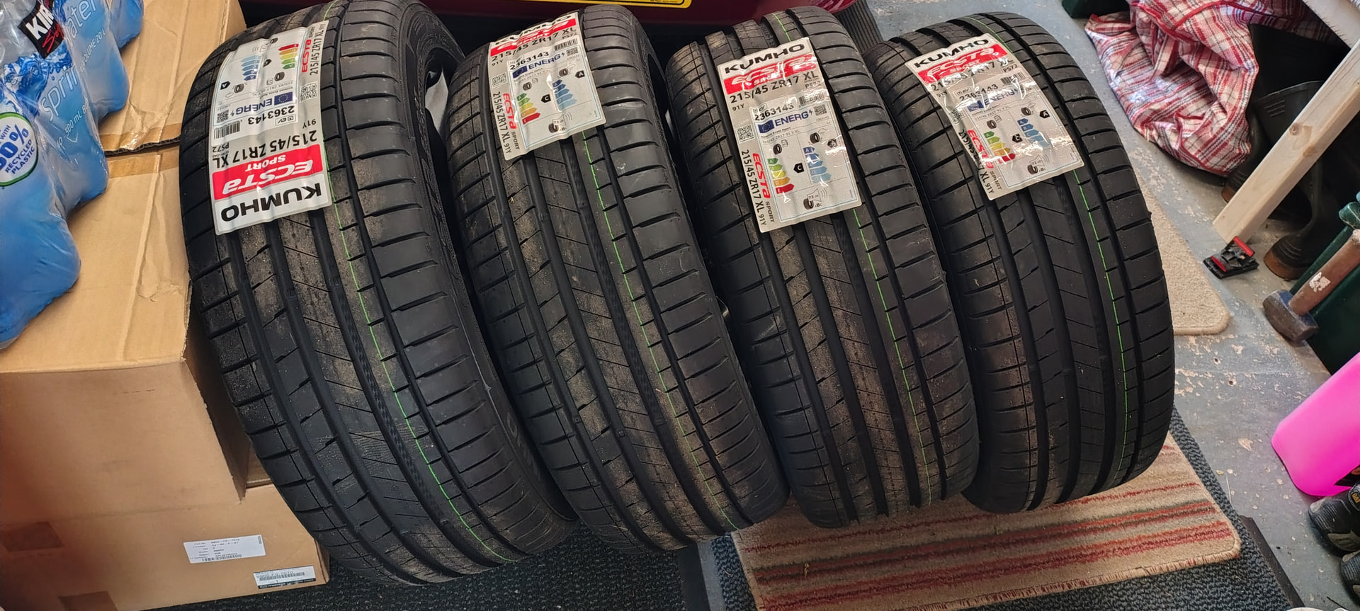

You need some…..
…..if you want to keep it on the road (literally ) all year.:+1:

TR1’s aren’t some supersport semi-slick, they’ll be roughly as good in the cold and dank as those Kumhos, of Goodyears, or Michelins.

(Also a shout out for Uniroyal Rainsport 5 tyres which are a good choice, especially in the drizzly weather we’ve got at the moment.)

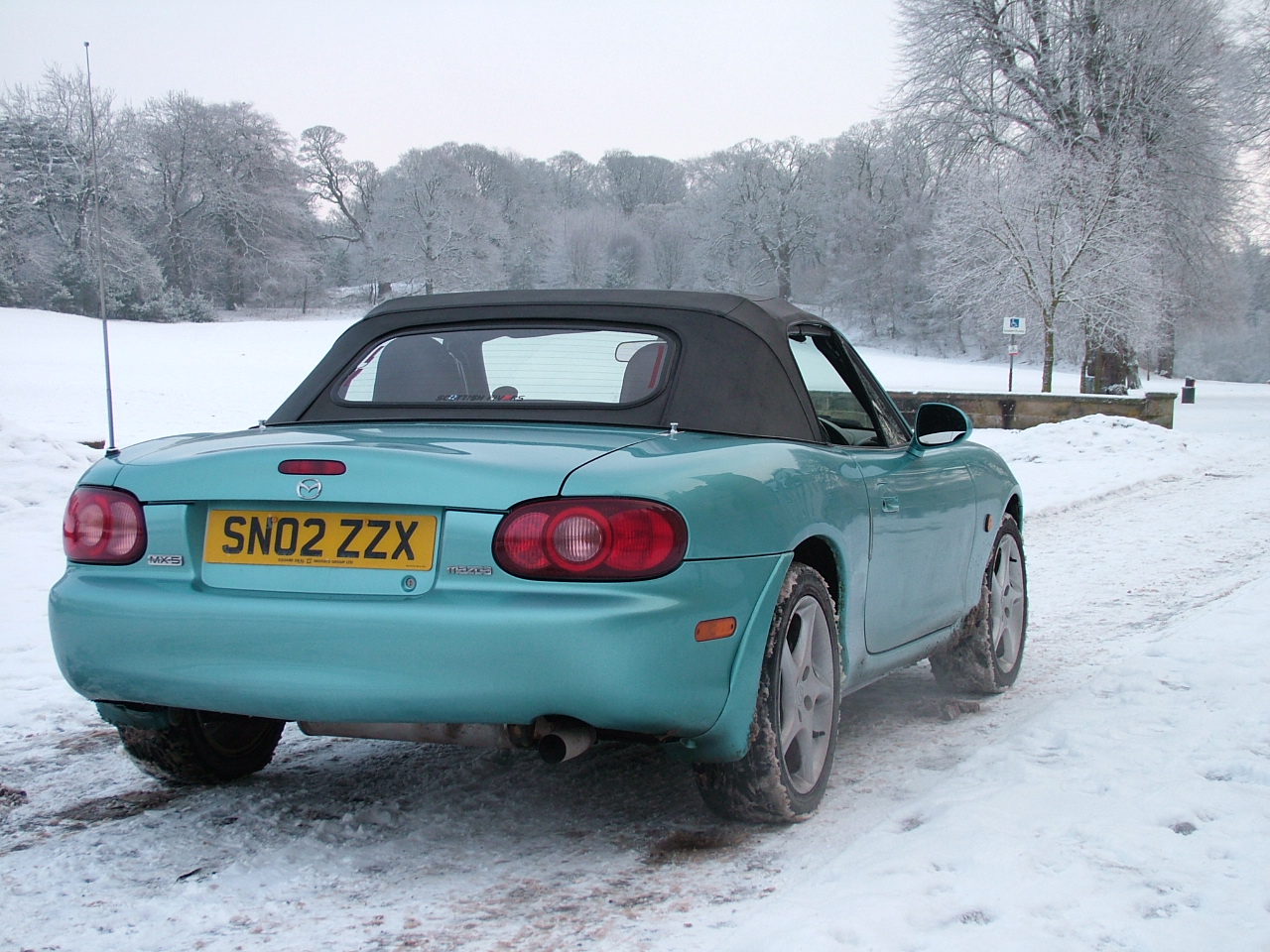

I’ve got Toyo Proxes on my NC and was amazed how good they were when we had a really cold snap and icy roads. My road doesn’t get salted as it’s a side road but the car didn’t slip once, obviously at low speed!

Decent matching rubber as suggested. 25/26 PSI all round, perhaps a lazer alingnment if funds allow.

I drove both mine all seasons for 15 years…but then…Im Old School.
