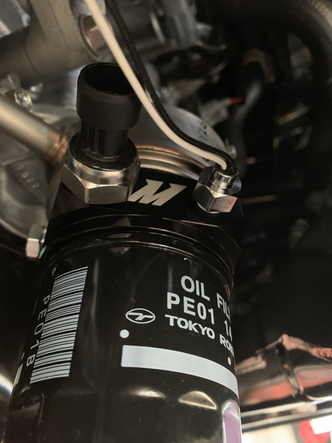

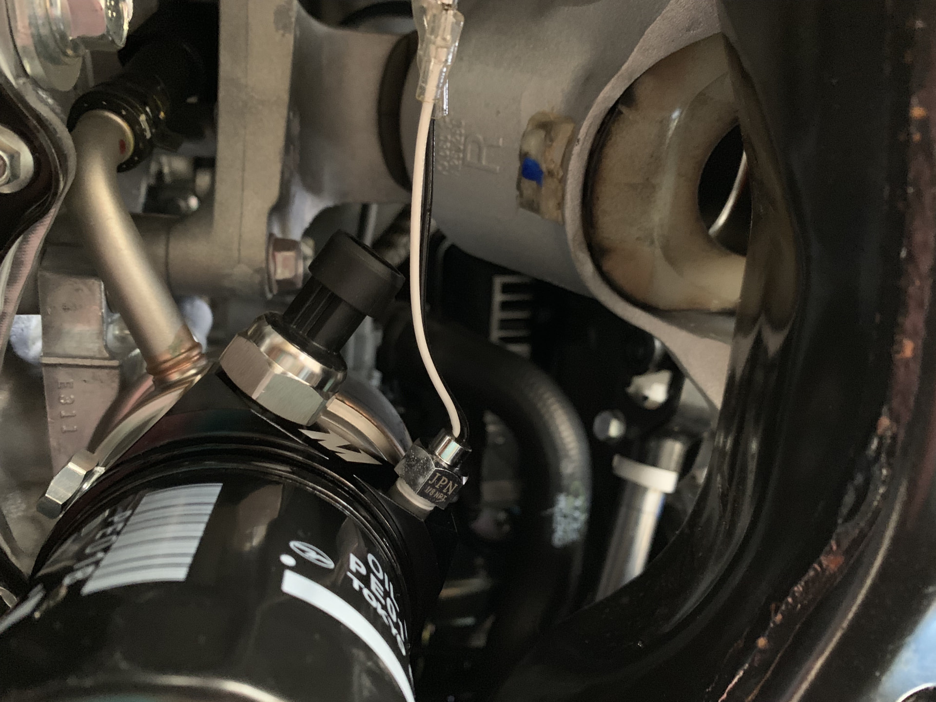

Fitted sandwich plate to My ND and run two gauges from it oil temp oil pressure now for almost 7 years there cannot be much of a gap between what you want to do and what I done ……but I did have to mod mine a little :wink:
