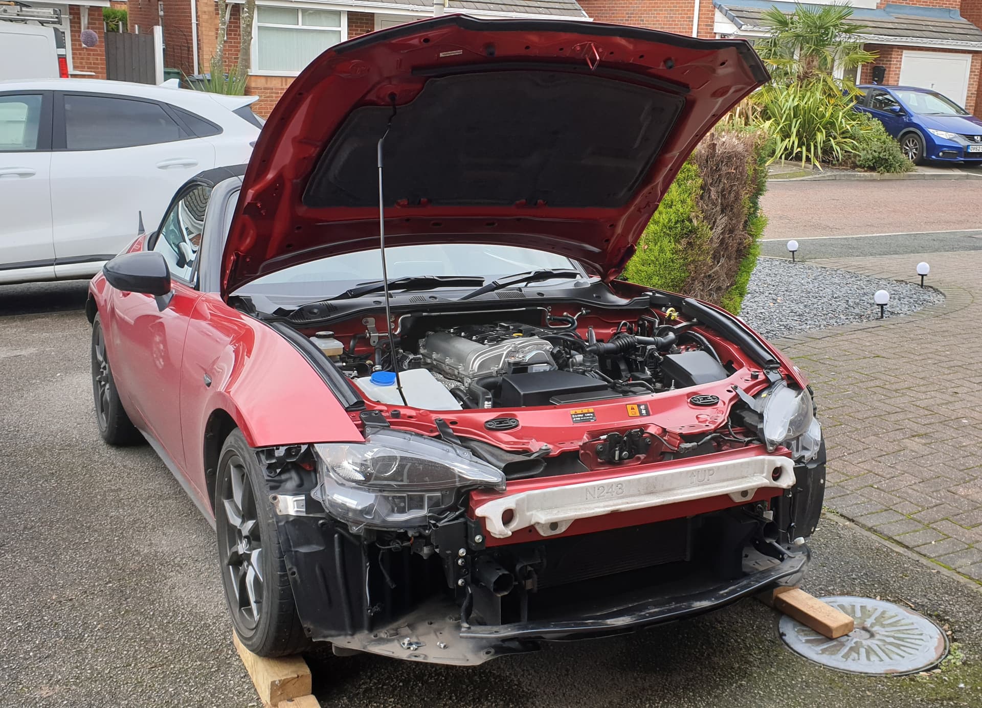

I noted from YouTube there are two methods of fitting by replacing one of the originals.
!) from underneath by prising down the undertray, and
2) from the front by removing the complete bumper.
Well, I could not do method one with my fat hands so resolved to do method 2.

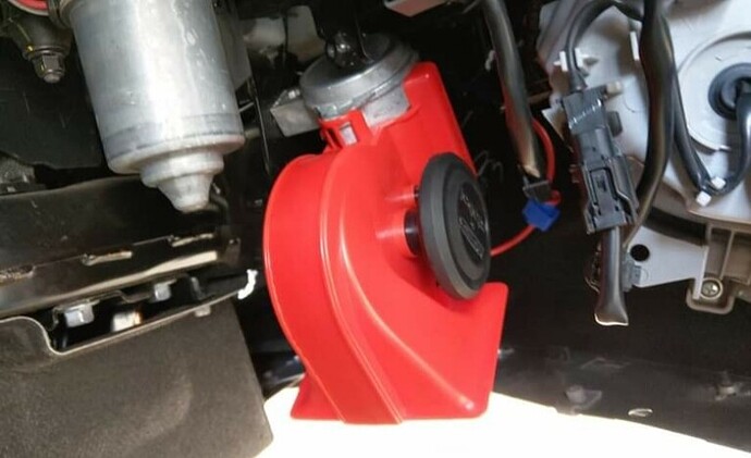

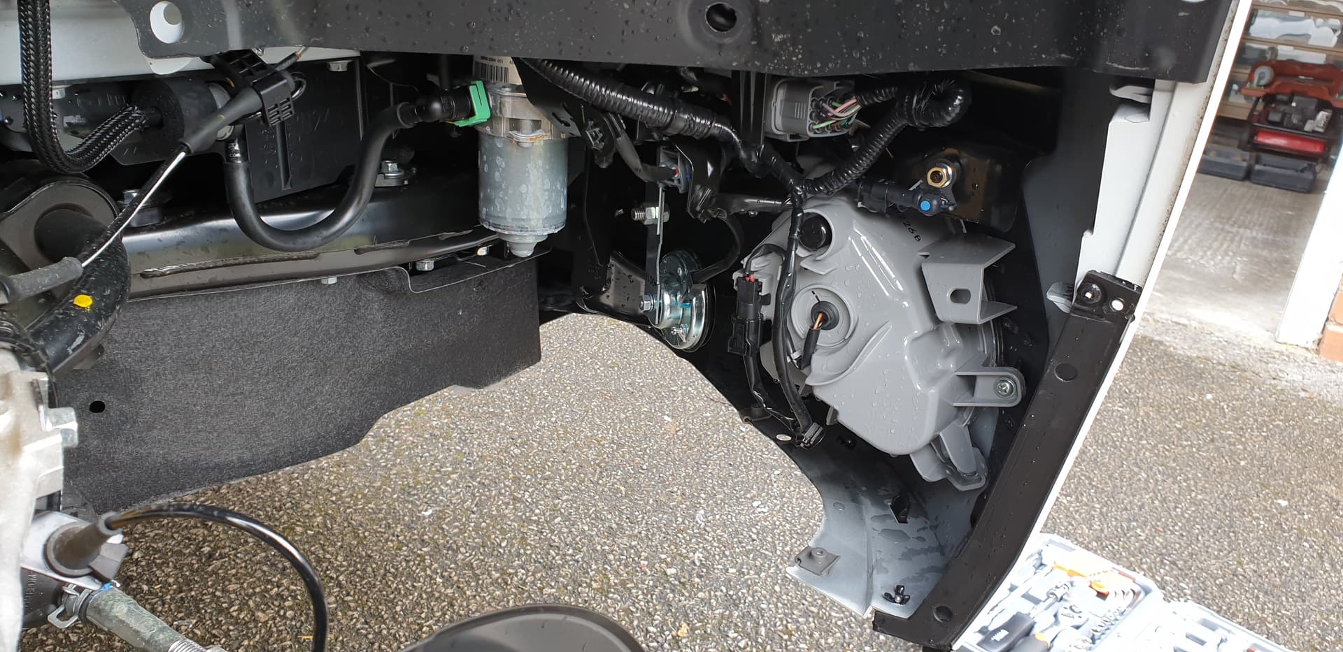

I started with the NS wheel arch liner to get to the top inside bumper bolts but stopped right there.
I realised that right next to the fog lamp assembly there was a big space and there was also a convenient mounting hole.
I made up a simple bracket and fitted the horns easily there using the mounting bolt as the earth.
The live went to the original horn feed which was no problem getting to.

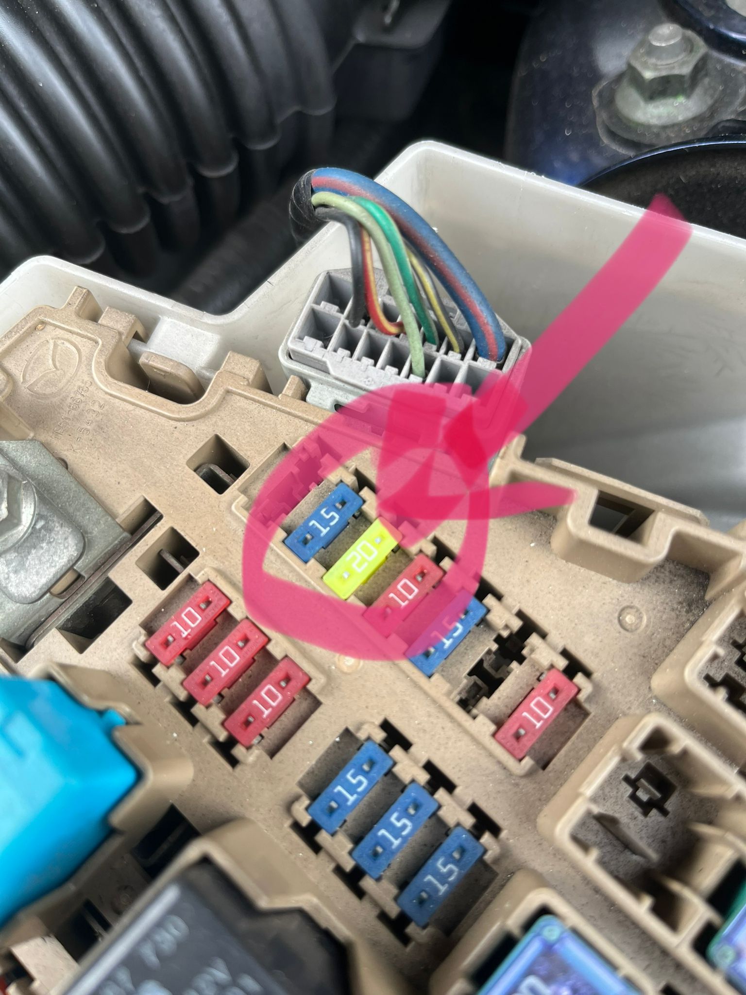

A quick change of Fuse 2 from 10 to 20 amp and it was good to go.
If you fancy a horn change I hope this helps.

Are we confident that the existing wiring will take 20amps?
It is good practice to use a relay directly from the battery for the new horns with an appropriate inline fuse and use the existing feed as the ‘trigger’.

The OE relay is rated at 20 amps so a 20 amp fuse is fine to use the circuit as is.
The new horns take 17 amps.

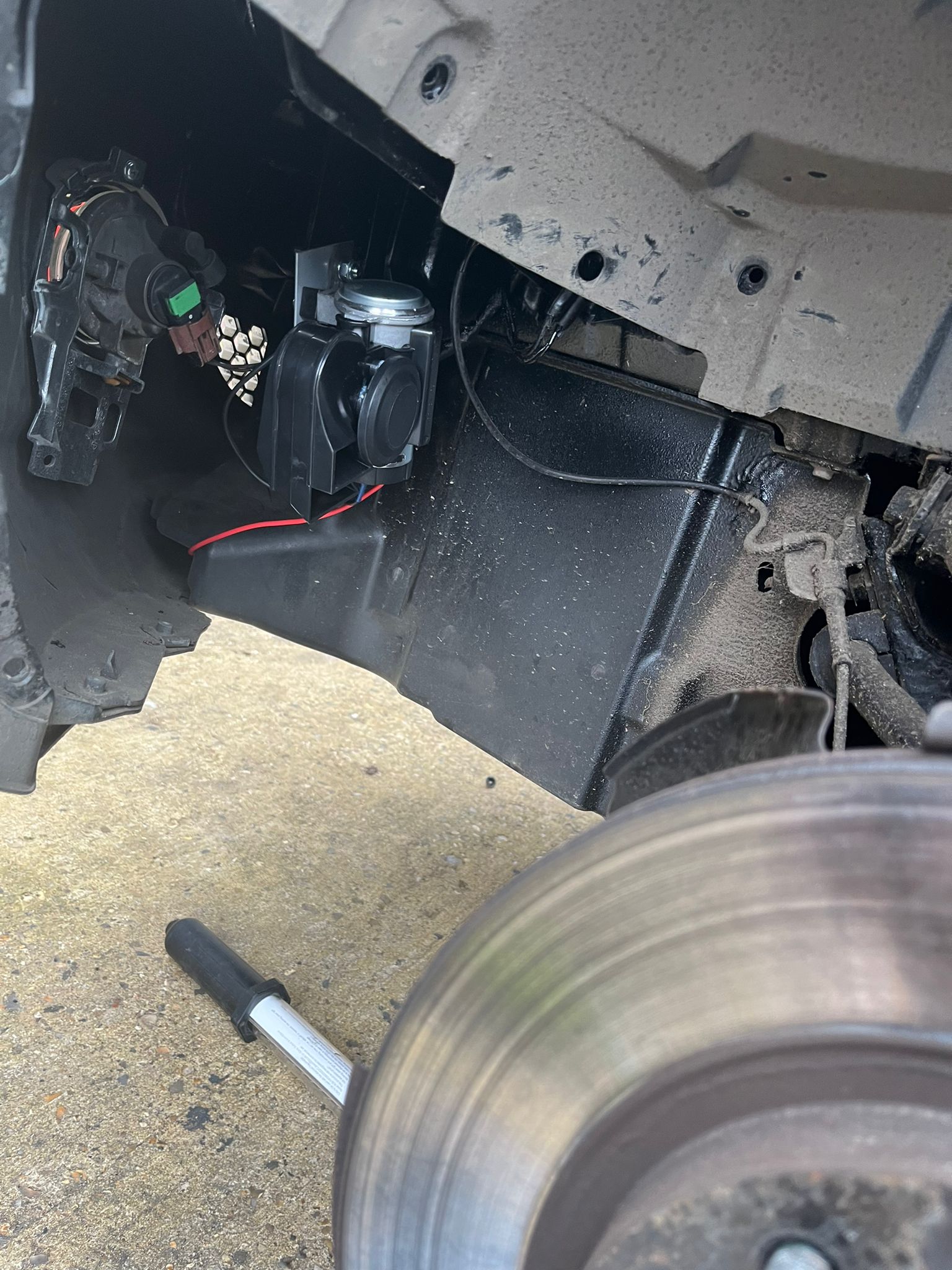

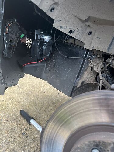

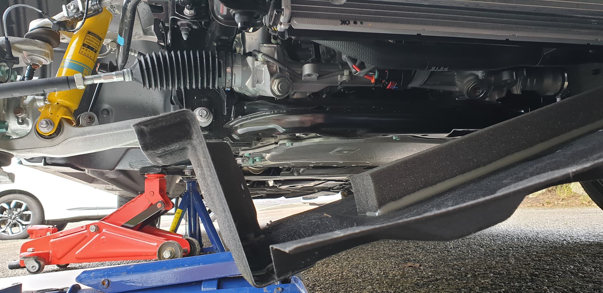

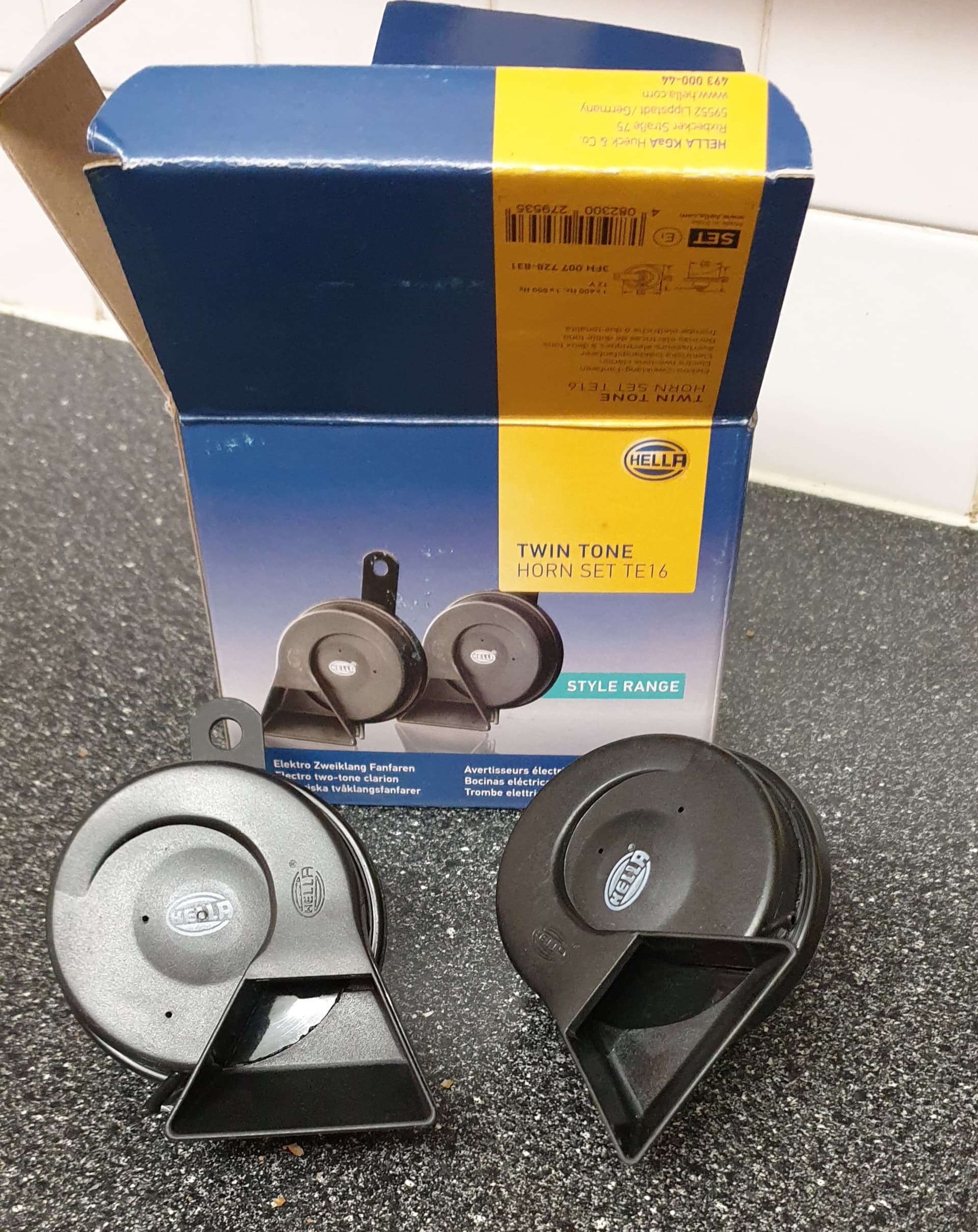

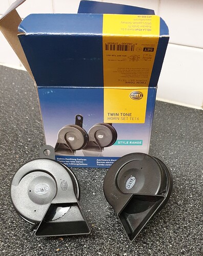

I have changed horns twice. Once on my ND1 and then again on my ND2.
ND1 was front bumper off. Made the job very easy but took three times longer faffing with the bumper.
When I changed them on my ND2 I took the o/s wheel arch lining out and the undertray and worked through the grill. Much, much easier :+1:.
I connect each horn to the original cable and added an earth cable to the fixing bolt.
Job done :+1:.
The horns are much louder but not excessively so. Only used in anger once up to now :rage:.
Mine were Hella’s.
