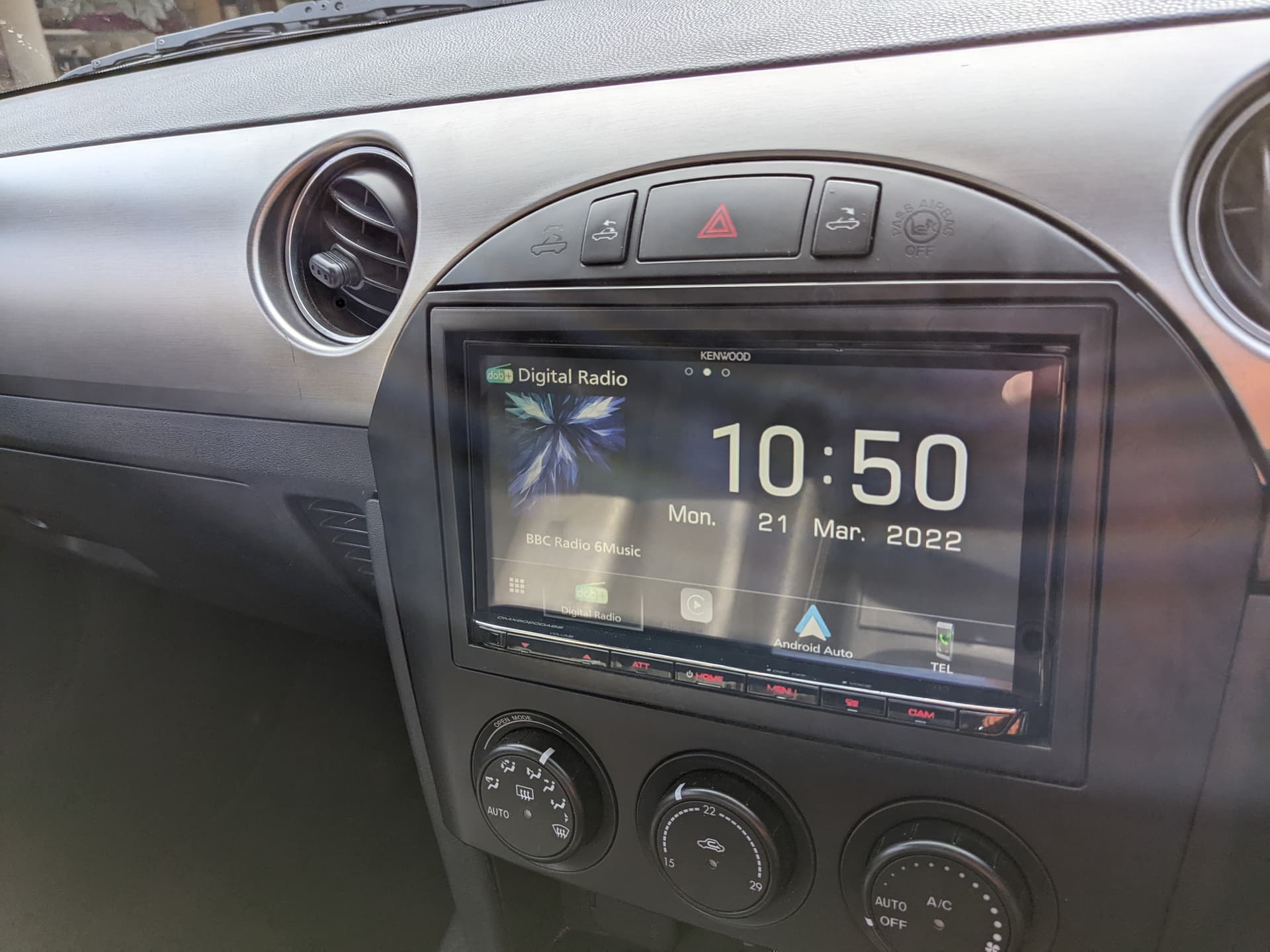

Yeah, all in place now and working :blush:
Going to get it all set up first and fully test before pushing back in place as that seems quite tricky with all those wires so haven’t screwed it into the dash yet.
It’s in :slight_smile:

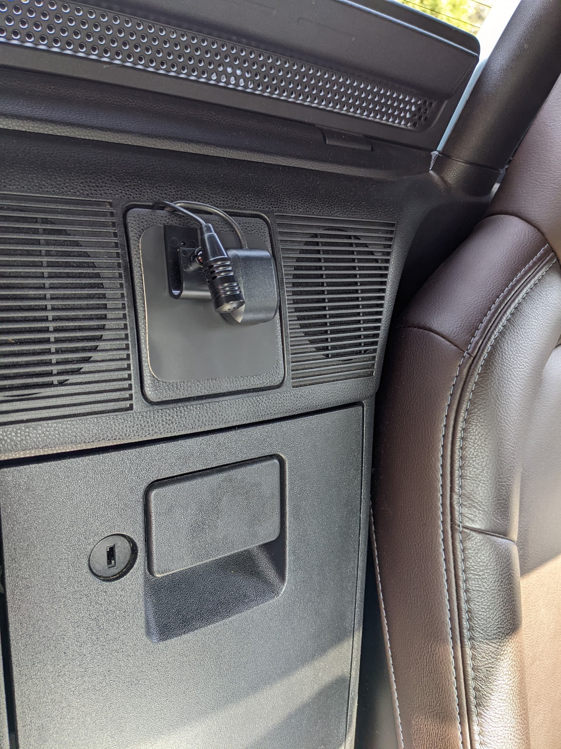

AS you can see from the photos I put the mic and GPS unit behind my shoulder at attached then to the little blanking ‘plate’. No ideal but better than trying to find somewhere around the windscreen where I can see them all the time. This way I naver notice them…haha!
Mine was mounted on top of the unit when I took it out.
Put it on the dash. Modified the blank dash speaker cover.
The Mic (original fit) is on top of the ignition cover.
