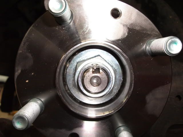

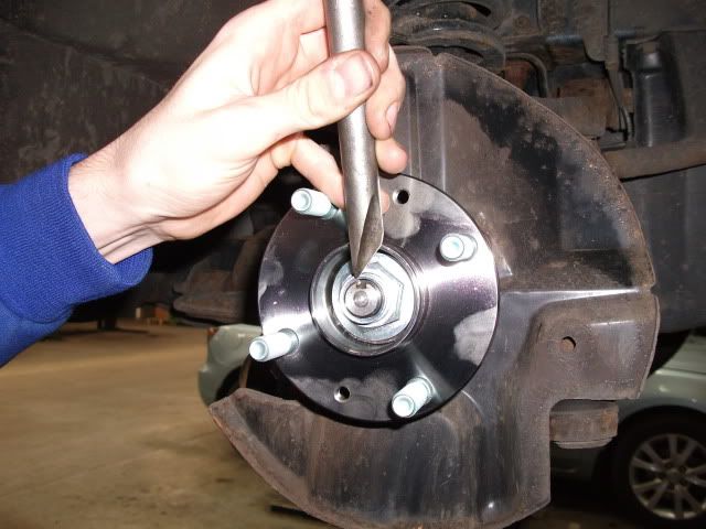

Thanks for very prompt repy.  Forgive my ignorance but I’m not familiar with the term “stake nut”.
It’s a nut that’s secured with a metal tab.
Use a blunt chissel to bend the end of the nut…
…into the groove in the stub axle. It prevents the nut working loose once torqued up.
