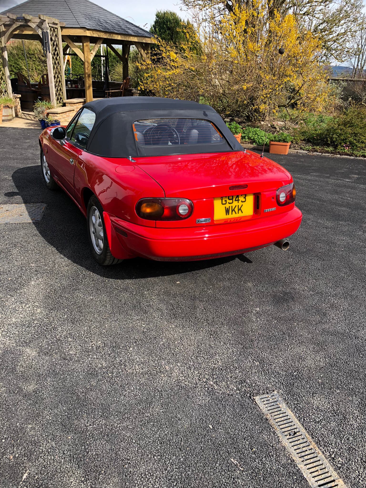

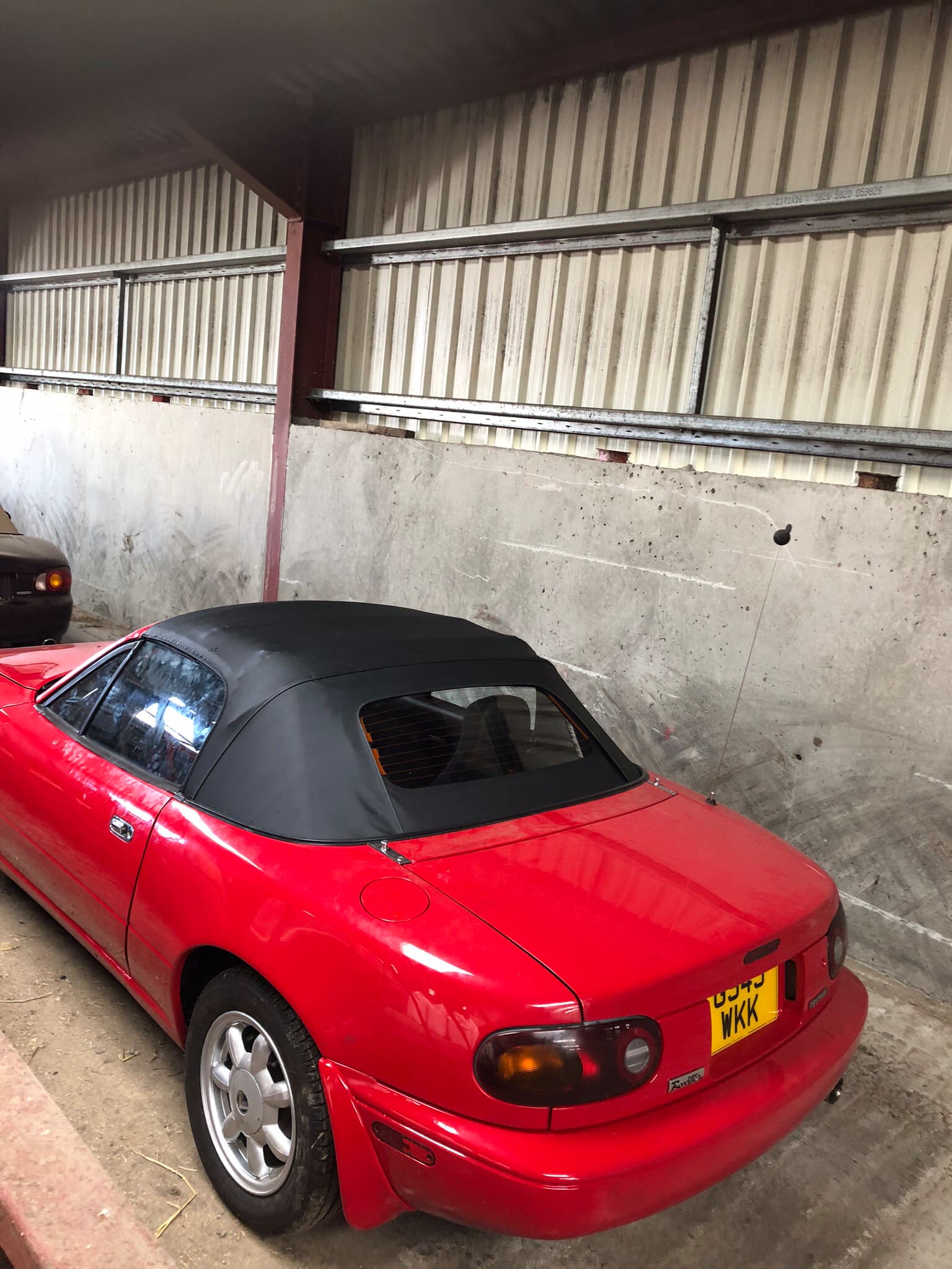

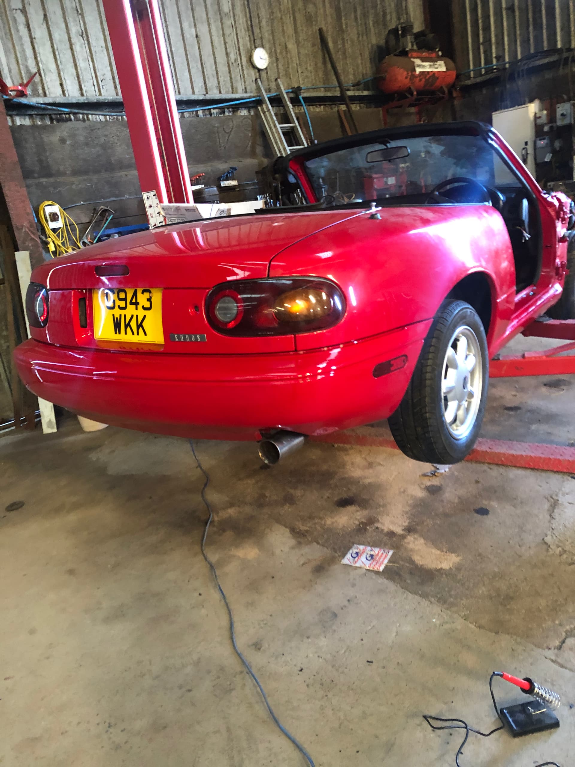

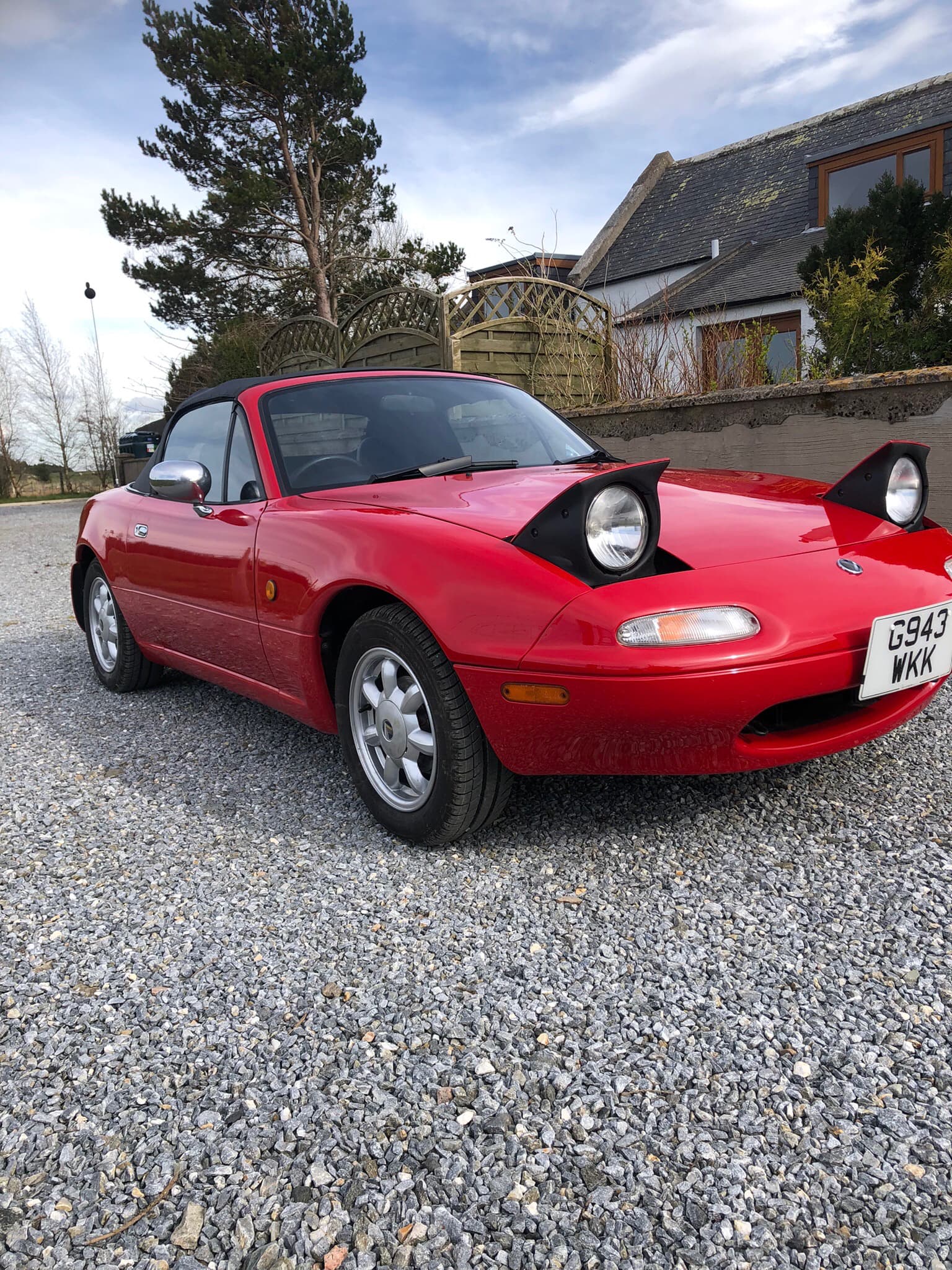

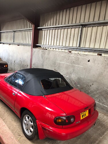

That’s this restoration project finished. But they say you are never finished a restoration on a vehicle!
Can anyone spot the missing parts? They are ordered but on back order from MX5 Parts.
Car is in storage until May so plenty time to apply finishing touches.
I will post further pictures once it I see outside and been given a wash and polish. I have left it covered in the wax overspray from the undersealing.
Not been road tested yet as it has only traveled less than 100 meters! Hopefully it will be ok for its MOT.

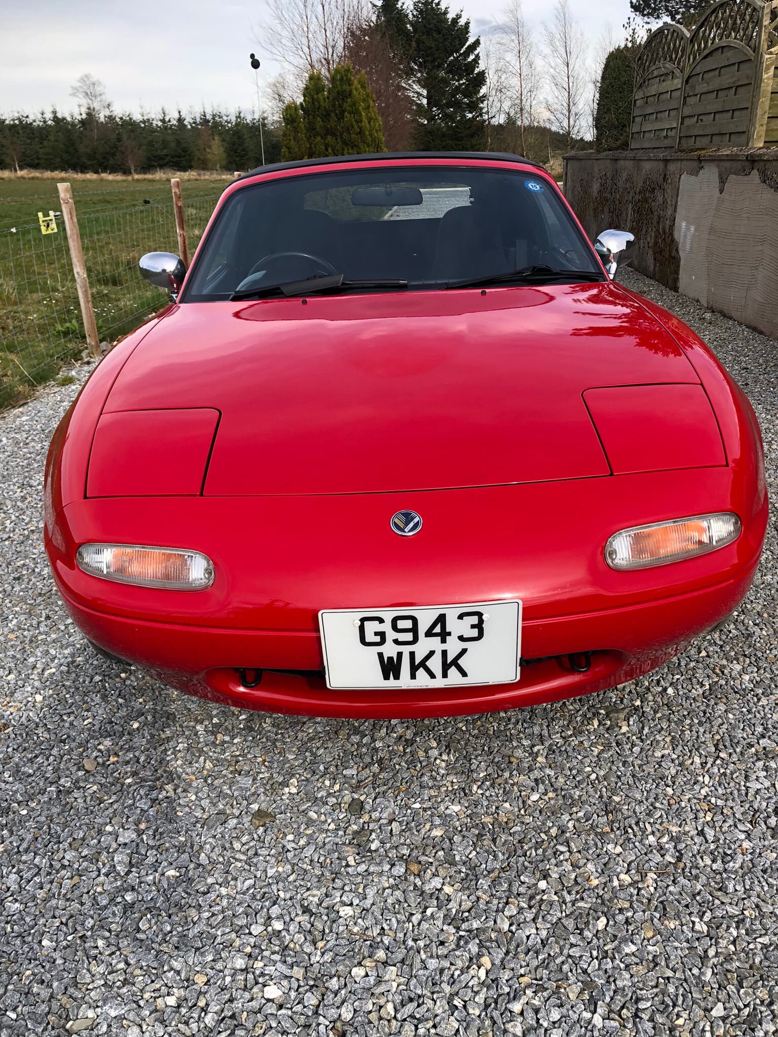

Door mirrors and maybe a rear fog light missing, unless you have converted one of the other lights?
Top of the class MIck! Door mirrors are on back order and I’ve got the brake lights wired onto the fog light switch, can’t understand why anyone would want to add a crappy fog light, and run a wire to it, when a little alteration at the brake switch can solve the problem.
They do it because it’s original, and legal…
Nice car

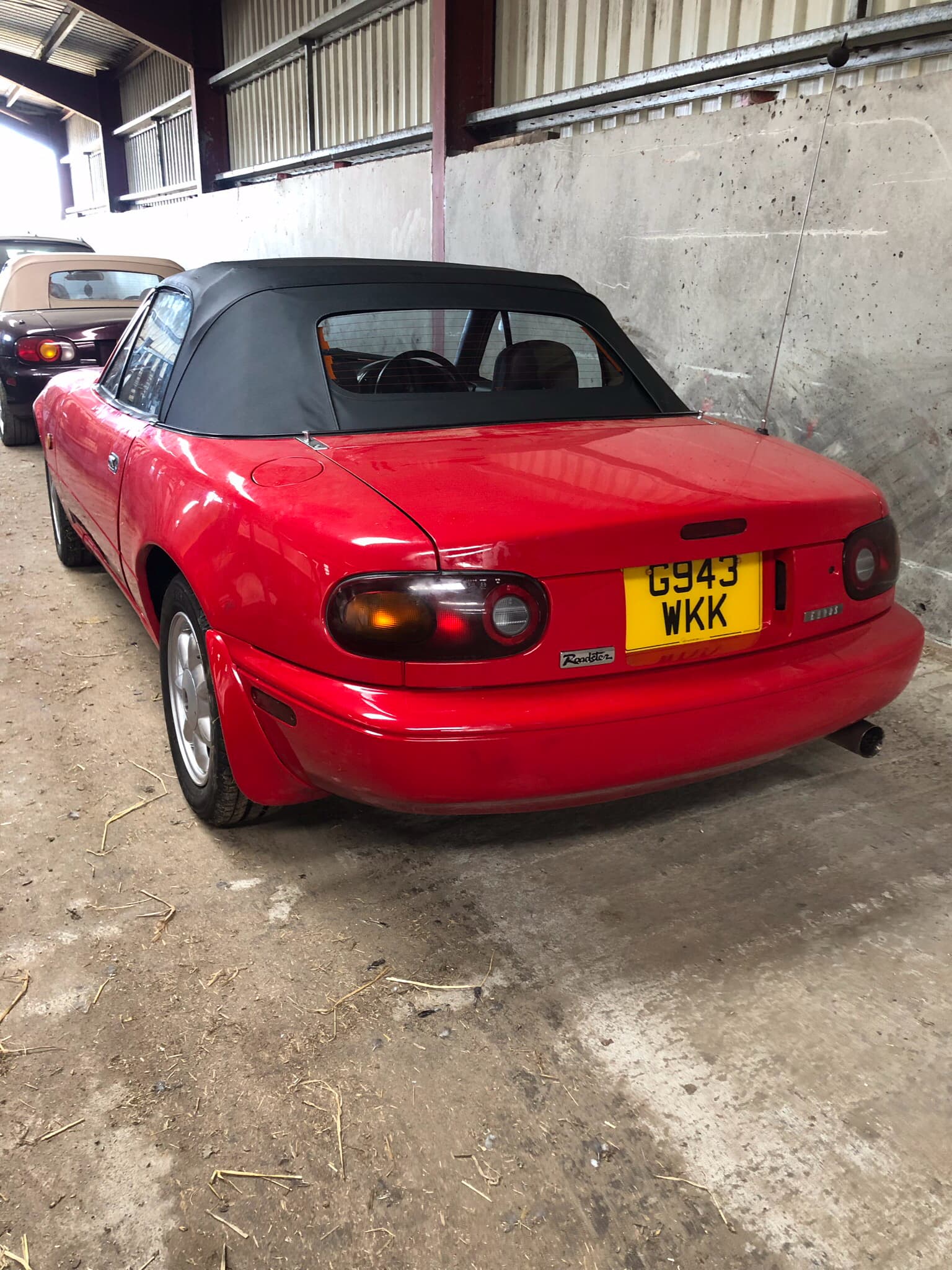

After 7 years off the road this early MX5 had its first tarmac jaunt today for a MOT, passing with no advisories!
Will wait until May before licensing.
Been an enjoyable project, thanks for all the help and support from this group. Cheers
Yay!
Congrats!
