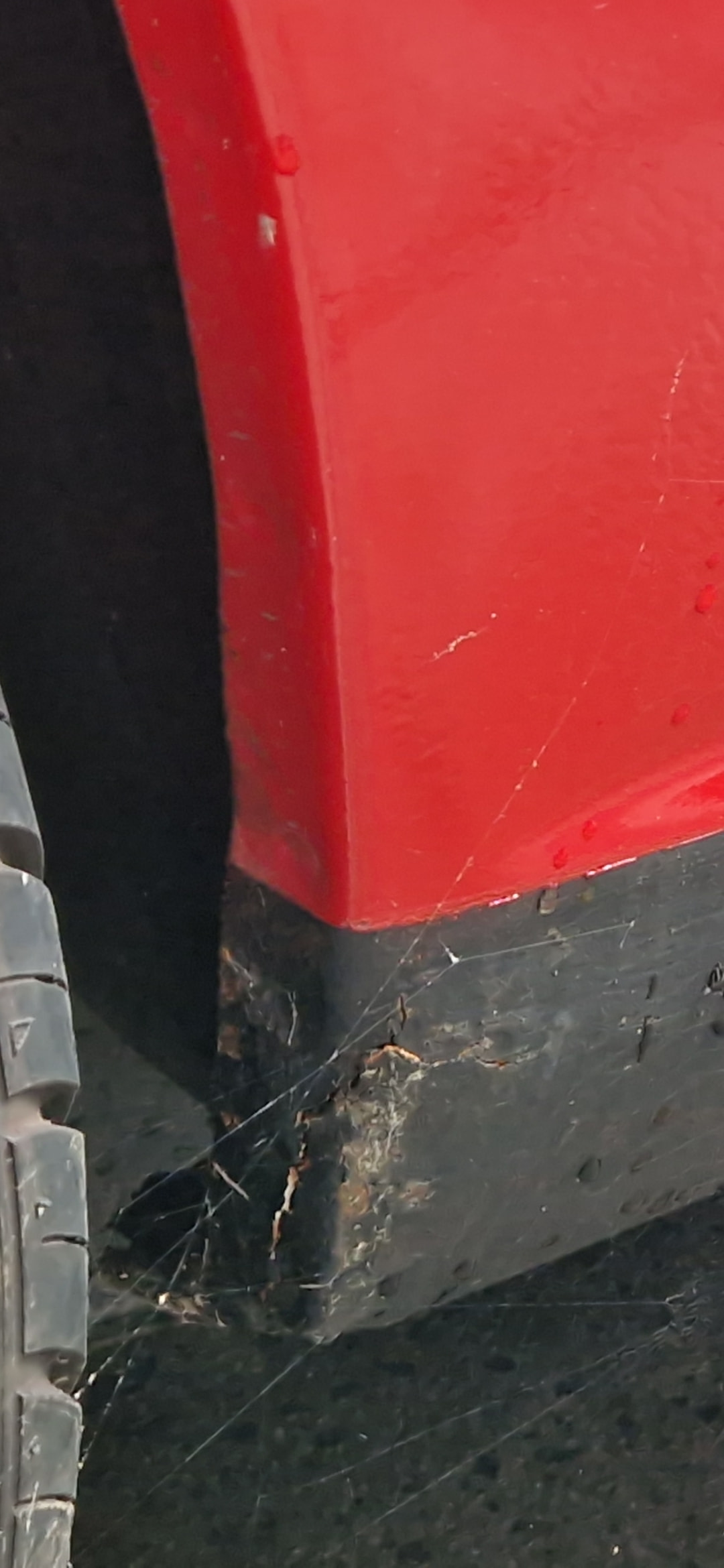

Does anyone have experience with a crack like this in the rear sill? If this will pass an MOT then it’ll be much easier to get it to a specialist for welding. Alternatively I’ll have to drive to a welder who can do the MOT too, to stay within the “only drive to a pre booked MOT” rule. The goal for now cannot be perfection, to spread out costs, but to slowly work towards giving it the next 30 years of life. So I cannot simplify pay a specialist thousands to make it good in one go.
If you think it’ll fail, I’m very open to recommendations of an MOT/repair garage in the North East Wales/North West England area. Especially the Wrexham/Cheshire area.

Suggest you put a magnet on the sill near that crack. If it falls off, grind the underseal off around the crack and find out if you have good metal around the crack. A crack in good metal just there would be unusual and easily repairable, but if the sill has rusted away just ahead of the wheel arch, a known problem area if the hood drain is blocked,and someone has repaired the rust with plastic filler then a crack is quite possible over time, and will probably lead to an MoT failure
I’d put that in for an MOT, and I think it would pass (assuming you can’t poke your finger through the bodywork around it).
Gives you a bit of breathing space to get it fixed properly then (from the look of it, some significant welding will be involved).
