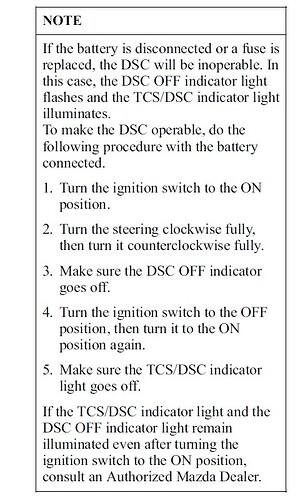

So now my question is, what surprises may the earlier running flat now produce? Might this be equivalent to removing the battery such as radio codes and confused computers?

If your battery is totally flat it may now have a limited life, be prepared to change it. (Now that you’ve charged it, disconnect one side and leave it over night and then take a volt reading.)Yes it is likely that you will need the radio code but only if the radio has been coded in the first place. From memory it’s up to the owner to code the system so that may have not been done.

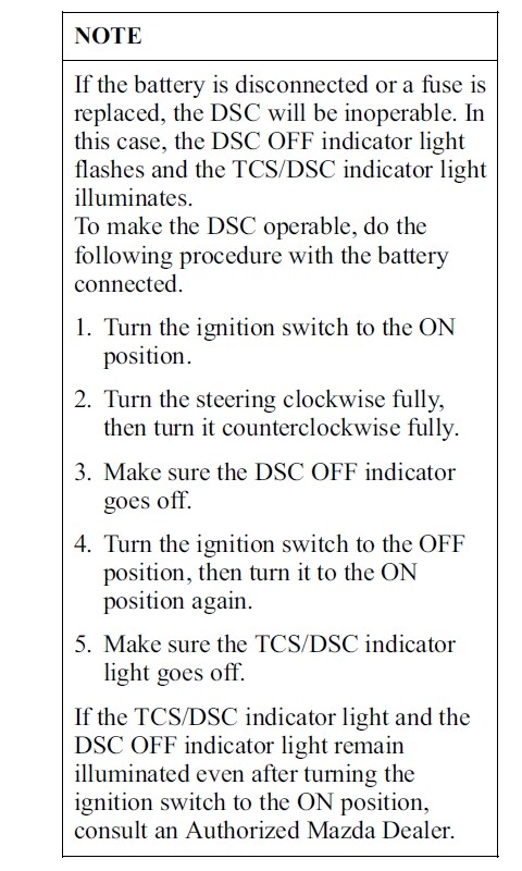

You may have to reset the steering parameters, just turn the steering from lock to lock, if you can drive the car slowly or put a piece of mat or cardboard under the front tyres when doing this, it will avoid tearing at the tyre rubber.
You may also have to let the tick over find its self, this can be done by driving it or let the engine run. Either seems to work.
