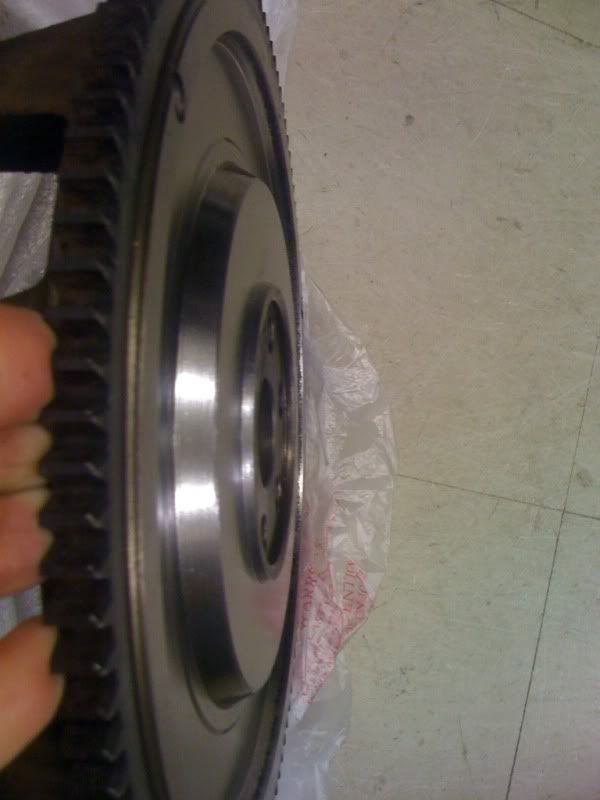

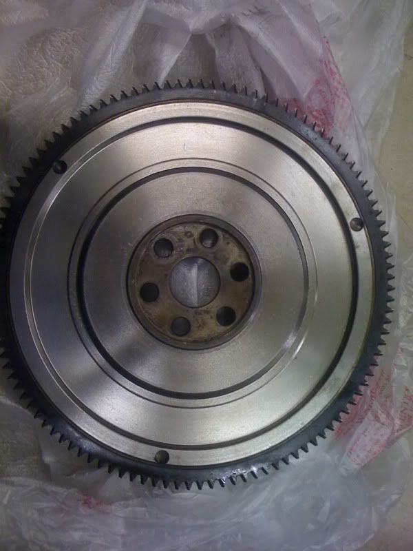

Thought id share this.
I had a 1.8 flywheel given to me when i was chaging my clutch and rear end.
I didnt want to pay silly money for a lightend flywheel, or have one that is stupidly lighter that might cause me idle issues with the SC (Debated subject)
So before skimming, the standard flywheel was 9.1Kg and after some shaving and balancing its now 6.9Kg. I asked the company not to go lower than this figure, they did say that LOADS more can be safley removed from the flywheel if required but that was my personal target. The wieght removed was from around the balance ring so its safe to do so.
Cost was £60 skimmed and balanced.

 The pickup seemed alot quicker, the revs also dropped away quicker too- Think if i had taken any more off i would have needed to adjust the dashpot to prevent stalls but mine is fine Thumbs up
I had the work done at www.apiengines.com (where i had my engine rebuilt).

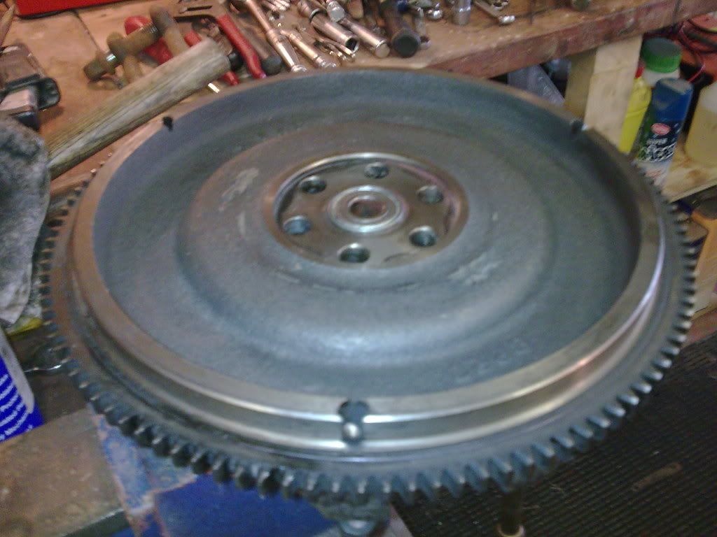

 managed to find a pic of a flywheel i weighed a while ago
it came it at 1 stone , so 14lbs. It was an rs-ltd mk1 flywheel
