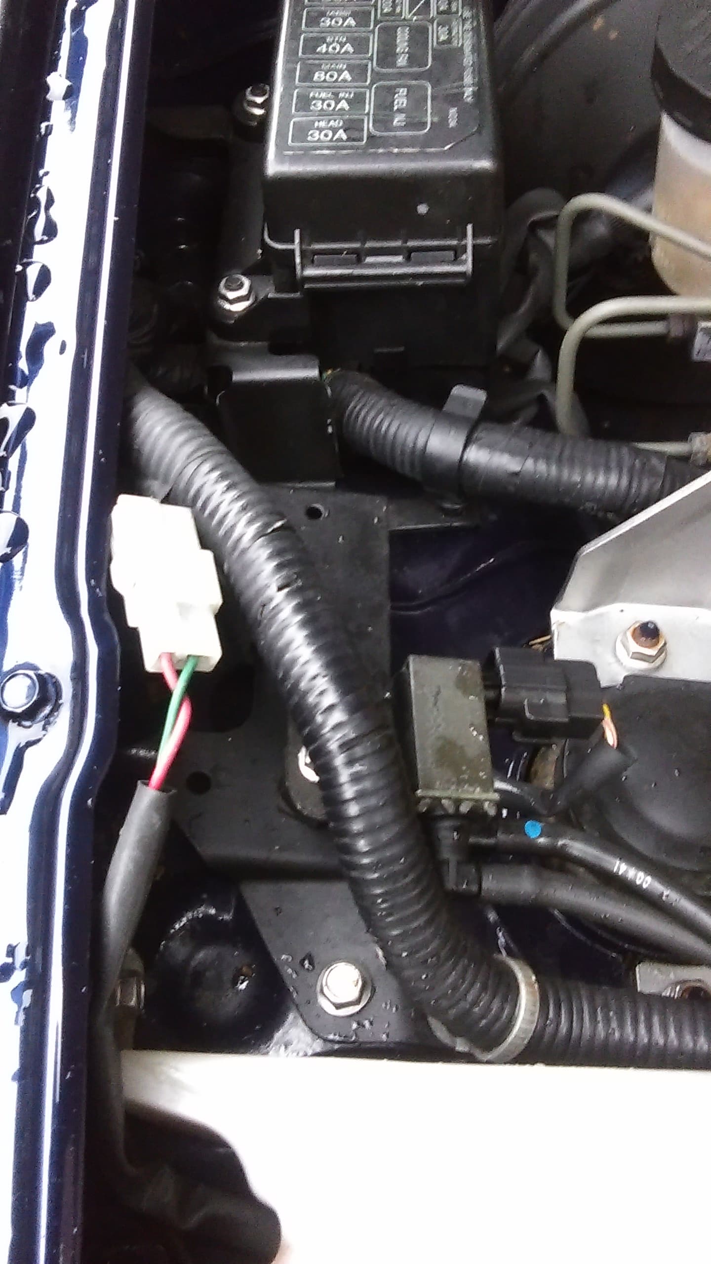

seeking assistance from those here who are au fait with the issue mentioned, i think i have come across a connection plug point on the n/s inner guard in area where the ECU connection plug is sited just behind the headlamp…is this a place where i could begin to plug in a separate relayed loom to power up either 2 fogs or 2 driving lamps . leds by the way,less current draw…
As far as I remember the plug you have found is just a 12v supply for an inspection lamp etc.
The plug you need for front lamps is on the o/s or drivers inner wing but not all cars have it.
Mine has this loom and it terminates behind the switches on the right of the steering wheel with a socket that fits the dual f/lamps & HRW switch.
The lamps have a dedicated relay & loom but again they are difficult to find.
The plug looks like this.
I guess you could make one up if you are able, either way good luck.

Nope, it is under the bonnet the fuse box that you can see is the main one next to the brake servo.
From what I understand not all 5s have this connector just the JDM models.
