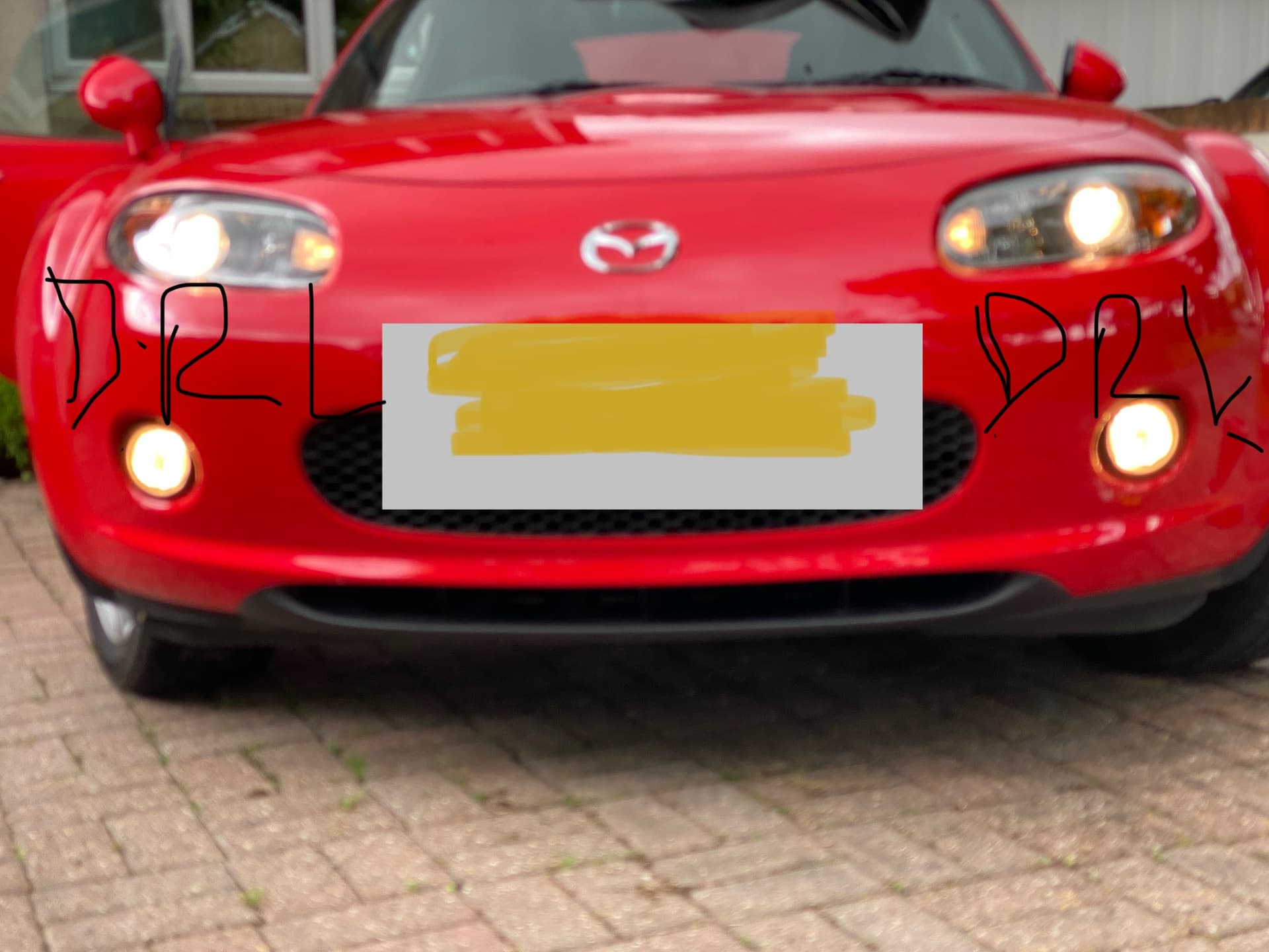

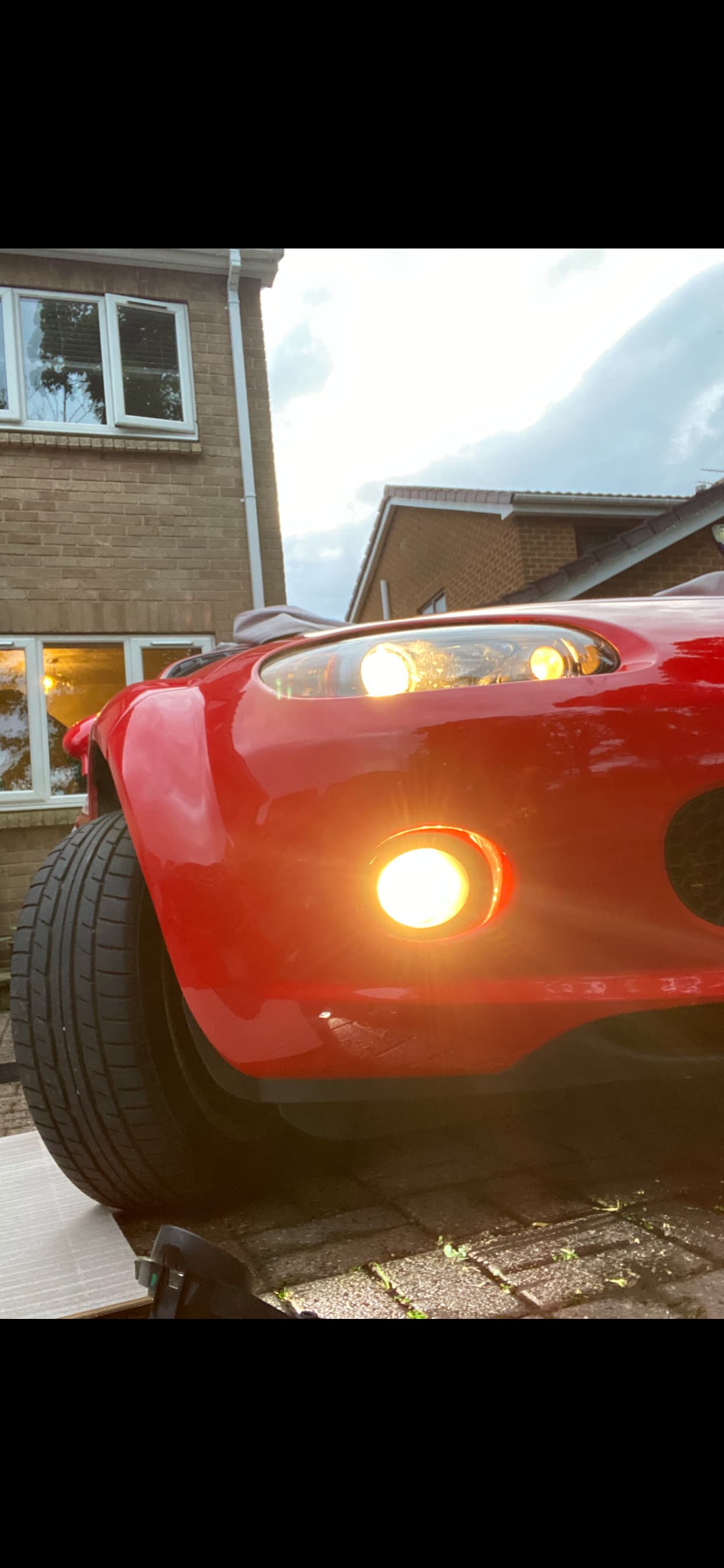

Managed to find time to fit the replacement light stalk and one fog light this evening, best of all it actually works.
Strangely satisfying isn’t it when it all works.
