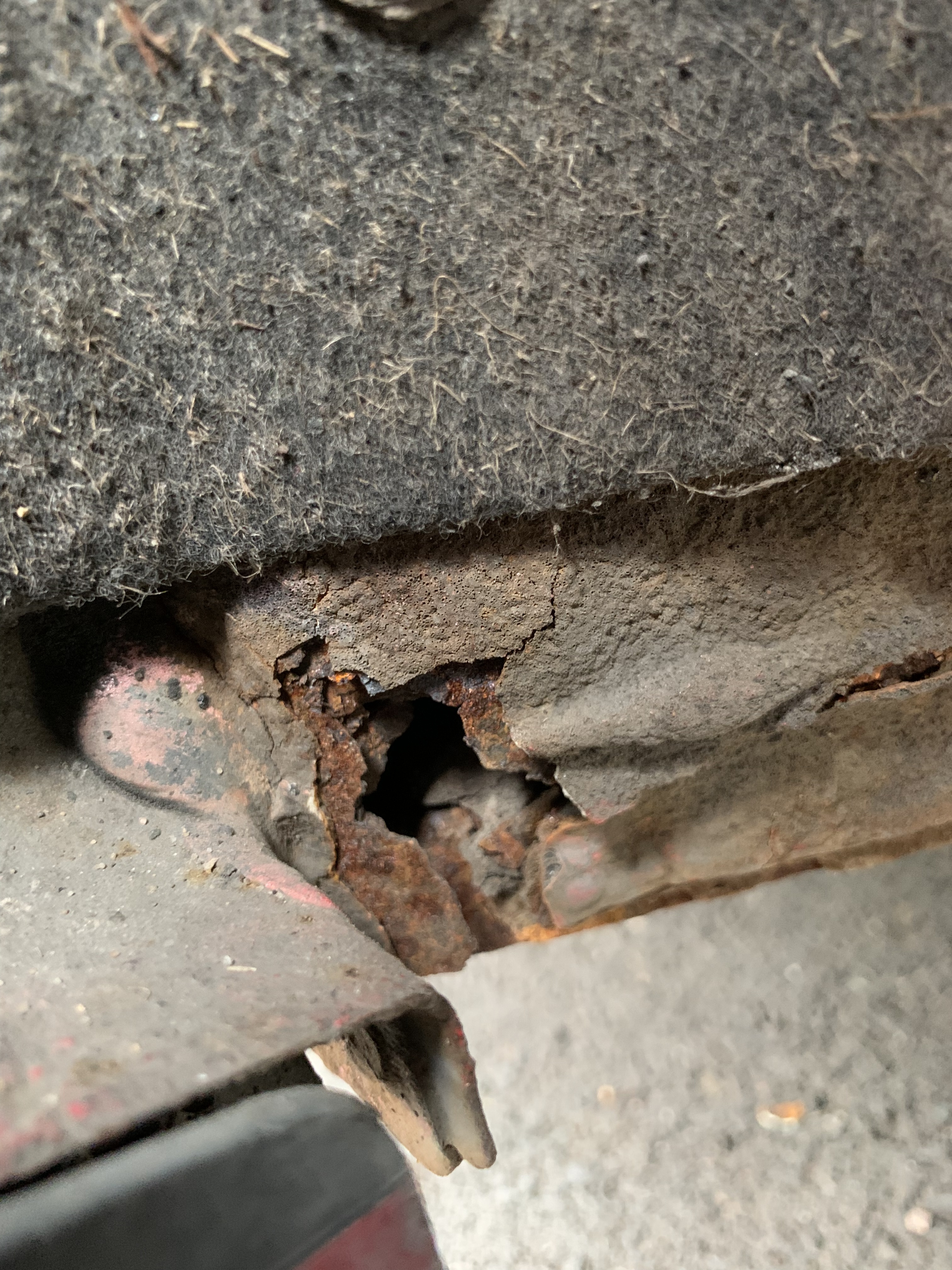

This is what I’ve got at the moment.
It does feel quite brittle around it and I reckon it could easily be made in to a fist sized hole… checked drivers side and that is still solid…

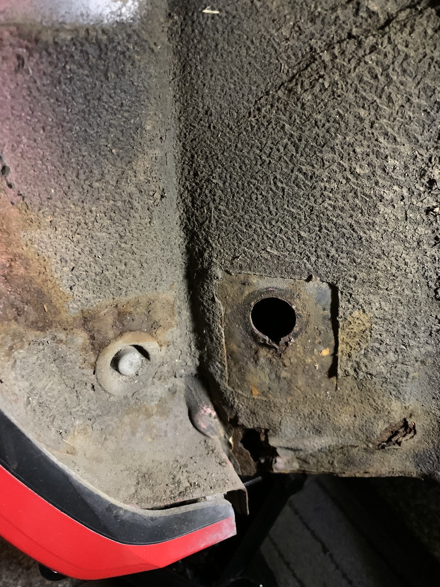

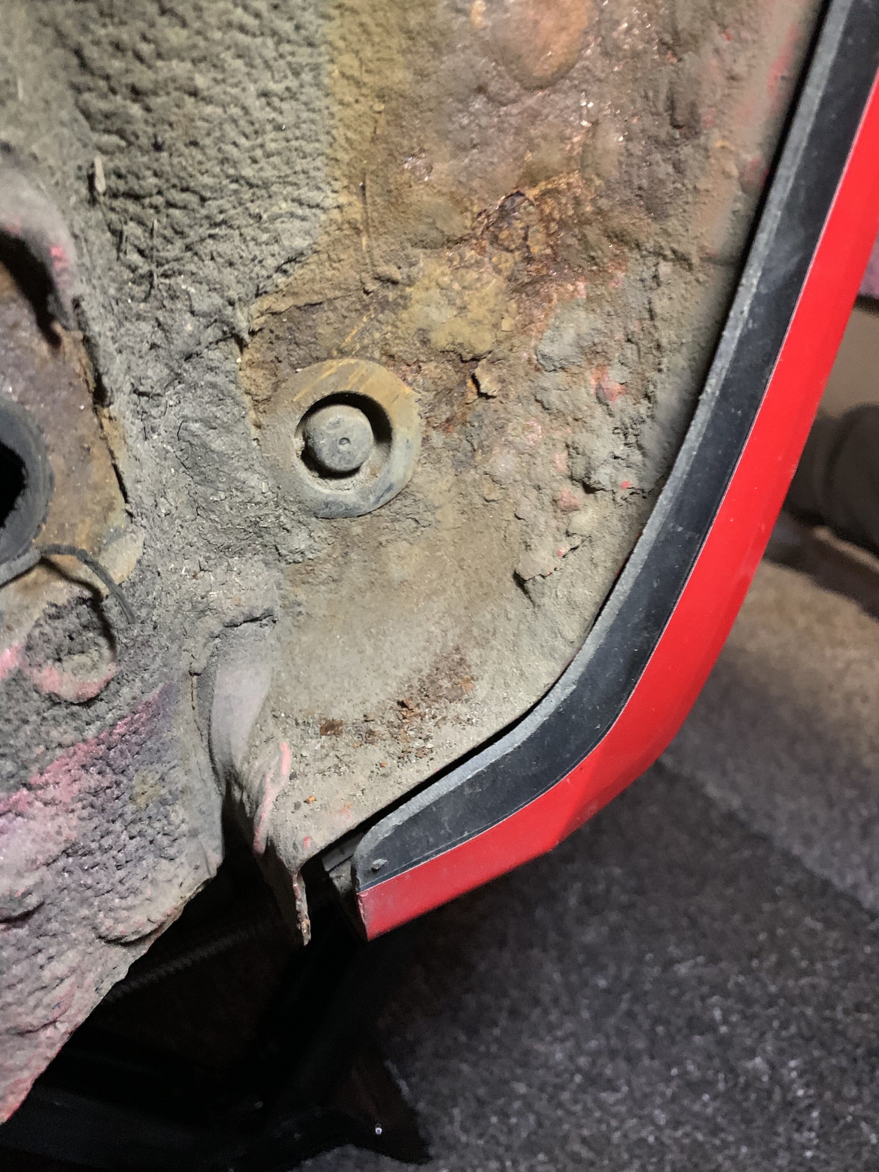

Have a look behind that arch liner you’ll find a plastic insert, the rust can start there too and spread. The visible (usually rusty) screw that passes through the arch liner goes into that plastic insert.
Also look behind that rusty panel from under the car, all the muck from the wheel gets thrown up to there and rust creeps behind that bit, second picture down. First picture down is mine recently undersealed, I’ve treated the rusty parts too.

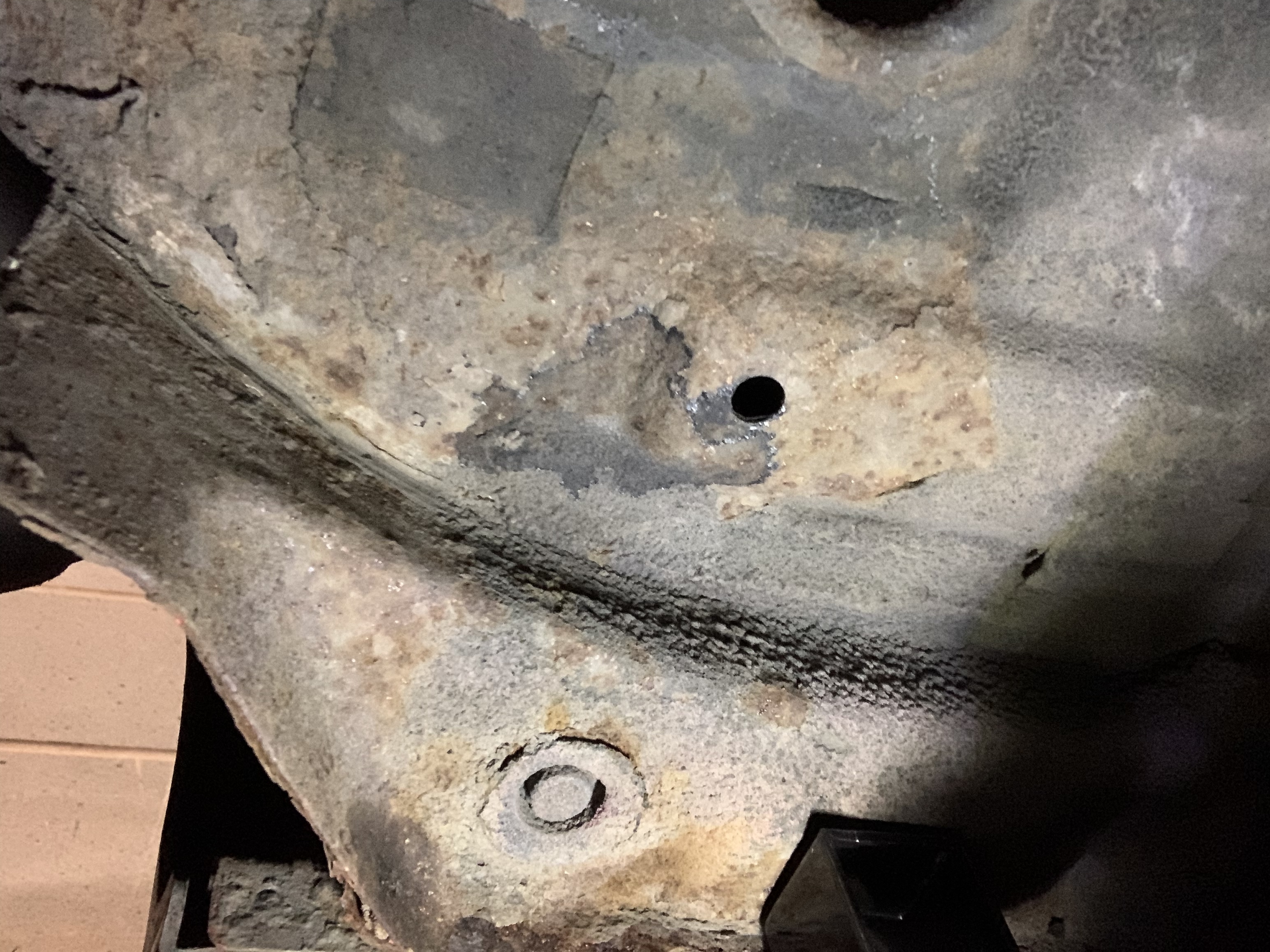

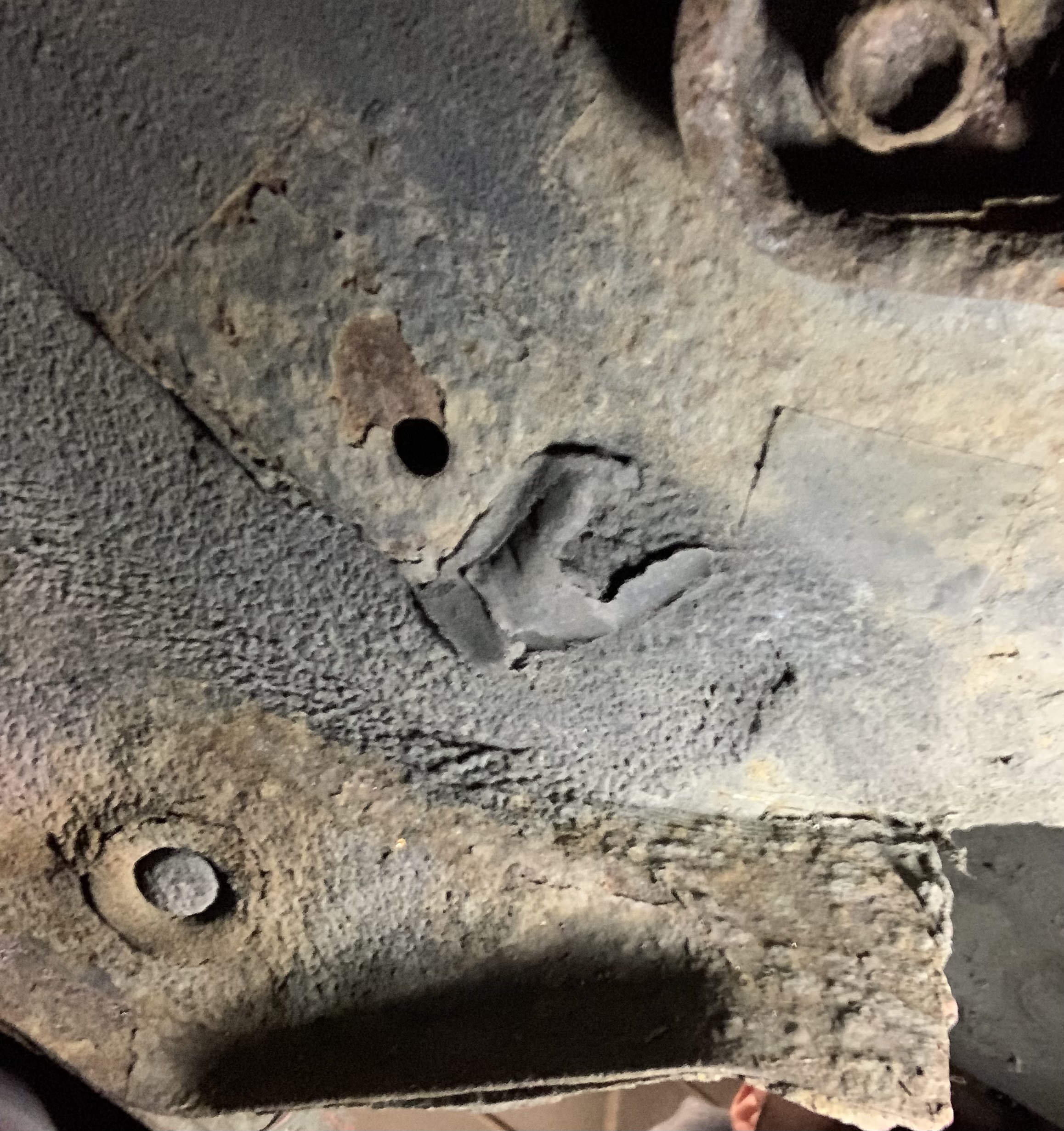

Just had a look at the drivers side and it looks alright to my eyes for a 12 year old car. Looks to be just surface rust and if all feels solid enough and stood up to a good poke with a screwdriver…(pic 1) underside of the sill end, looking back towards the wheel arch looks in good condition too, but again I’m no expert…(pic 2)

Just has rear passenger wheel off for a better look. Reckon an area 6cm x 6cm is completely gone, from the hole down really, just held together by the underseal…
Everywhere else looks alright even the underside… but I’m preparing myself for them finding something else once it’s up on a loft and they start digging around… fingers crossed everywhere else is just surface crud….
