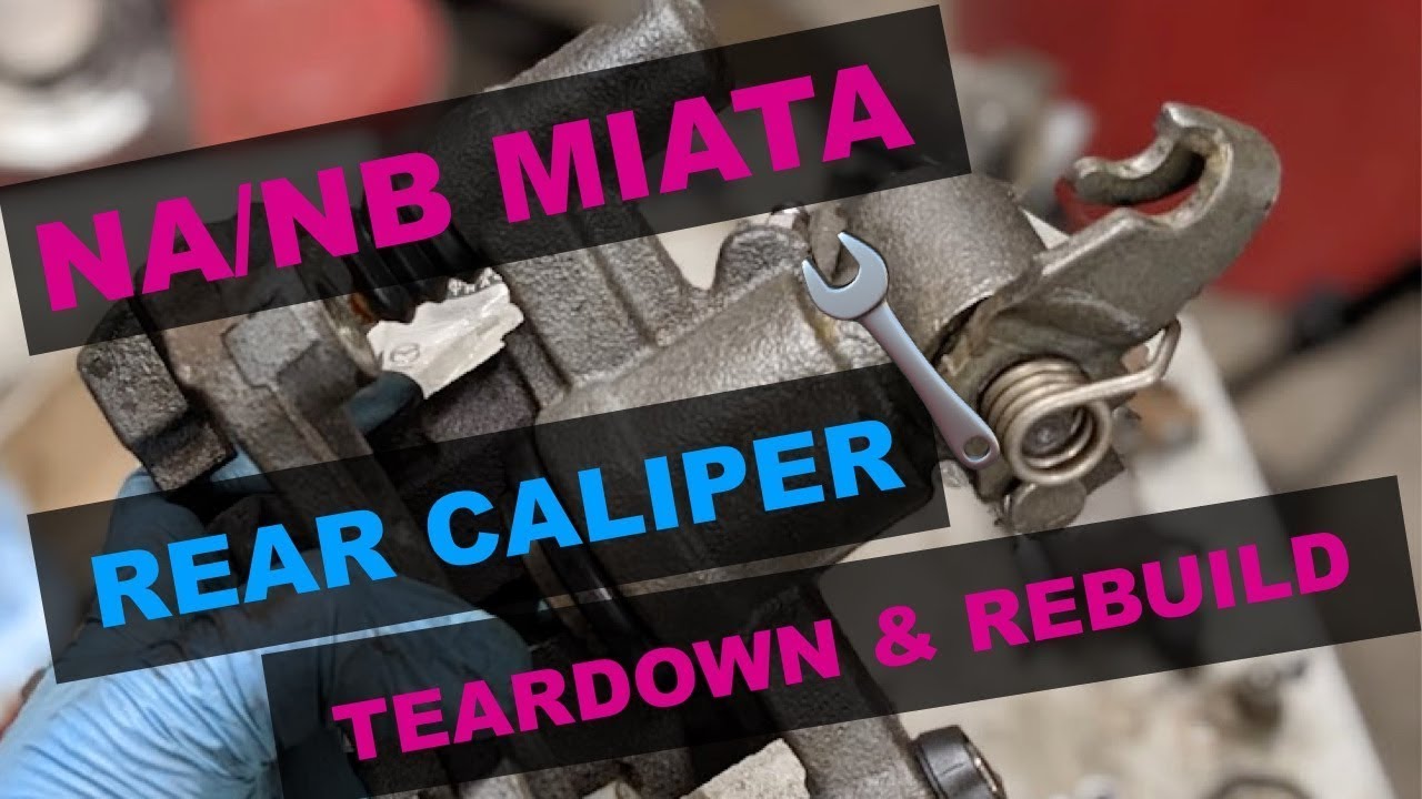

Hi, Just wondering how difficult it is to disassemble the rear calipers on my NB1, particulary the return springs?
Is there a sequence to follow??
Many Thanks

Sorry - never done NB calipers to be able to advise.
Not mine but does this help ?
Thanks alot- very useful.
