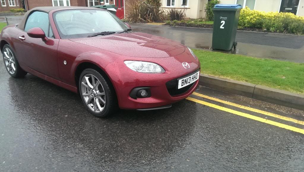

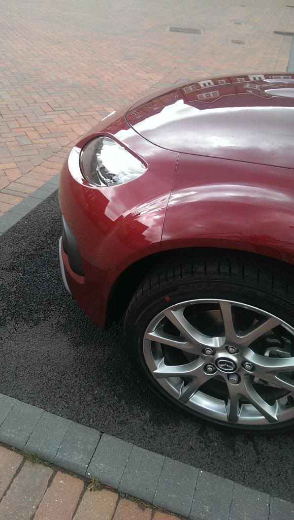

Picked up my new wheels a month ago and whilst I love it, my bumper really doesn’t match the front wings.  A quick scout around the forecourt seems to tell me that the MX5 front bumpers (the rears seem to be ok) seem to be either a bit of a different shade or a different shade altogether!
Mazda, as of last week, are following the line that there are variations in shade due to the way the light falls. but moreover due to the difference in materials.
Just wondered if people had had experience of this/dealings with Mazda Customer Services on it…?  I’ve put a couple of pics below which don’t quite do the real thing justice I dont think!  I’m not too impressed that from near or far, rain or shine, the bumper looks like a photoshop effort! Ha ha…

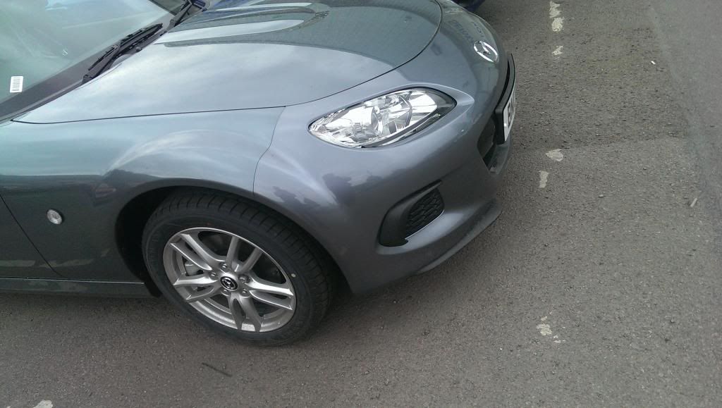

And just to illustrate the point, another 13 reg waiting to be prep’d at the dealers… Glad this one wasn’t mine…
 galaxy grey shows up the discrepancy as well… something to do with the difference in materials from metal to plastic. apparently!

There are a number of potential options one way I would start though it definitely definitely find someone with a paint thickness gauge (PTG) maybe a professional detailer and measure the bumpers paint thickness if possible against some of the other parts other car in case it has been sprayed or seen any attention (it is well known that cars do receive some after factory treatment sometimes without the owners ever being told).
From there depending on the results might make it easier to say respray or even at worst rejection should it come to that. In my view NO new car should be needing a bumper respraying if it has had no accident damage or reason to, but as I say before this is not the only car I have heard this about (main offender I have seen next time you are out look at the new Jaguar XJ front bumpers closely early 100% of them are of an incorrect shade).

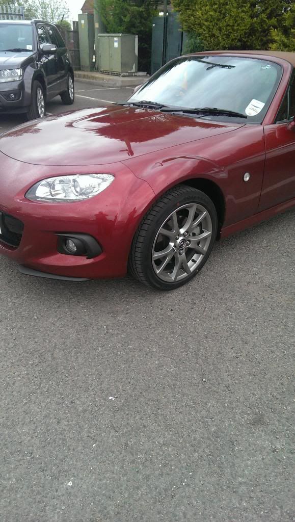

My 3.5 for comparison:
