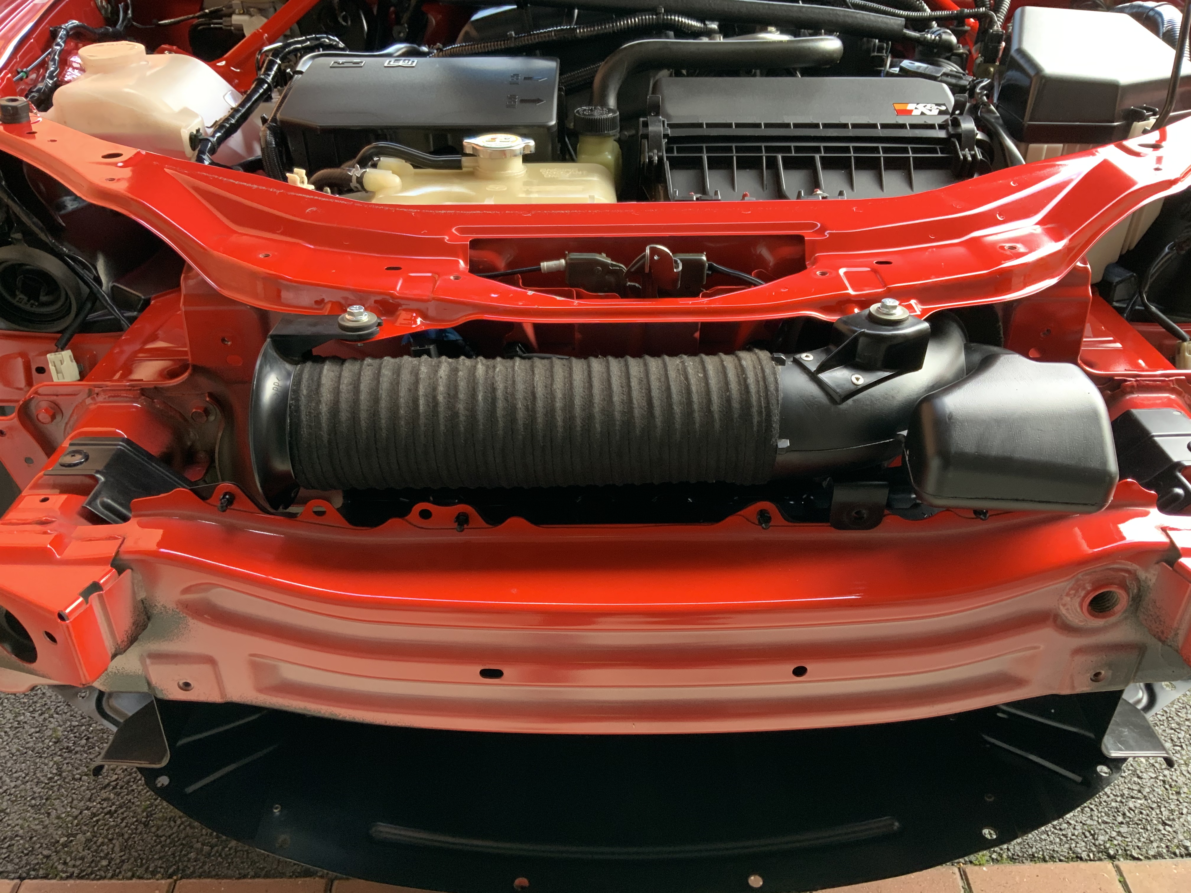

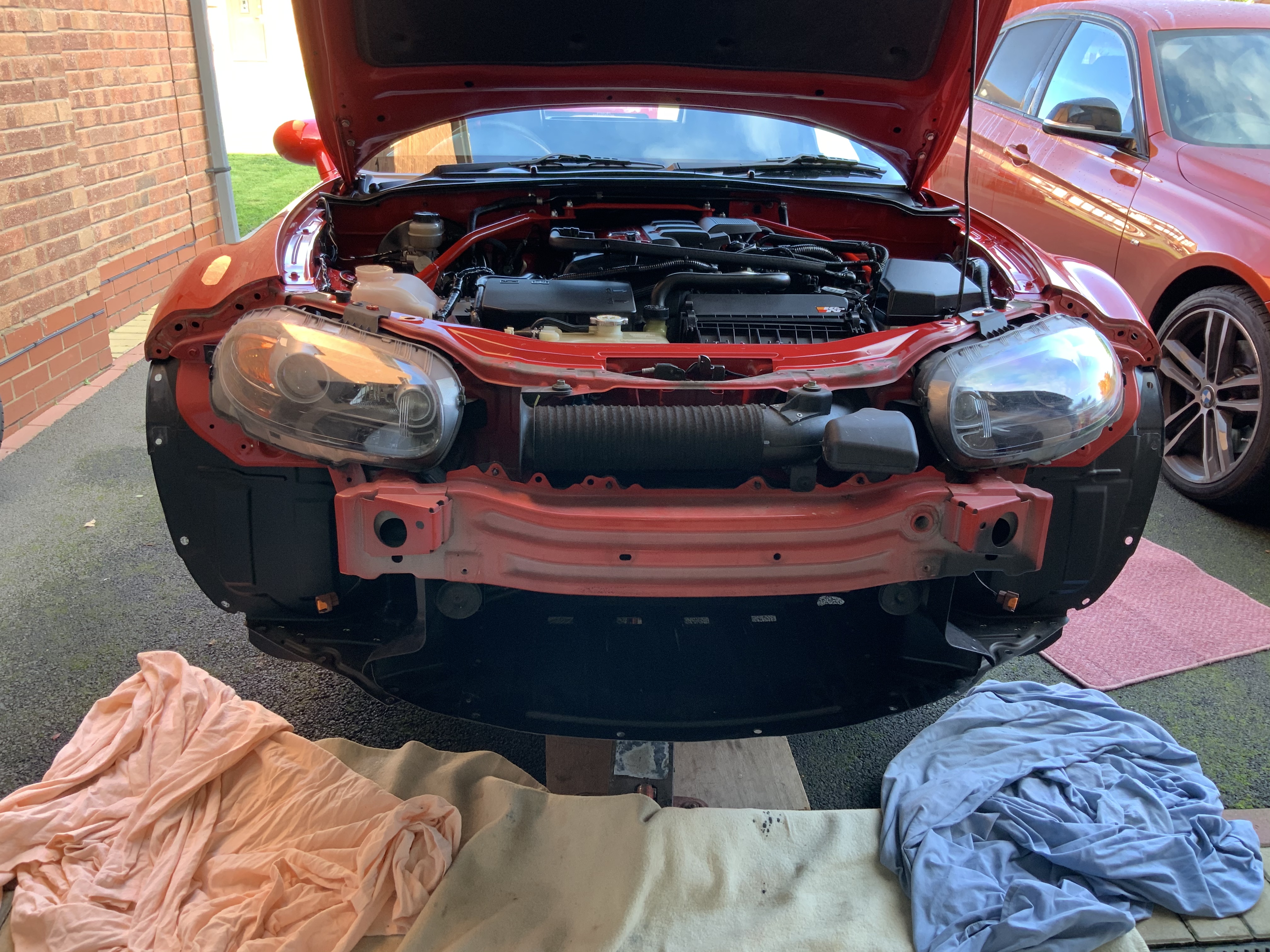

Worthwhile job. Plenty of much in there. Took mine off an no rust but plenty to clean
Before
After
