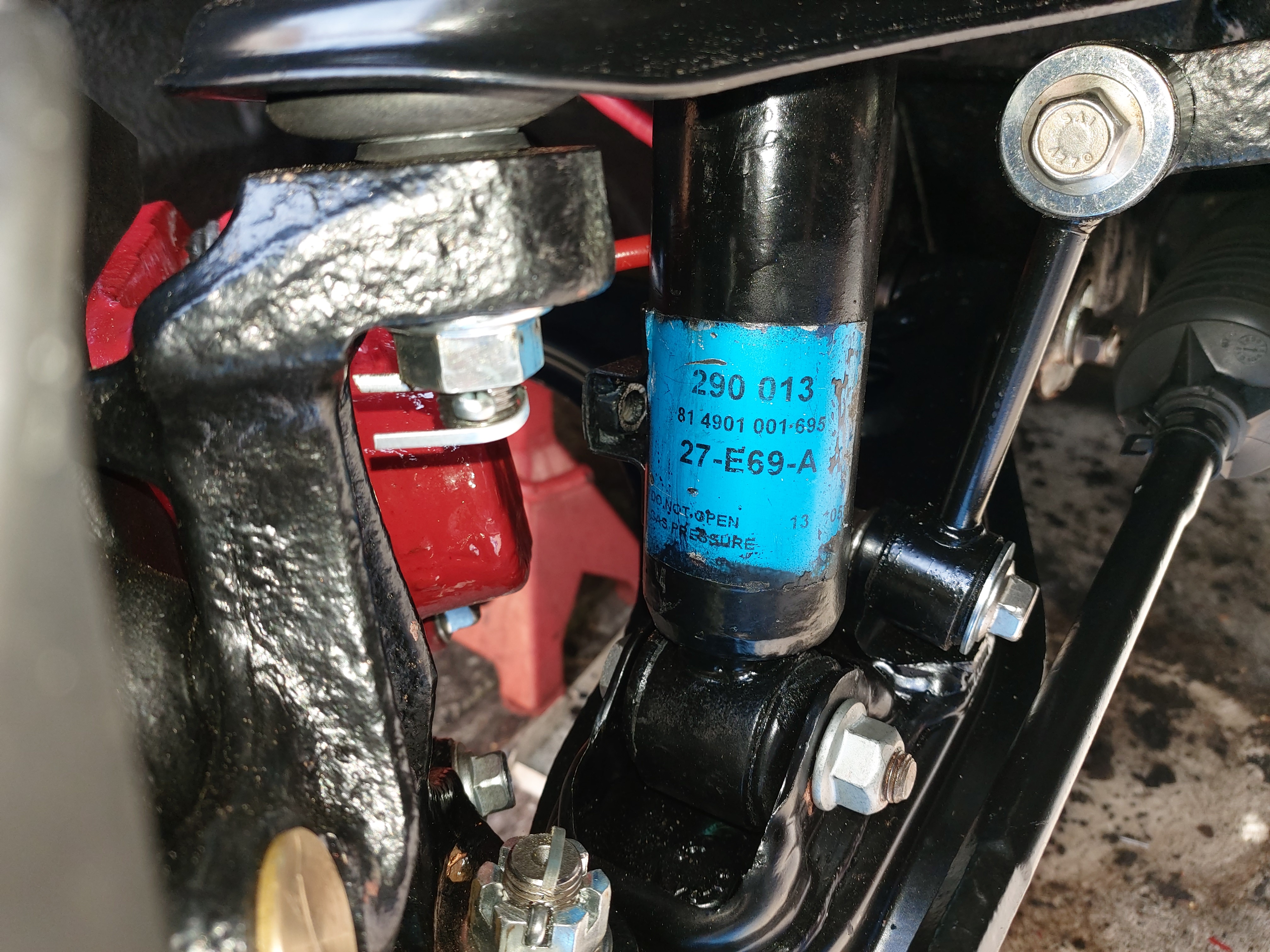

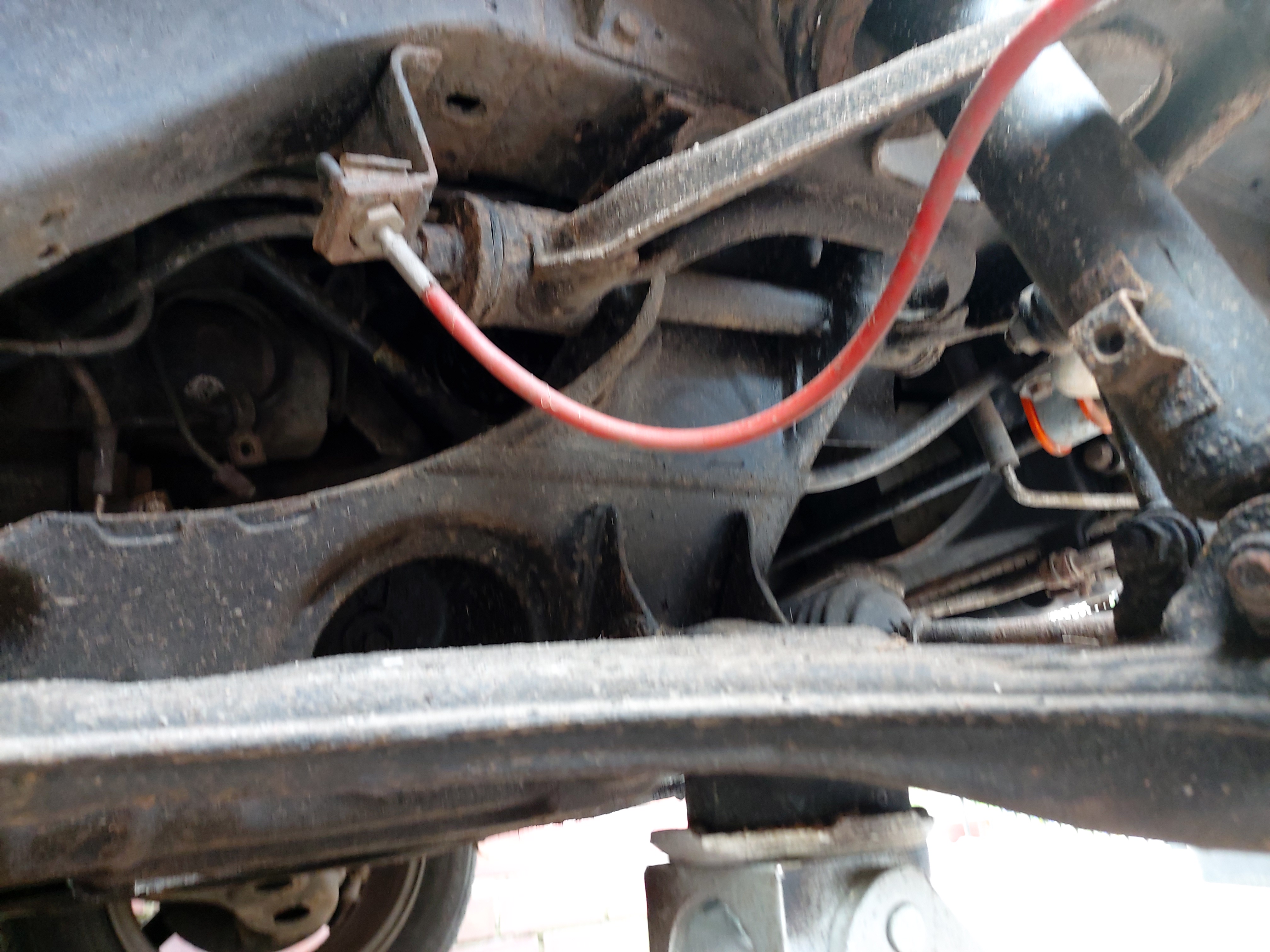

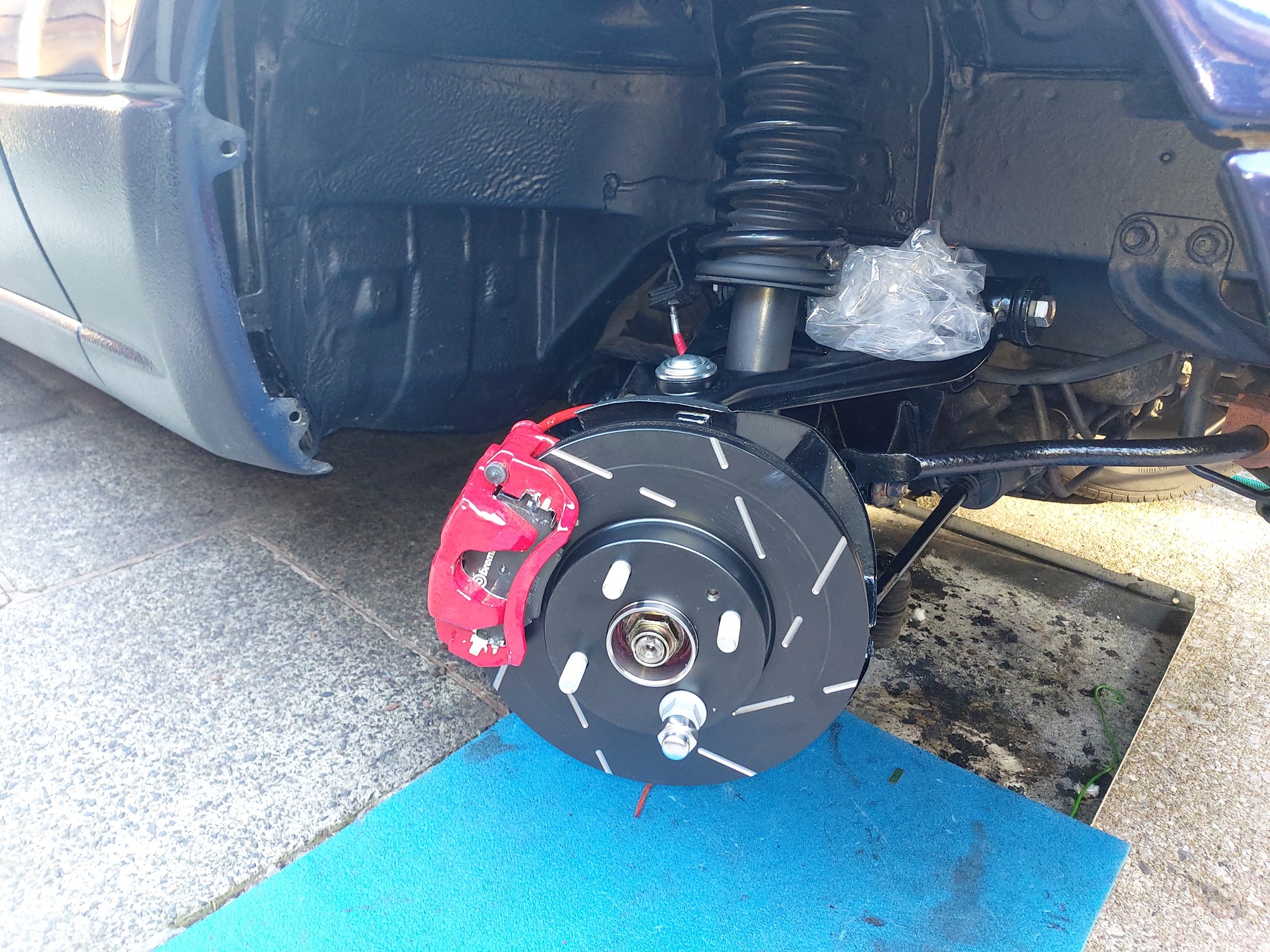

Well twelve months on and Bluebell (the car) has gone from this
to this
and this
So far it all fits including the standard Mk1 drop links
I am just finishing off the passenger side now having replaced the steering rack boots, a broken spring and refreshed the front and rear wheel arches. Just got to let it all settle then torque everything up and have a stab at setting the camber bolts.When the lockdown is over I will take it for a proper setup.
