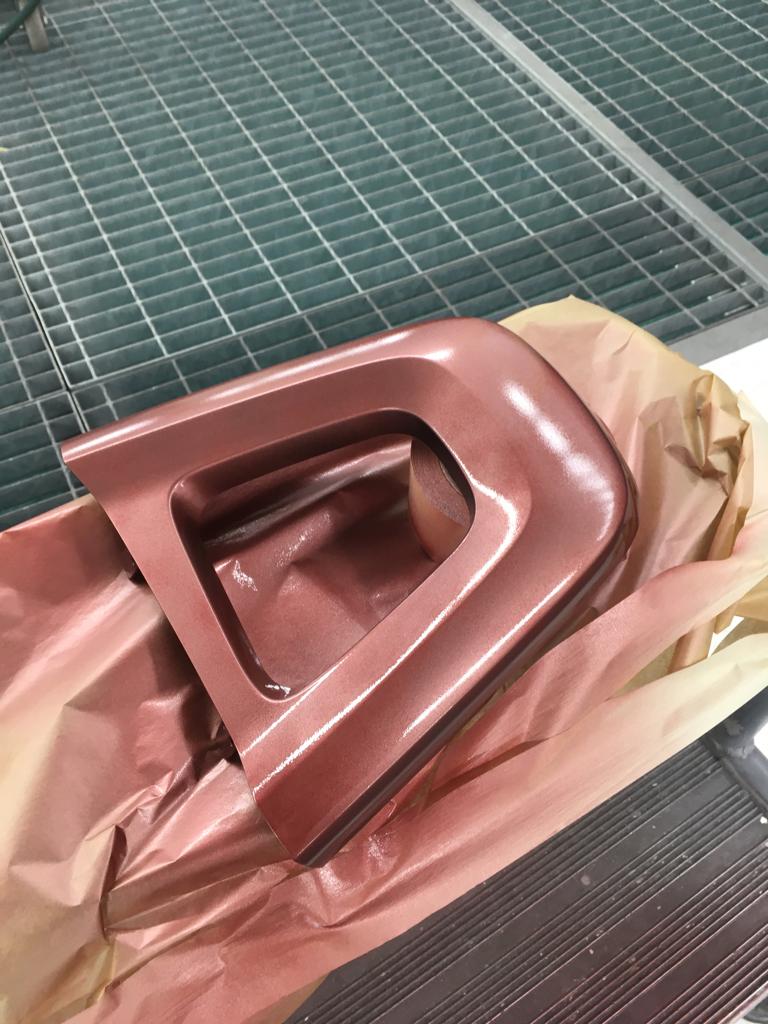

Not sure how much it will help but, when painting soul red crystal metallic (latter colour) I took some photos. the photo below shows the base coat
Then when building up thin layers of the red dye second base coat- I needed 10ish coats of this, the more layers the deeper the colour

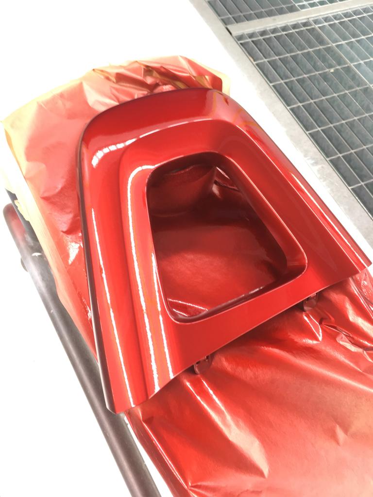

Then the clear coat…
This wasn’t done with aerosols but should give you an idea of what to aim for
Tbh I doubt you would ever get a good match from aerosols given the variation in the dye layers. I am sure someone more skilled than me will disagree!
