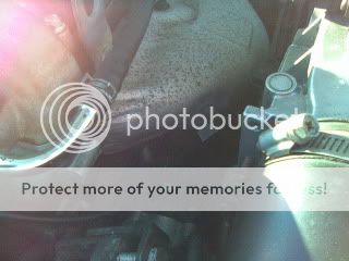

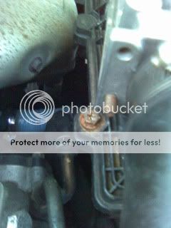

Before read the previous mail started it and moved into sun. Topped it up with anti freeze, let the engine run for less than five mins, temp started rising and noticed steam coming from passenger side of engine, had a look and fluid dripping down from under the manifold? (half doughnut shaped metal in picture) any ideas what’s causing? Not going to move will get the AA out and to a garage if needs be.
As always do really appreciate everyone’s help.
There is a coolant pipe that runs under the manifold and goes to the heater, it’s metal and I suppose it could have cracked with frozen water in it, or the seals mght have gone. The coolant hose to the radiator is under there too.
AA man found a split pipe under the manifold, has covered it in some new type of wonder tape that he reckons is as good as a permanent fix. Car going in for a service next month, will get it replaced then. He filled up the radiator with straight water now have to drain it and fill with anti freeze/water mix is there an easy way to do that?
