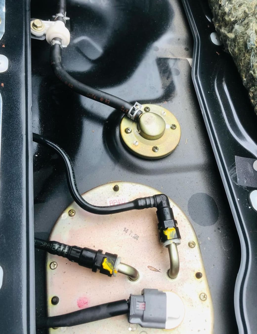

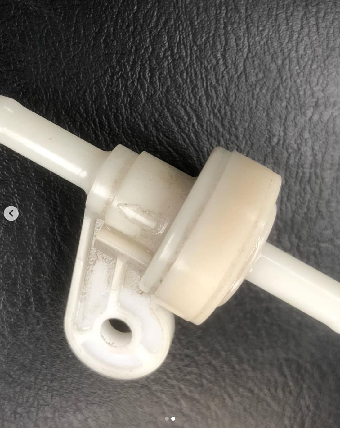

I popped into C&C Sparks ( MX5 specialist ) and Colin suggested removing the tank cover behind the seats to look for leaks. I did this - no leaks. I suspected the ‘fuel vapour filter’ was the problem, so removed & blew some pressure ( breath ) through it, and cleaned with Carb cleaner. I though this had solved the issue, but it doesn’t seem to have done. The charcoal can under the bonnet hasn’t been deleted, and looks in good shape ( it’s a 35K mile car, despite being 19 years old ).
