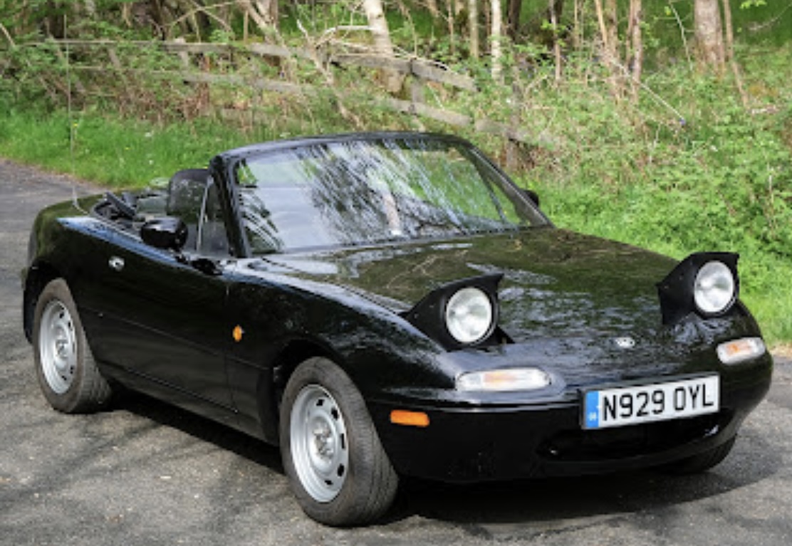

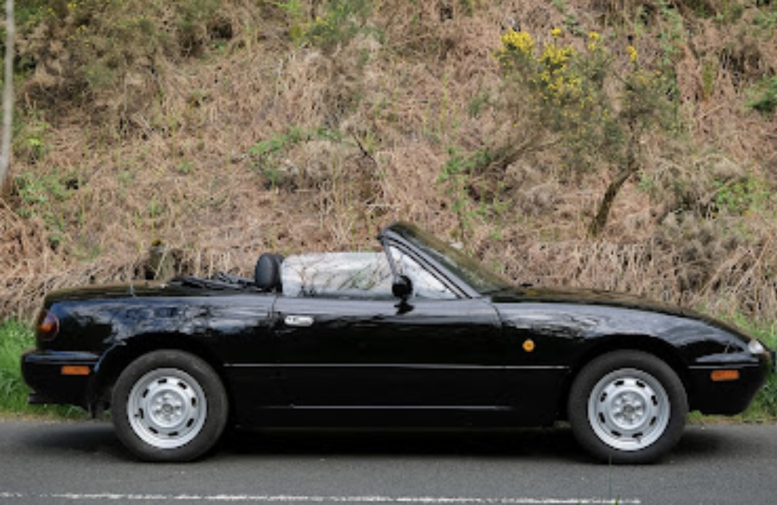

Thought I would share some pics of my car :smiling_face_with_three_hearts:
That doesn’t look right why am I getting text and no images?
Oh I see😂
