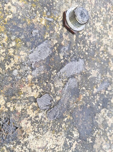

I think mine will cost more as I think a tab may have been eaten. However I doubt it will be anywhere near the 500. Hopefully.

I think a lot of them eat a tab or two.

Here’s what I found. Cone clutch tabs (?)
:sweat_smile:
Yes they are.
Think that’s par for the course. Was surprised to find none in my oil. Maybe the oil was changed before.
