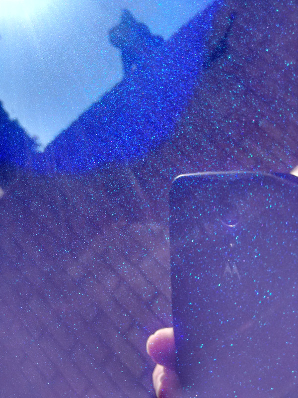

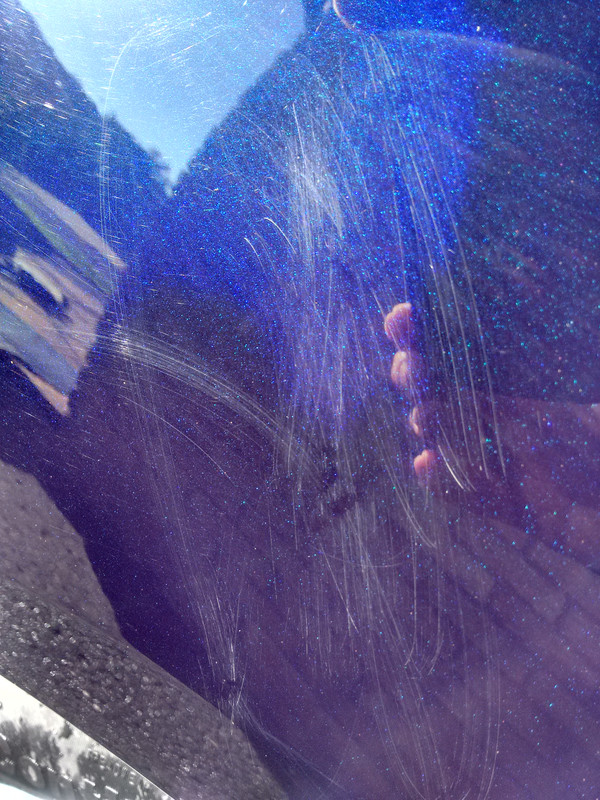

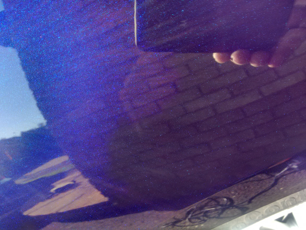

My personal weapon of choice for swirls and scratches is Meguairs Ultimate compound and my Meguairs  DA polisher picture below was my wife’s car with bad scratches took me about 15 minuets with the polisher.
Before
After
