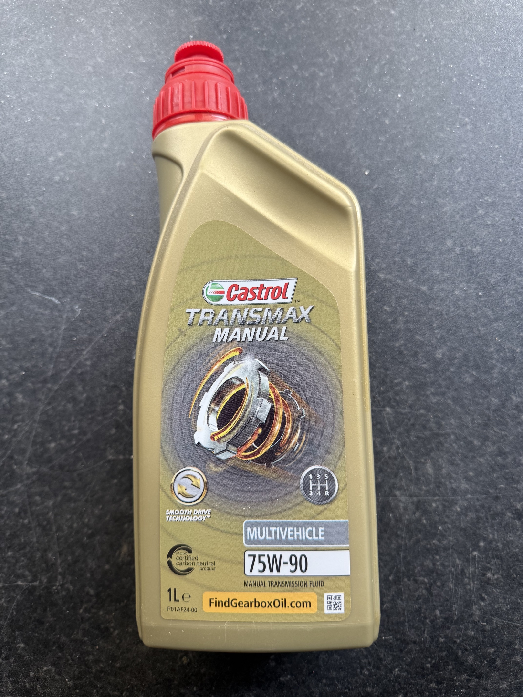

As already said change all the fluids as a base point.
I have a 2013 3.75 Sport Tech Nav and have experimented with a few different gearbox oils……
Stick with a GL4 ONLY.
Just my opinion I would use this as it’s great from cold use.

I did top mine up when I had the centre consul out fitting a new Kenwood unit.
Does that make a difference I don’t know, (I doubt it to be honest).
It’s all down to the synchromesh bulk rings etc at the end of the day.
As they are a soft metal which can wear/deteriorate with incorrect oils.
Just my opinion, but I think they uprated the 6 speed gearbox slightly from the 3.5 onwards.
I can tell you I used Total a couple of times and then went to the Castrol literally after a few months with some research (GL4 ONLY) and will stick with that.
Total recommended it but that was a GL4 and 5…
