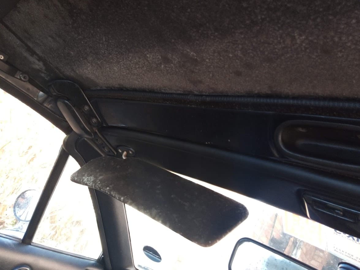

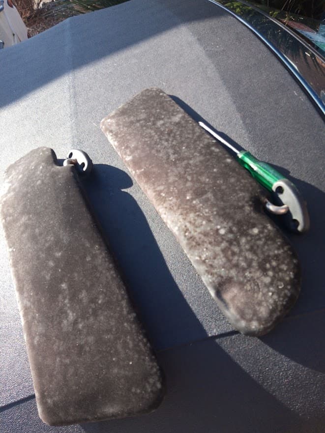

My Roadster had been stored in a damp garage for a month and half recently. The interior turned furry.
It cleaned alright, but pulled the car out today, and its damp inside, in that it rapidly fogs up. Going to leave it out for a bit, and allow some air to circulate through it.
Strange that it’s like that after only 6 weeks.
Are you sure that it’s not damp inside from a leak?
This will rapidly accelerate fungal growth.
My mates camper van had the same scenario, until he found out there was water ingress and got it sorted.

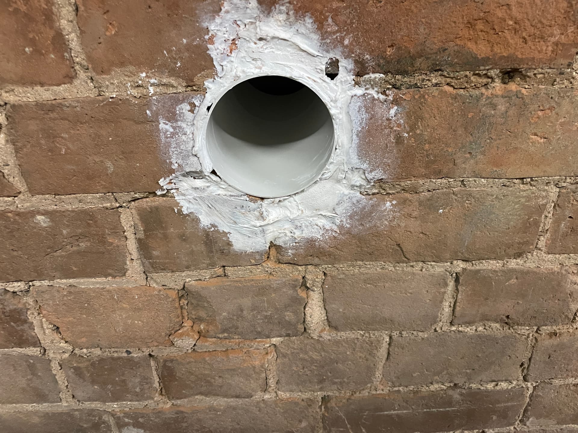

Ventilation upgrade is underway…
