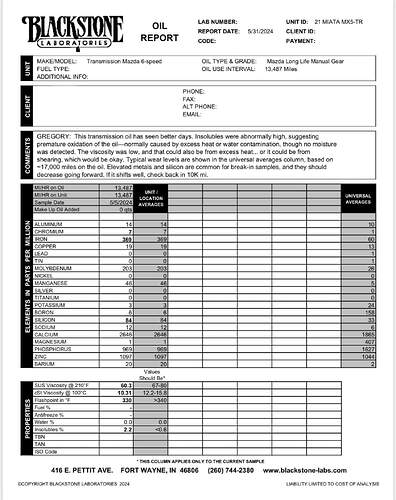

This oil report shows that even at 13k miles the gearbox oil needs to be changed
