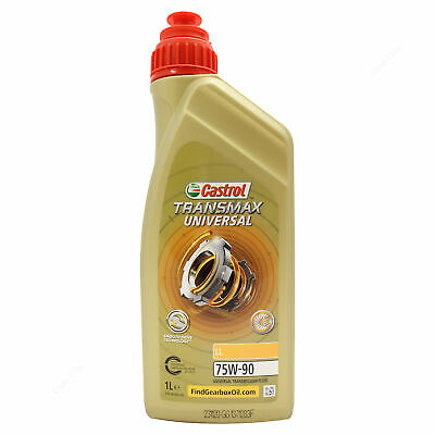

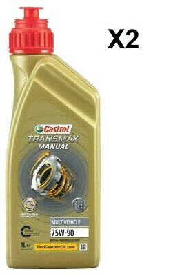

This for the gearbox, GL4
This for the diff, to spec GL4-GL5 to look out for.
