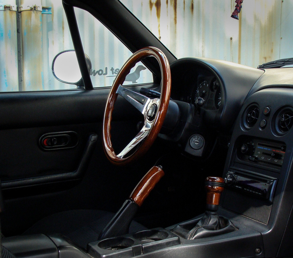

Okay some of you might think I’m daft or insane, but I’m going to make my own gear knob. I love the idea of a dark, mirror-finished wooden ball of a gearknob. I think it would go well with the black interior, would look quite ‘classic’ in an odd way, and would feel fantastic. I’ll be keeping the original, just in case I don’t like it.
Basically, I’m ordering two relaxing wooden balls:
And an m10x1.25 thread insert:
Drill a hole, pop in the insert, job done. £6 for the balls, £2 for the threads, gives £8 for the project. The balls won’t come for a few weeks as they’re from China.
If it goes well, the balls come in pairs, so I could make a second for someone if anyone’s interested.

And for a very crude mock-up
I think it’ll look and feel quite nice. Thoughts?
Excellent. I think though that when you’ve done it you’ll need to find a way of bringing the gaiter up so it sits flush to the knob - in the way voodoo knobs sit. It’s why they are machined with an extension below the thread. (I’ve gone the other way on my black 3.5 - Mazda’s “Wood” dash trim and a piano black voodoo ball.)
What a transformation. Your car looked ok in photos before but the improvements are tangible.
Neat idea in the wooden gear knob too.
How will you secure the threaded component into the wood?
Two pack or another means?

Thank you. The thread fit was quite tight on its own, but with superglue it’s worked great. Have a look below!

When we got home, my wooden ■■■■■ (snigger) and thread insert had arrived!
The Chinese ones were resin and not wood, so I had to cancel them and buy some more off Amazon that were wood. £8 to give this a go in total, so it’s worth a try.
The aim was a bit of a homage to the original MX-5:
And to the Carrera GT, one of two of my favourite Porsches. The other being a 964 Turbo.
I practiced on the lighter one, and finally did it on the darker.
Bit messy, but it’s underneath.
The thread was a tight fit, so I had to hammer it in, then superglue finally bonded it in incredibly well. It isn’t coming out anytime soon.
