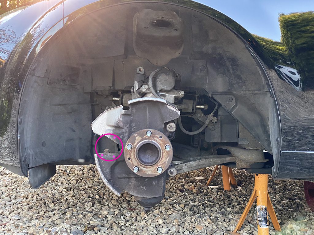

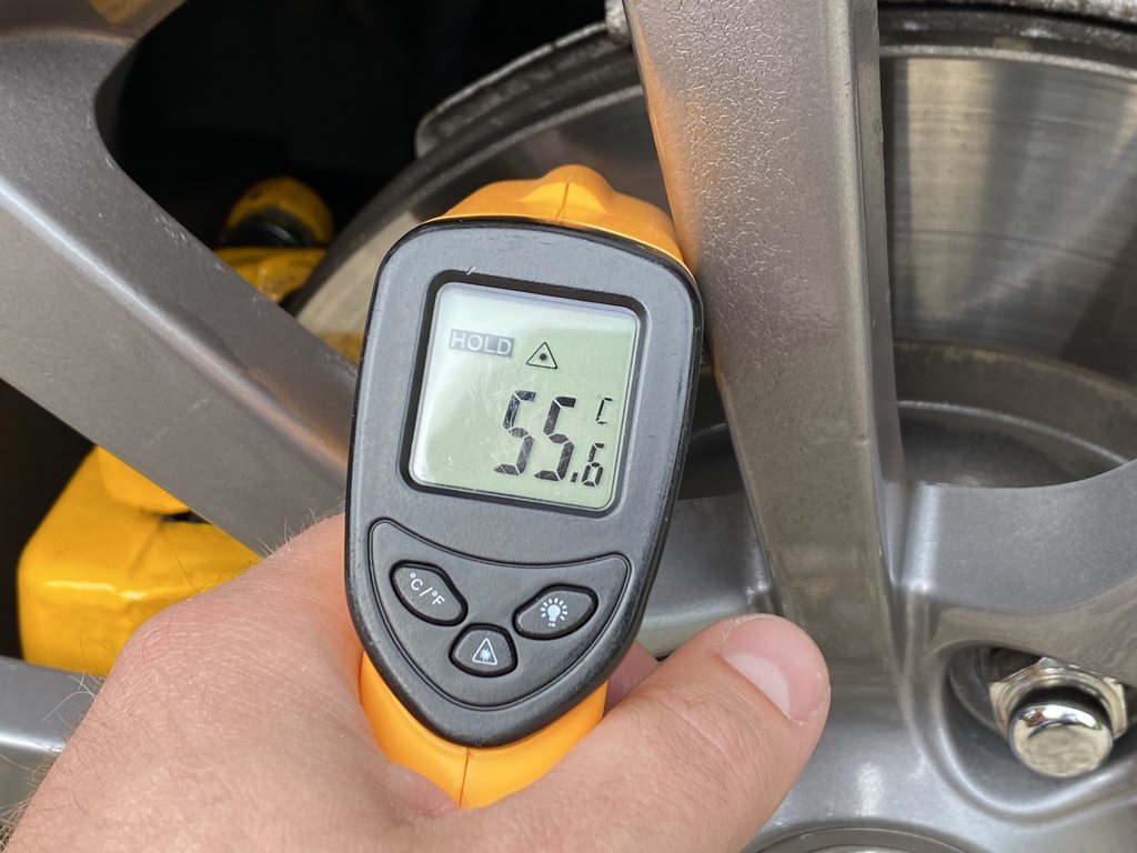

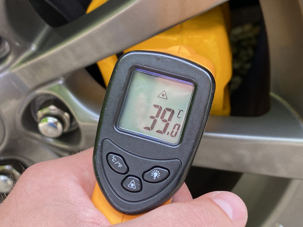

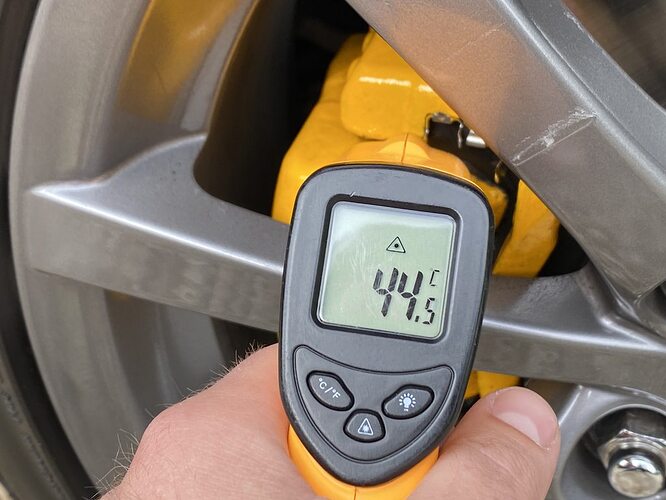

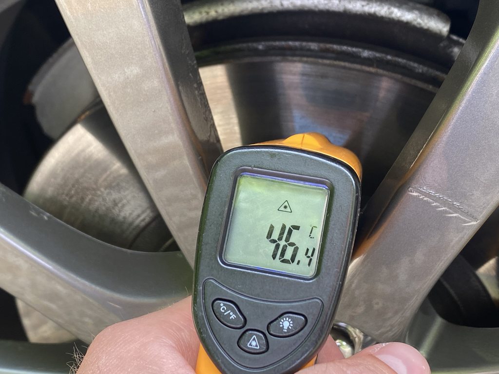

I’ve still got a bit of a squeaking going on with the O/S/F brake, and it’s still a tad warmer than the other side. I think it may be early signs of a sticky piston.
Here’s the temperatures after an average drive.
O/S/F Disc:
N/S/F Disc:
O/S/F Caliper:
N/S/F Caliper:
The disc is around 9°-10° hotter, and the caliper around 5° hotter. Nothing substantial, but the wheel gets dirtier quicker than the other side, and is squealing a tad. I’ve got the piston and seals so I may as well just re-build the caliper. At least I know it won’t be a weak spot on the track day next month.

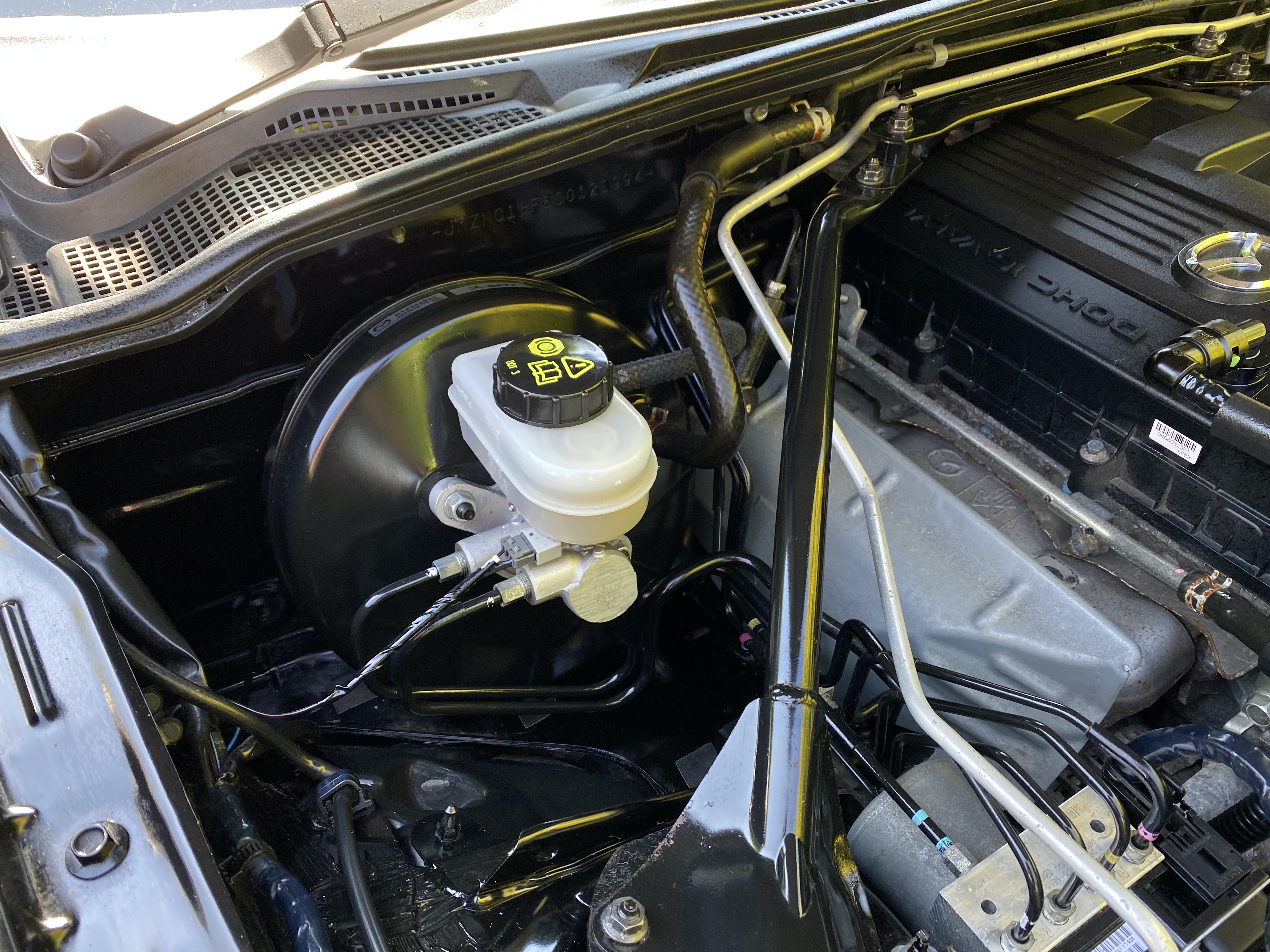

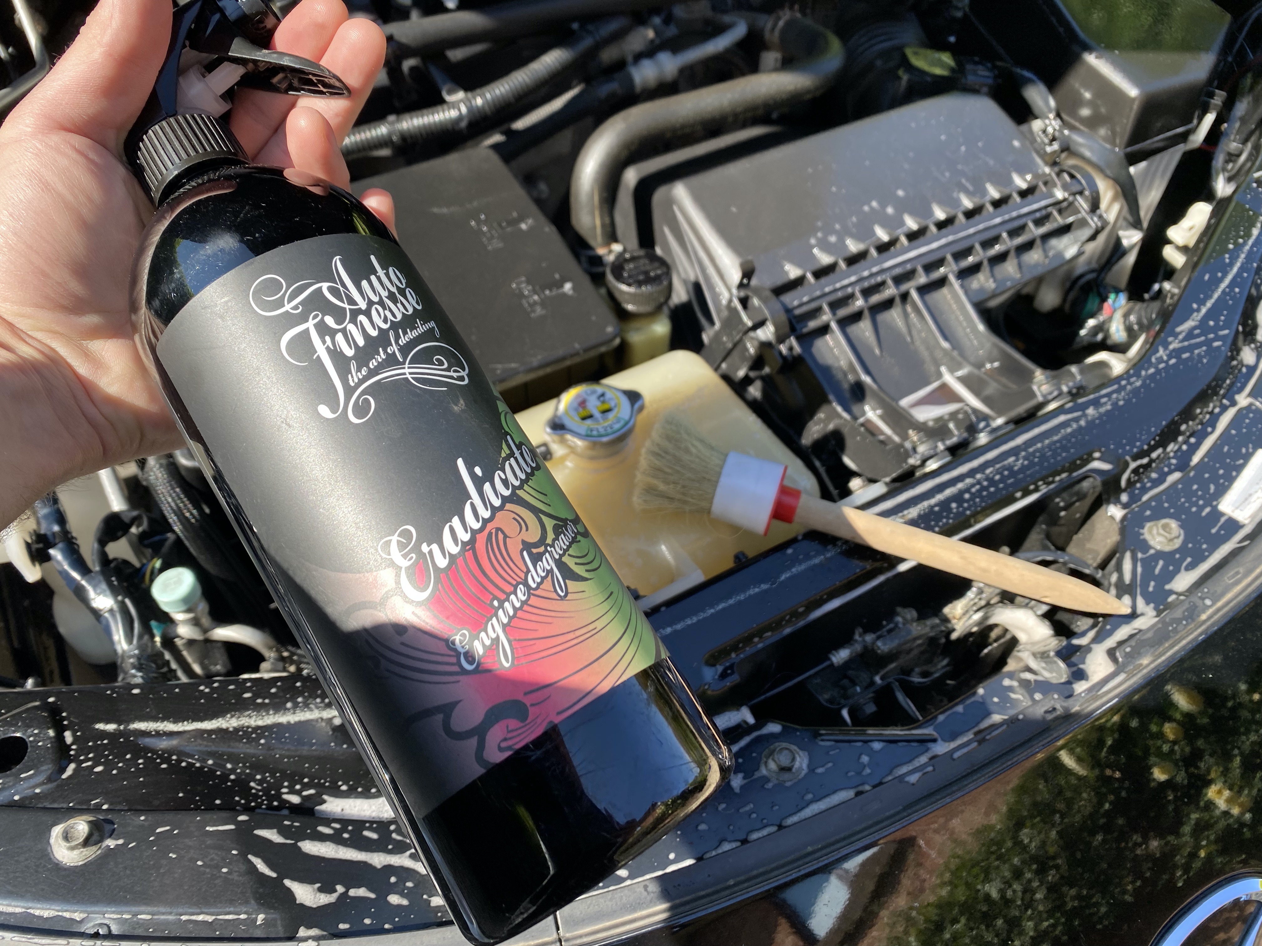

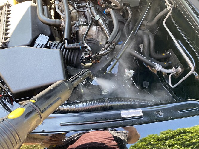

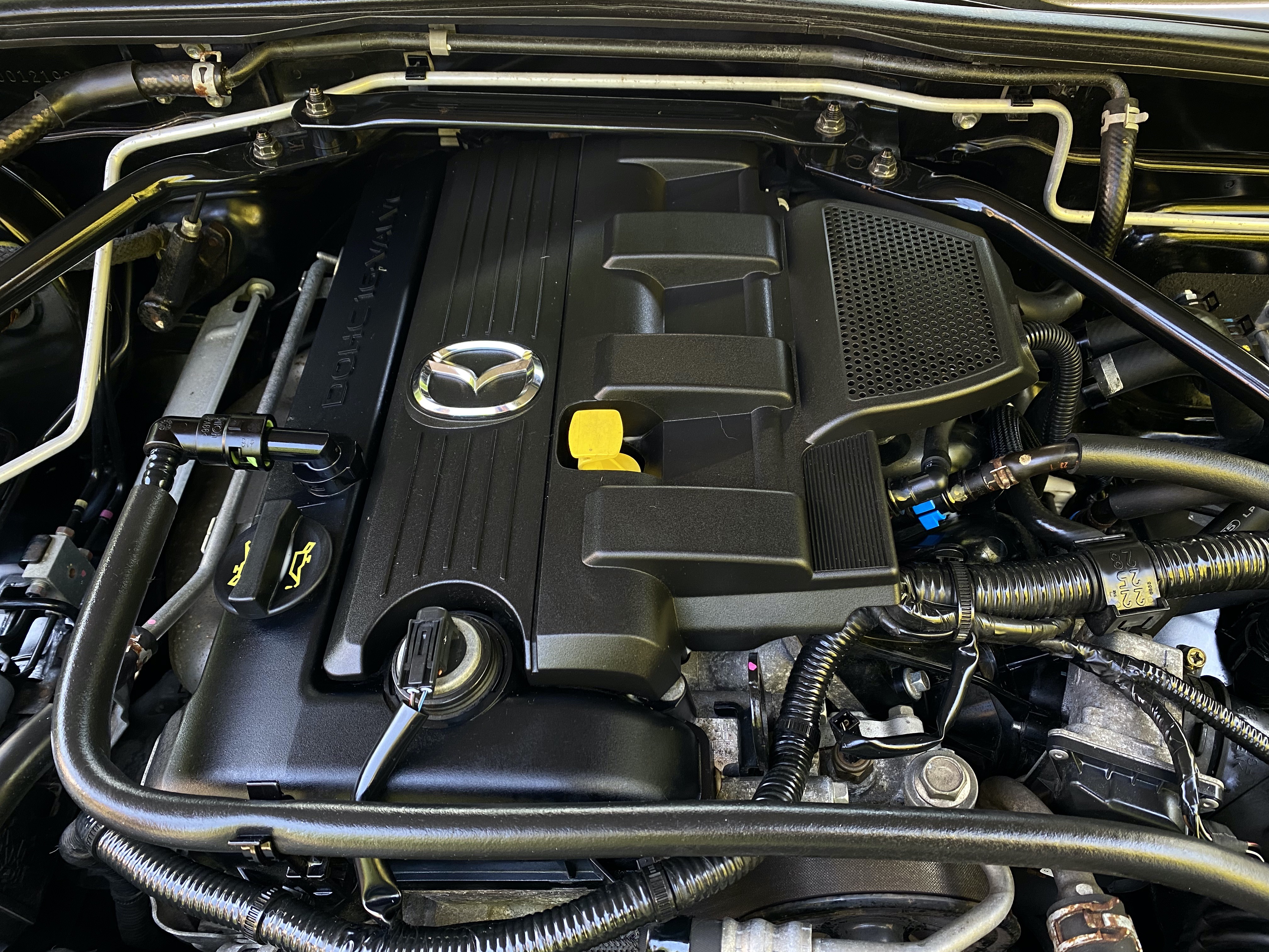

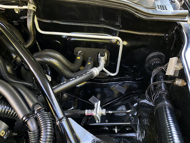

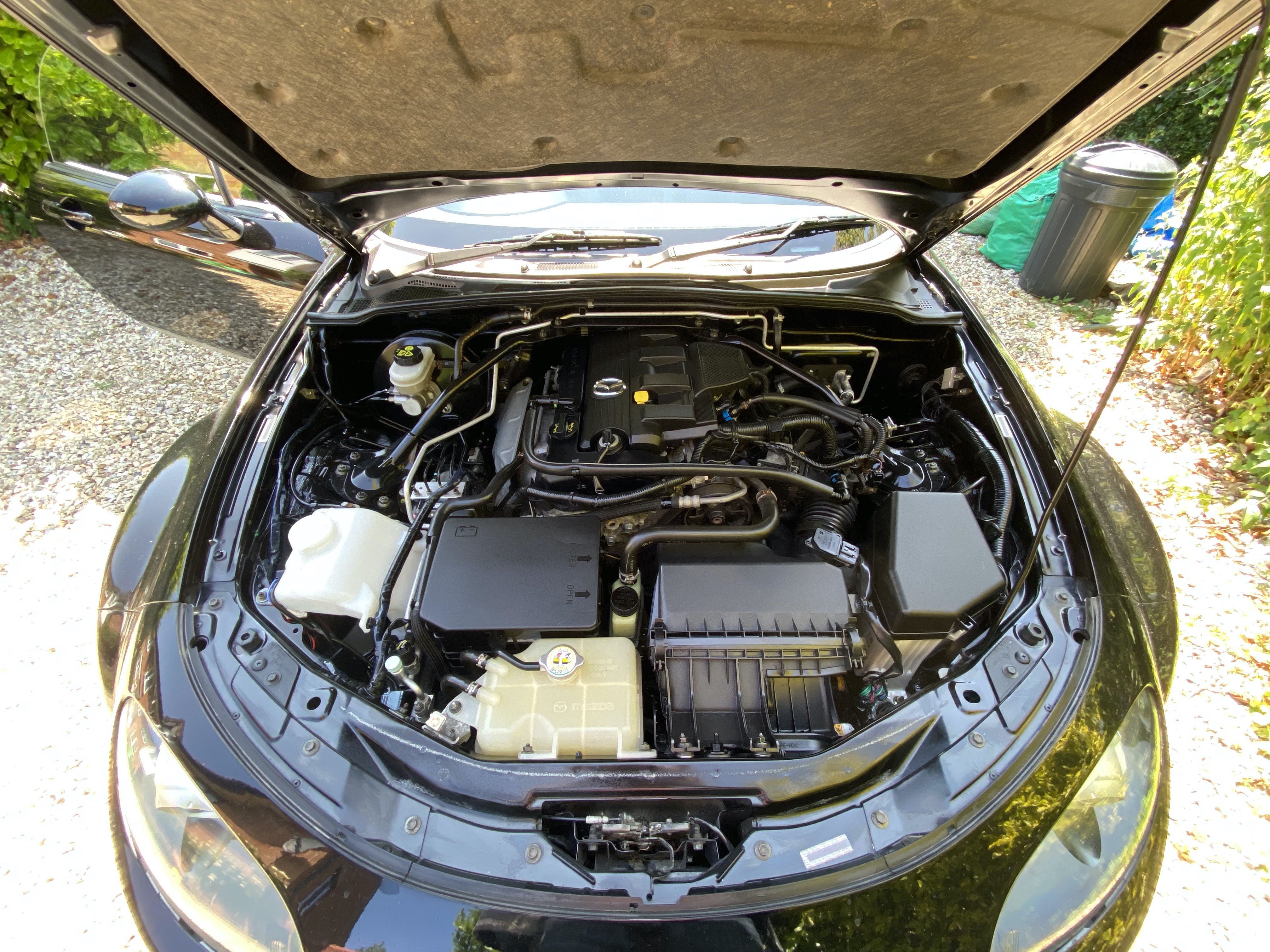

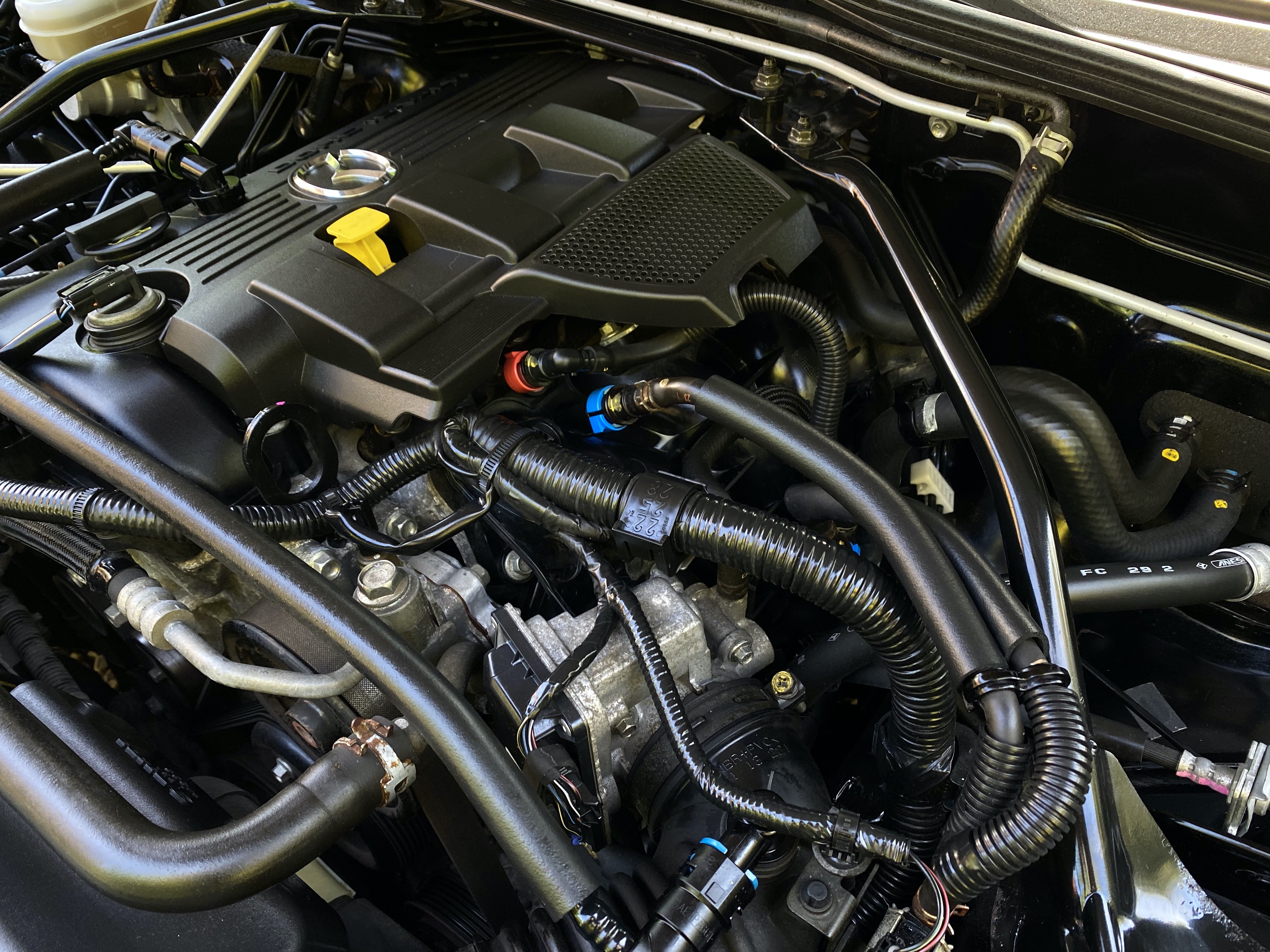

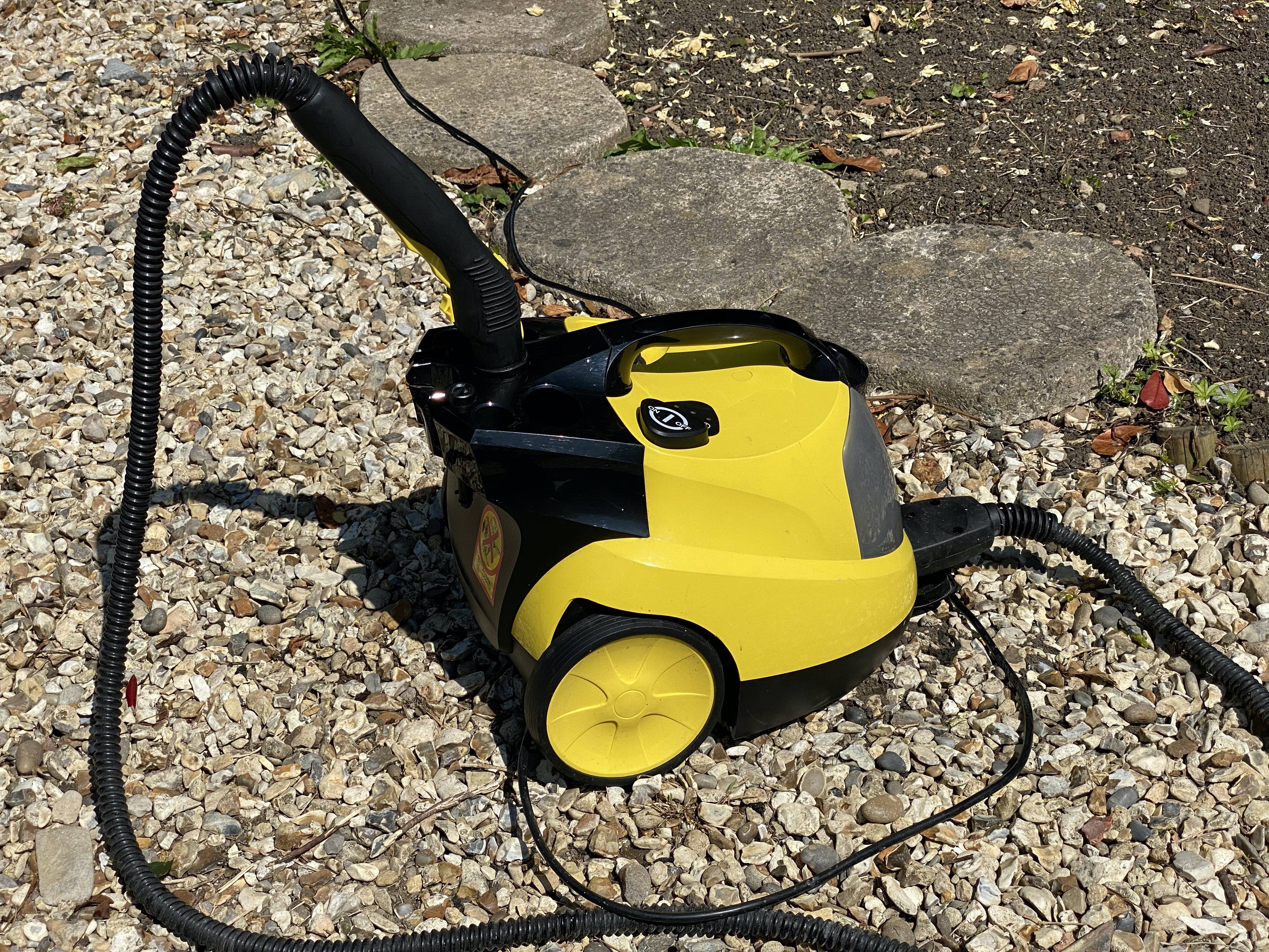

In the meantime, it’s been a while since I cleaned the engine bay.

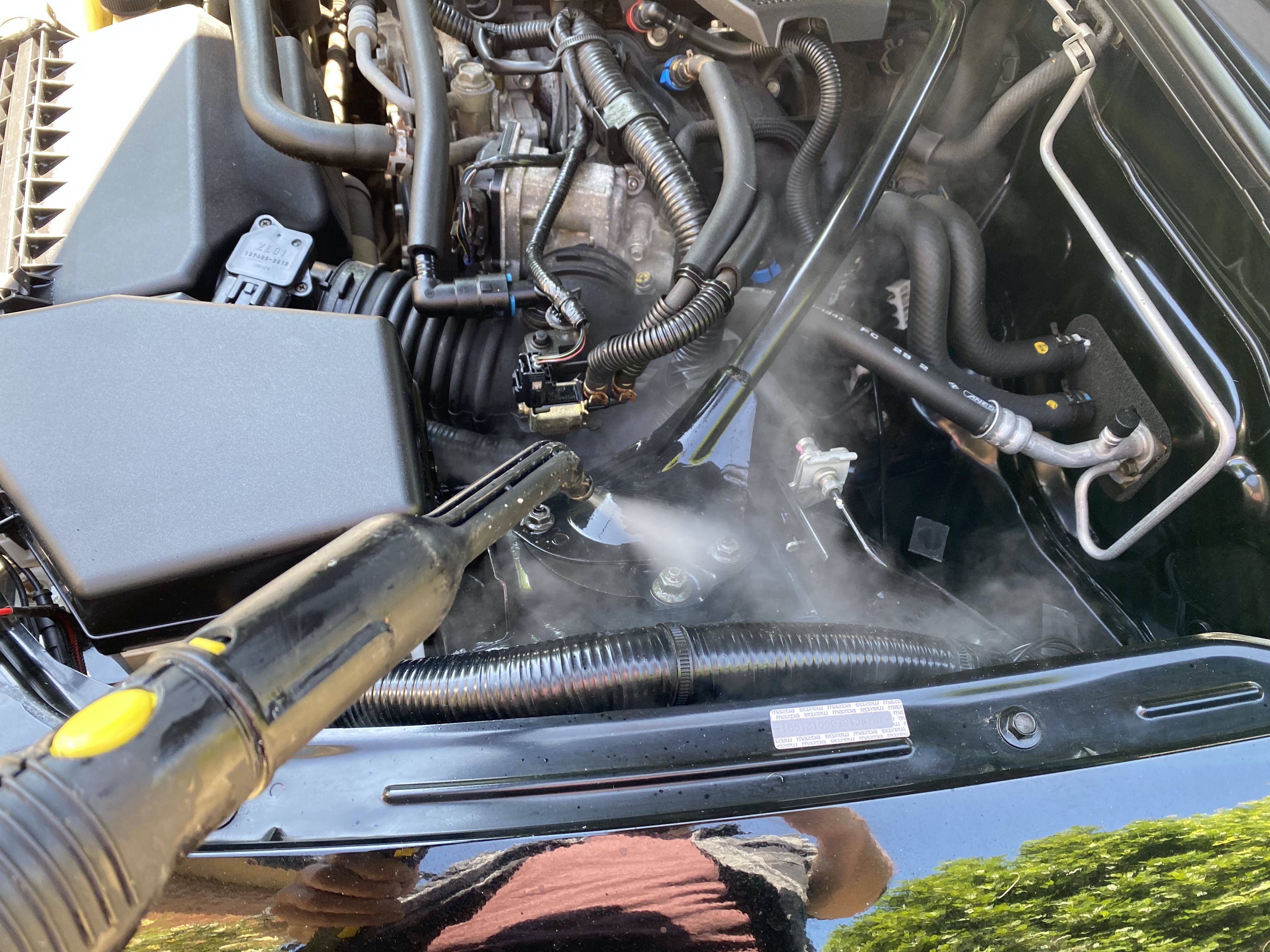

I usually use an engine de-greaser and a brush, followed by the mist setting on a hose pipe.
It wasn’t quite cutting it in some areas, so brought out the steam cleaner.
This thing is fantastic! It gets into every tiny area, perfect for things like badges on paint work too.
The result is a lovely clean engine bay that’ll (hopefully) last a while.

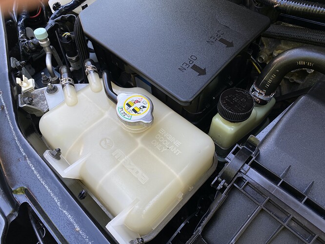

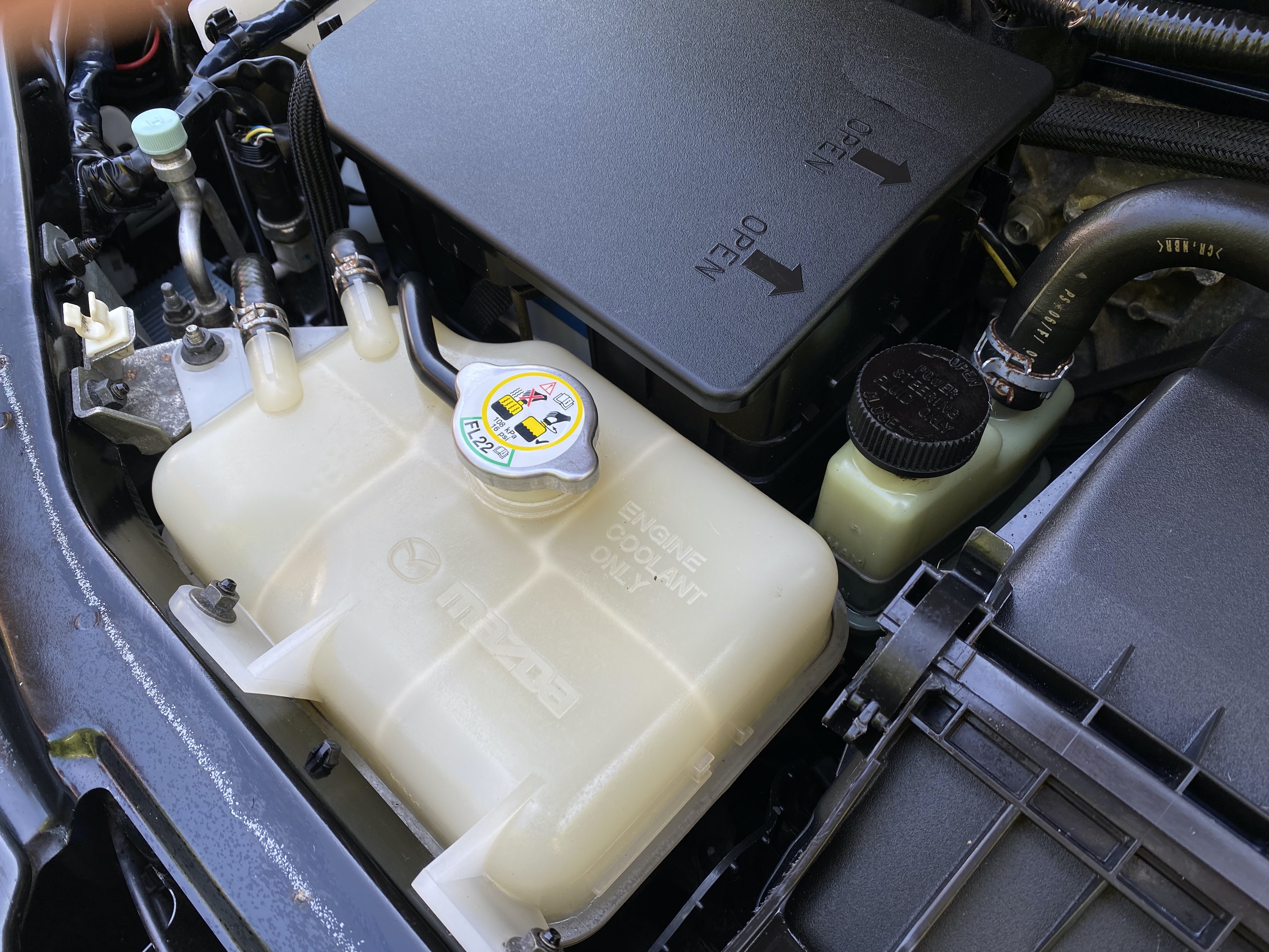

One thing I’d love to replace is this coolant tank…
I hate the fact that it’s brown/yellow. They’re around £60 new so I’m in no rush to get one, but it’s definitely on the list.

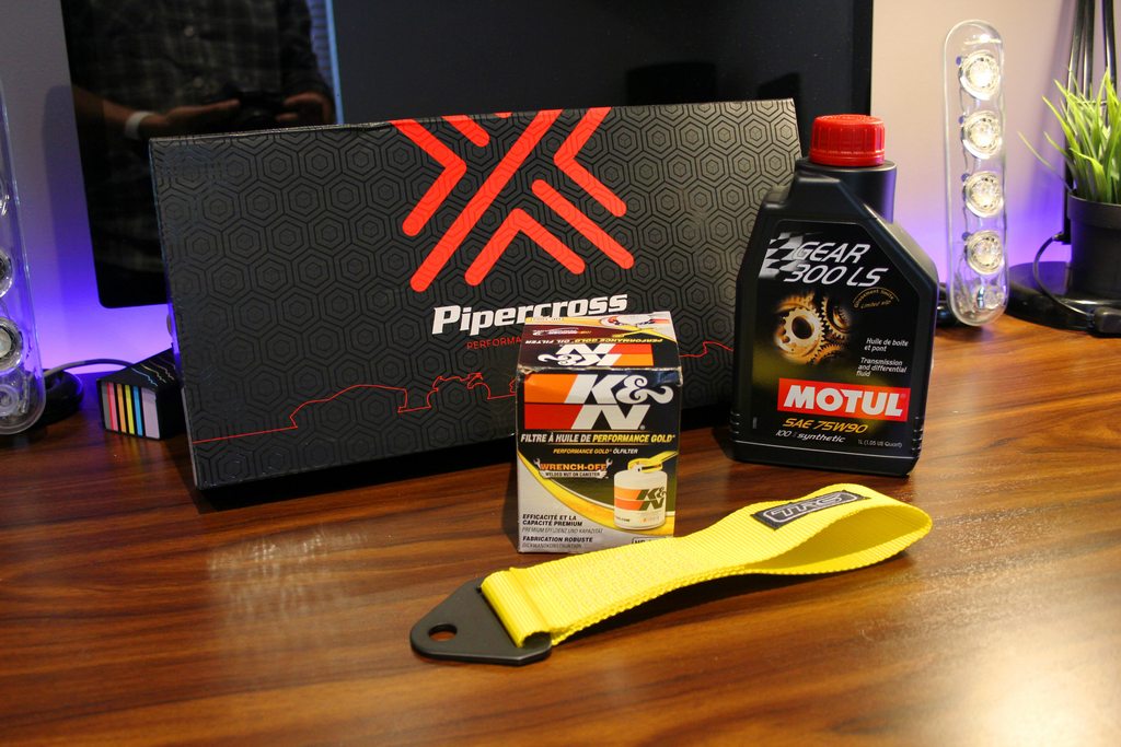

All the while, the track day is getting closer so I’ve just ordered a few goodies:
  • Pipercross panel air filter
  • ATE Typ 200 racing brake fluid
  • Fuchs Titan GTI XTL 5w40 oil
  • K&N HP-1002 oil filter
  • NGK ILTR6A-13G spark plugs
  • Motul 300 LS 75w90 differential oil
  • Millers TRS Synth 75w90 gearbox oil (bought a couple of years ago for the Boxster, left in the shed never opened)
  • TRS Tow strap
  • AA fire extinguisher
Essentially good quality fluids across the board so that I can safely push it with a bit more peace of mind.

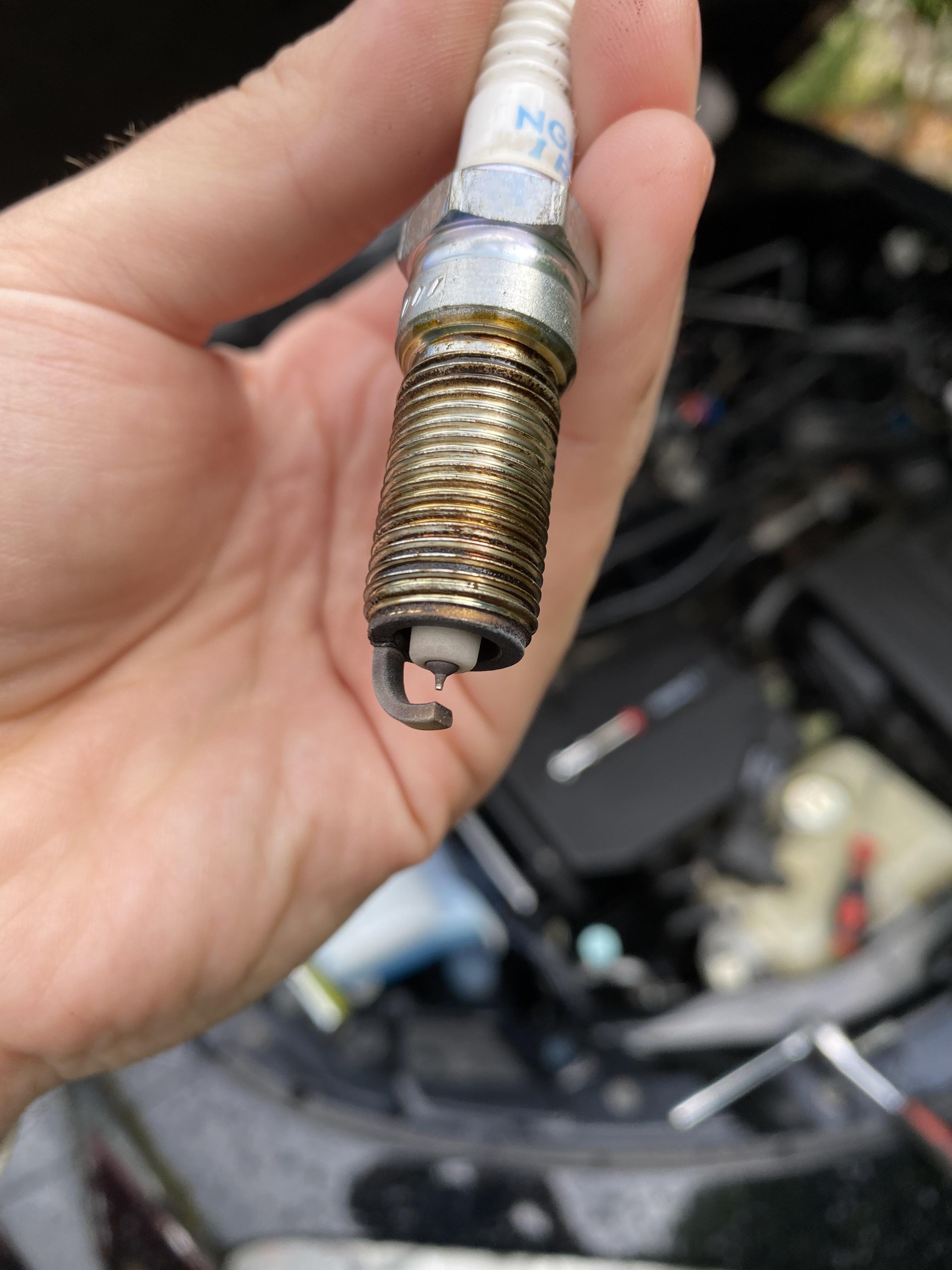

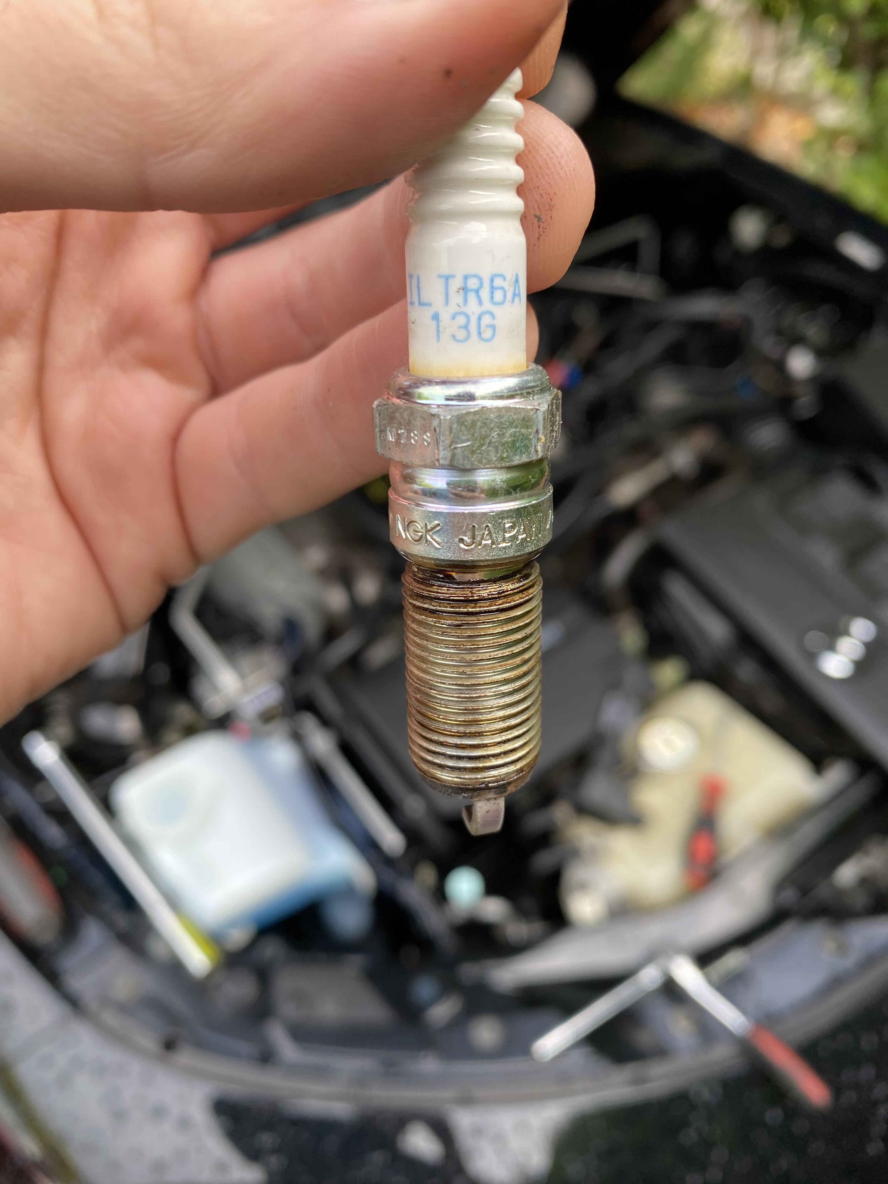

After ordering that, I thought I’d double check the spark plugs to see what ones the previous owner’s garage had put in:
Looks like they’re the same NGK ILTR6A-13G’s that should be in there, which is great. Also annoying as I don’t think these need to be replaced for a long time yet and I’ve just spent £56 on 4x spark plugs. I may put the new set in so that it’s all new, or just keep them for further down the line.

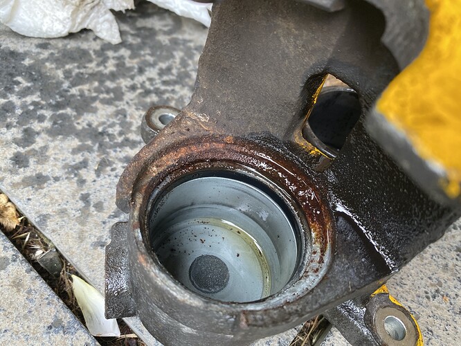

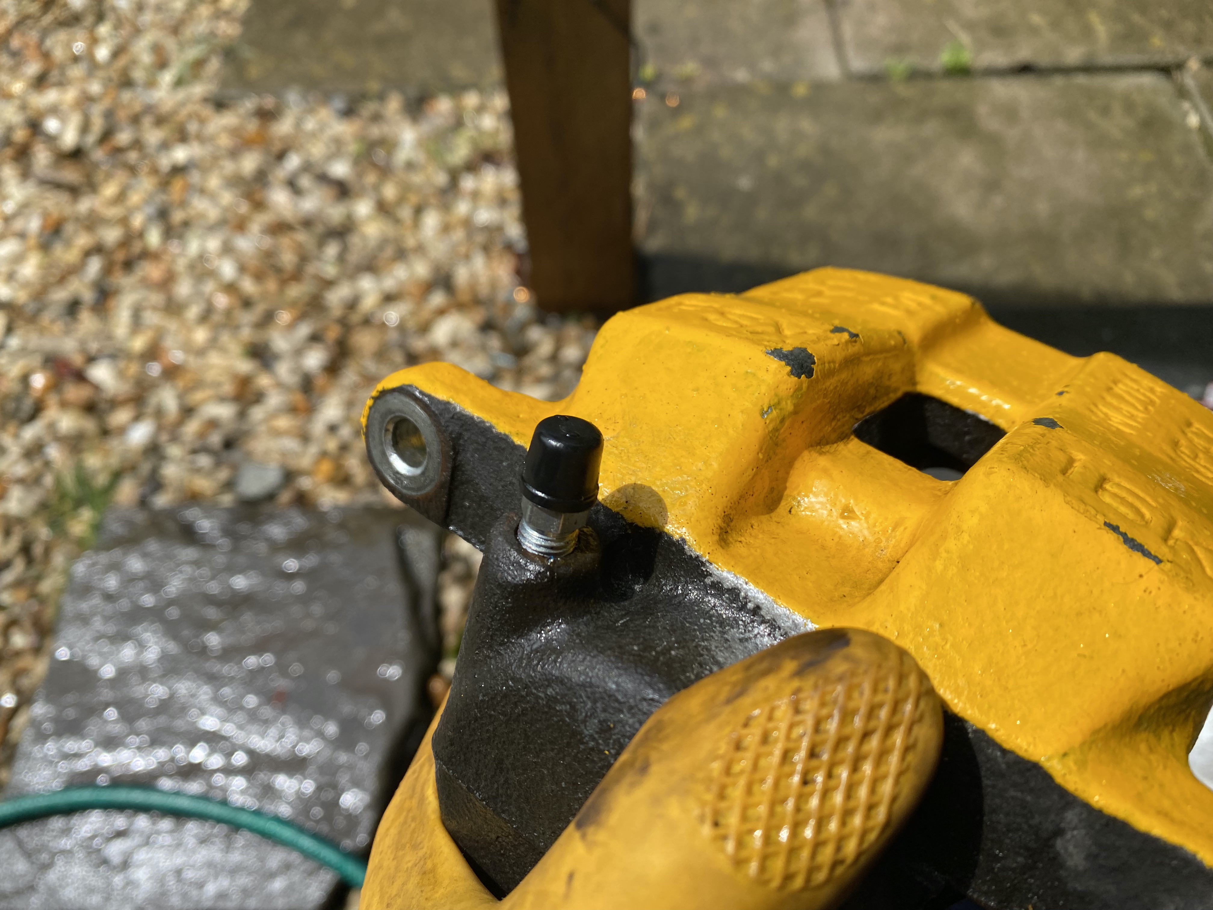

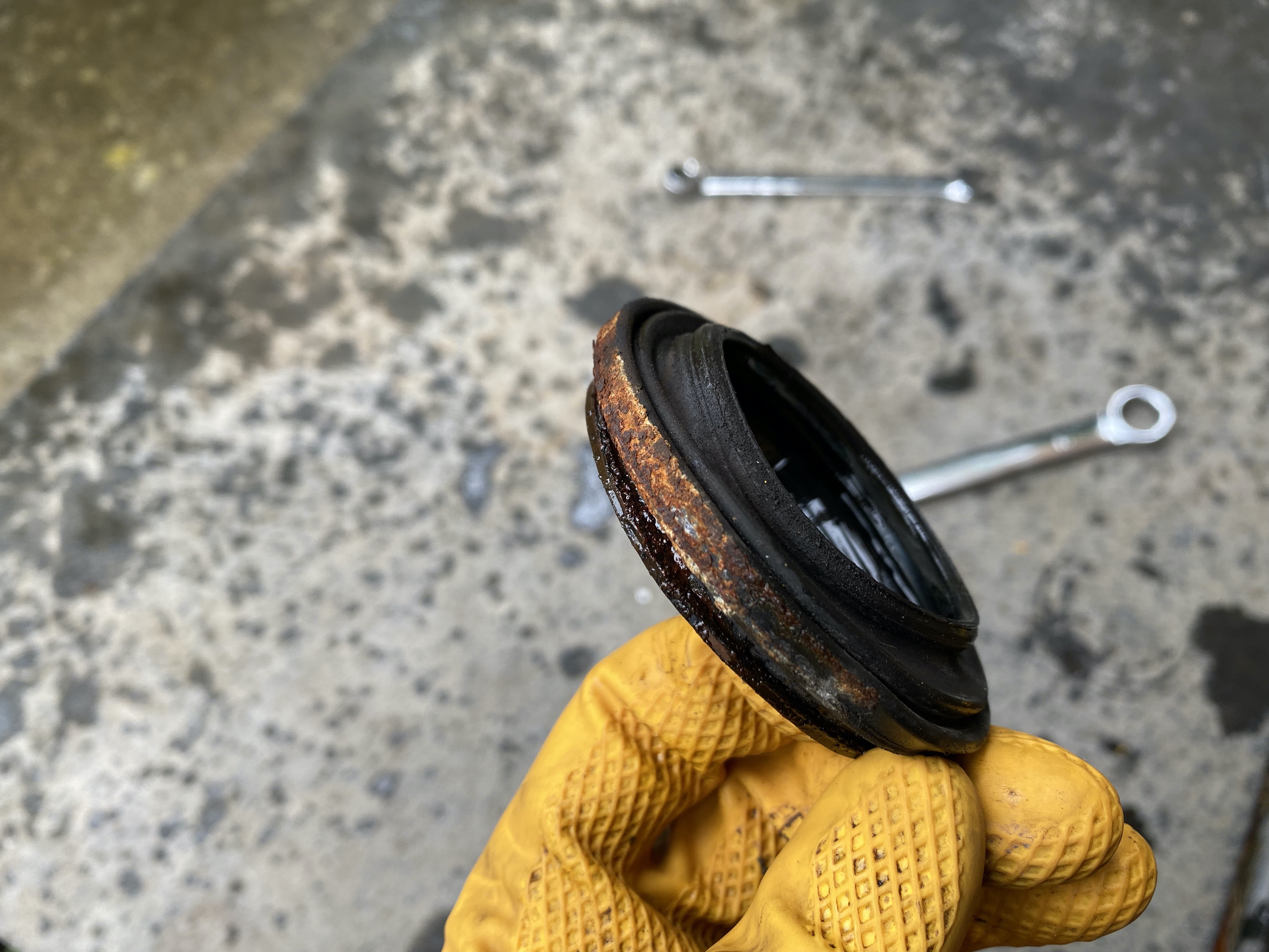

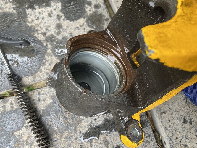

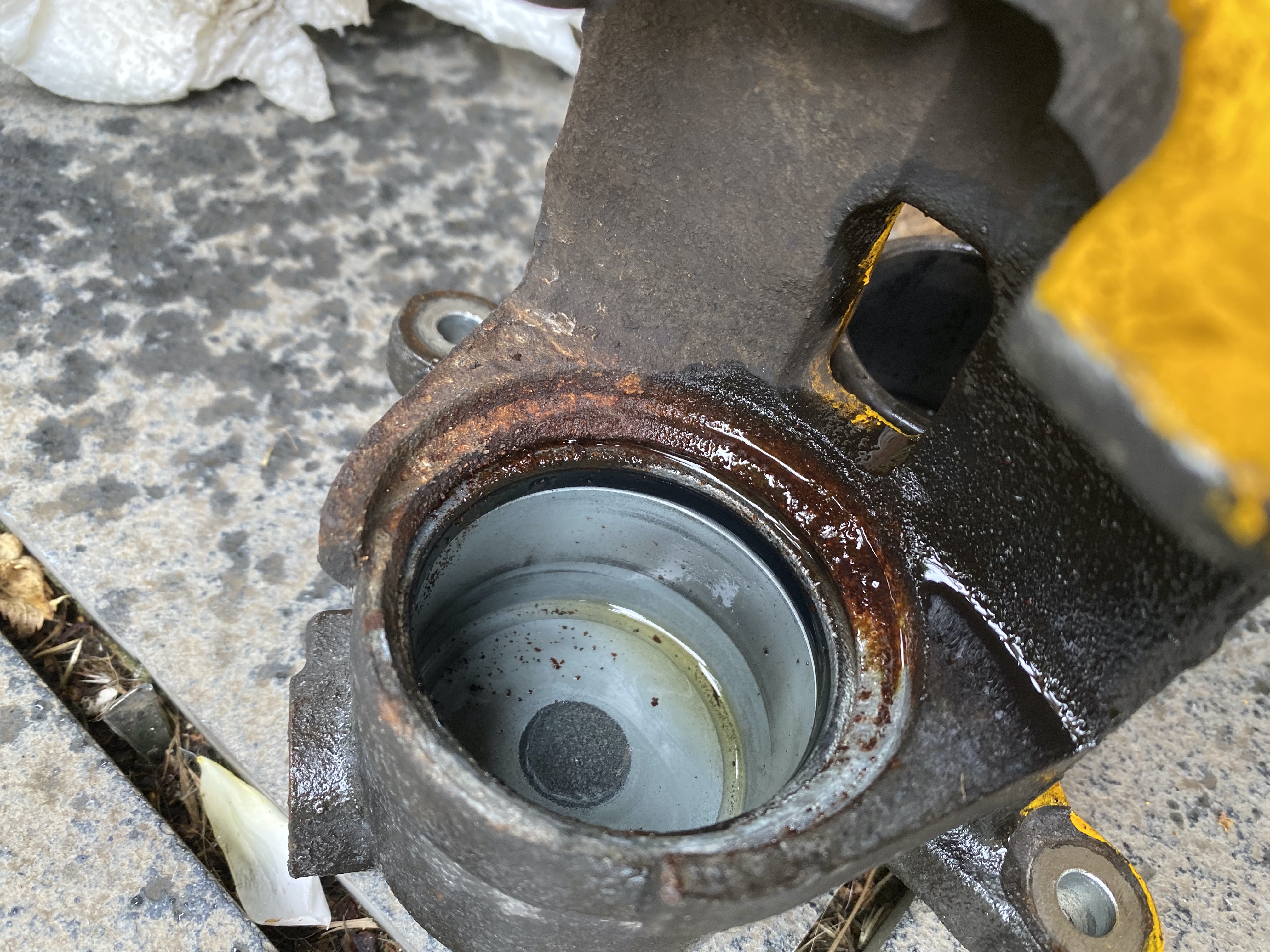

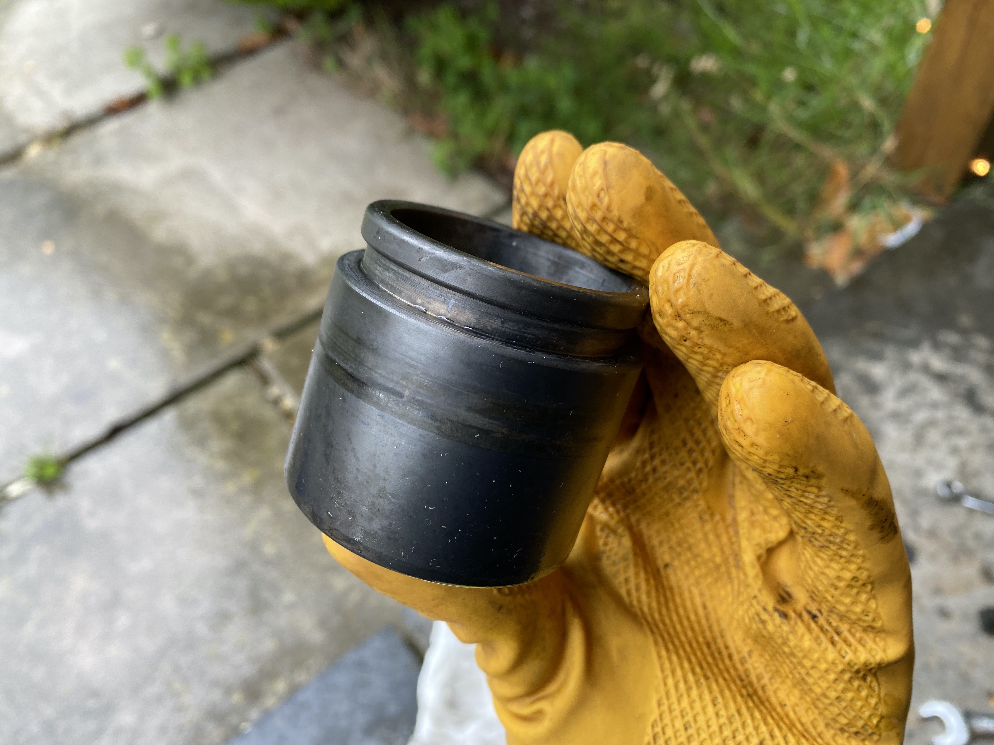

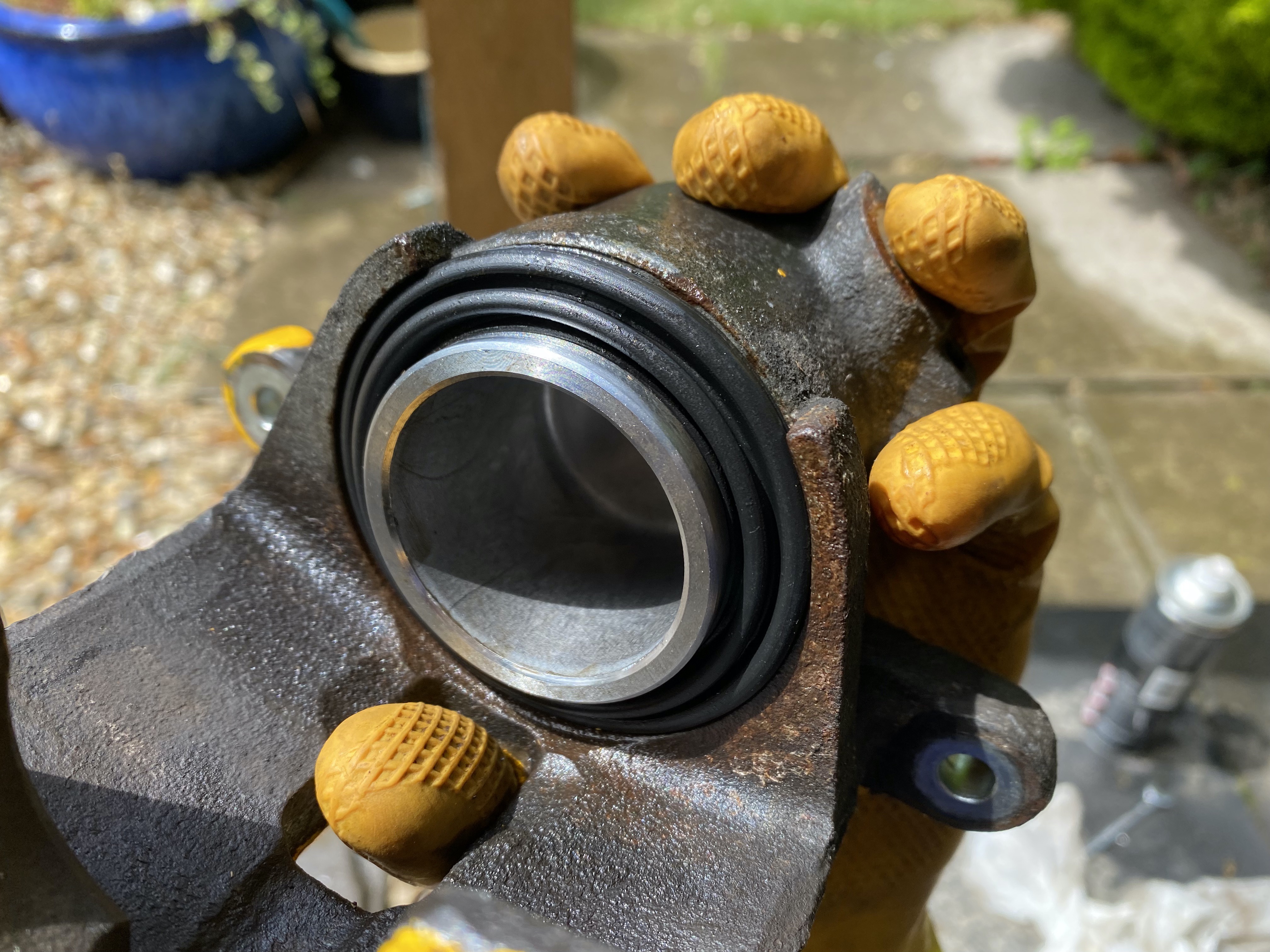

Popped the piston on the caliper today to assess the damage, but to my surprise the piston is perfect.
The seal did have some rust on the edges, so it was a good time to change it
After spraying with PlusGas and going nuts with a wire brush inside, it came up a lot cleaner.
Nice and shiny.
After bleeding the system, the brakes registered a perfectly even temperature across the two fronts after a spirited drive, both reading 56°C on the discs. I didn’t think it would have made a difference after looking at the original piston, but there we go. At least I know it won’t fail now.

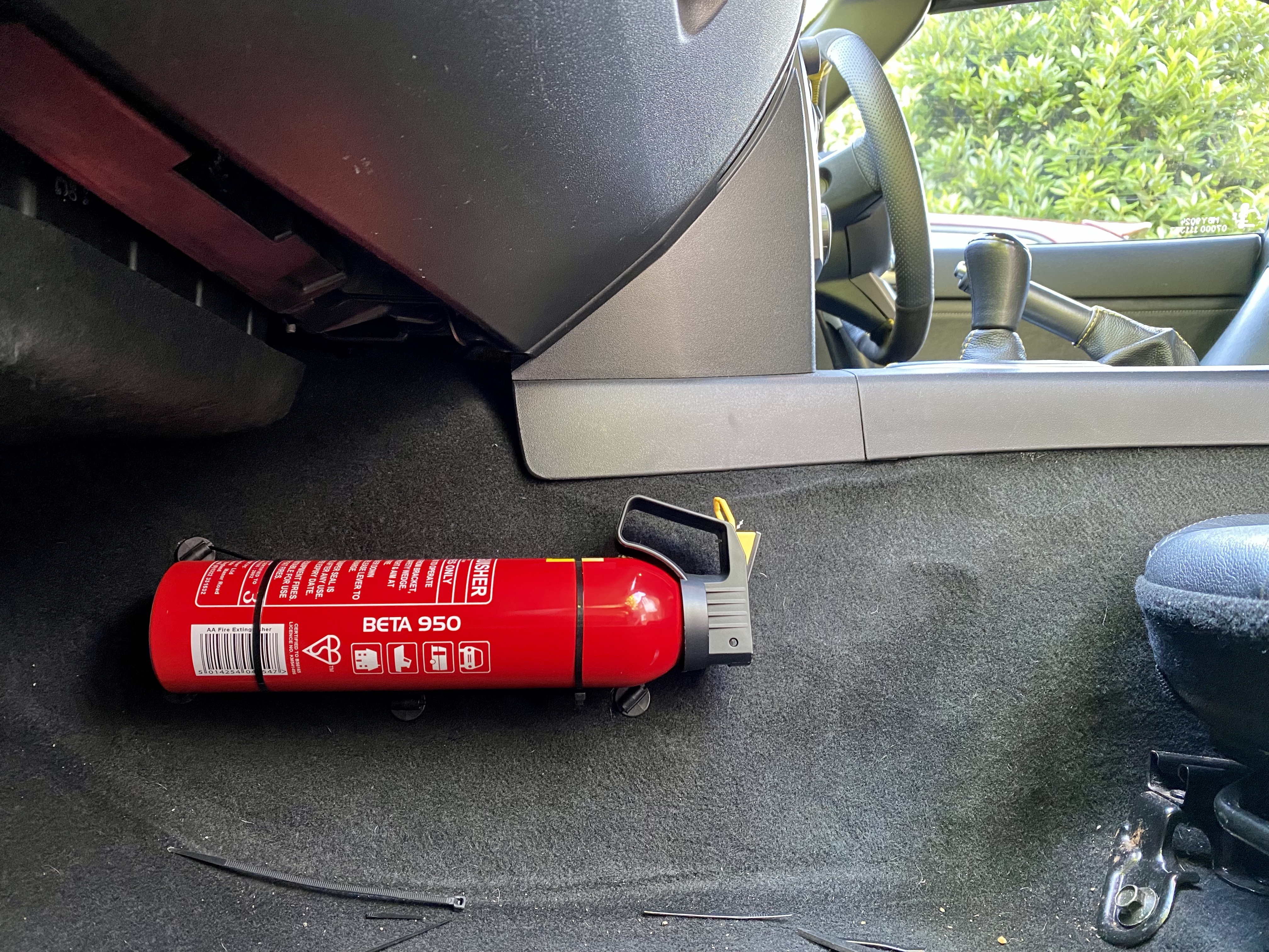

Lastly, I fitted fire extinguisher is in its place.
I’ve basically removed the net, made a sort of ‘clothes line’ of one huge cable tie across the two net attach points, then put two cable ties around that holding the extinguisher in place. It’s sturdy, but allows it to be slid out if needed. It’ll do until I can be bothered to spend £40+ on a mount designed for the MX-5.

After another run in the car with the re-built caliper, the O/S/F brake was still a touch warmer than the other side. Not worryingly so, but it shows the piston was fine after all. At least it’s peace of mind with it changed. I cleaned the pad clips and re-seated everything and it seems to have done the trick.

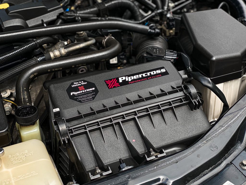

In the meantime, I’ve bought and installed an original un-cut air box for the Pipercross filter to go into. I’m still paranoid about water on the ECU with my cut up version, and I know the original must (even marginally) perform better. Plus it looks neater.

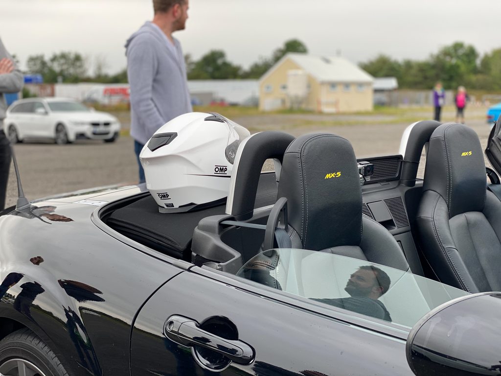

The list of equipment that I took was extensive, but knowing what others were taking it was a good idea to be prepared. Better to have and not need than need and not have, so if it fit in the car and there was a potential that I’d use it, I took it.

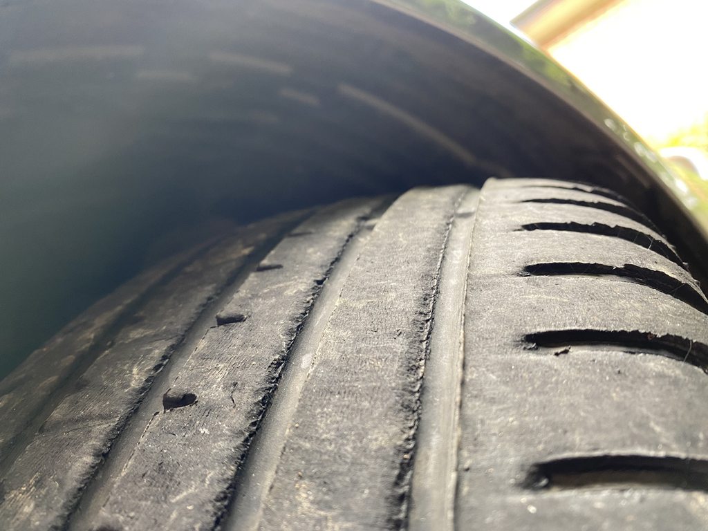

Had a look at the tyres today. They held up really well on track, but looking at them today they’ve been a little ‘sculpted’ by the anti-clockwise circuit leaning on the left tyre too much:
The rears haven’t done this, but they’re a different tyre and there’s less pressure. Oh well, an excuse to get new tyres at some point! I need to go and drive it so that the road would hopefully flatten these edges off.

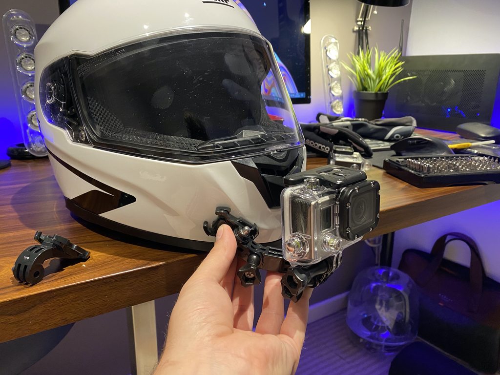

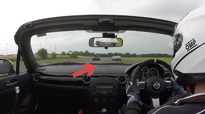

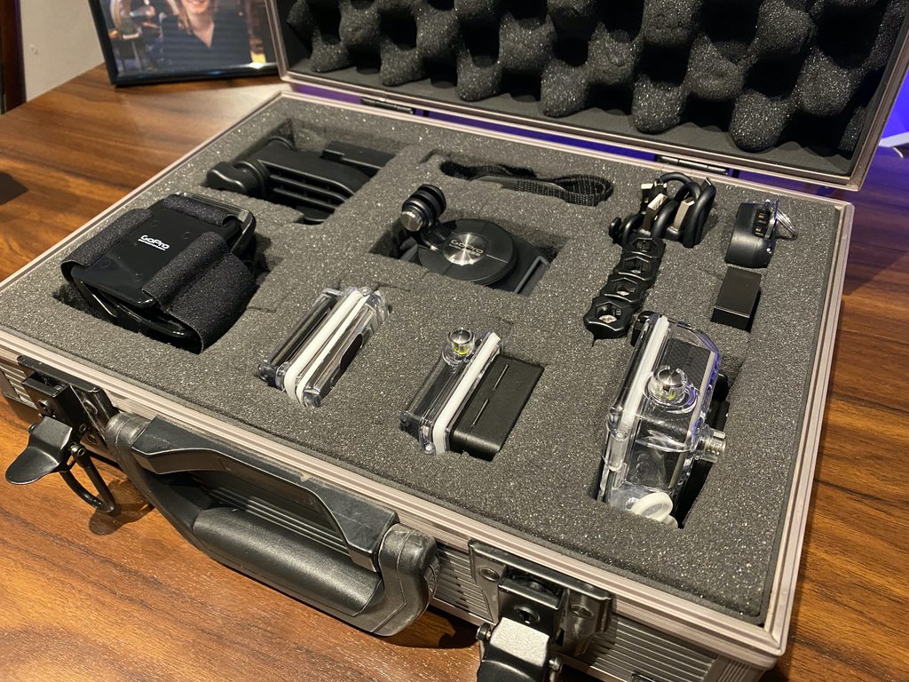

A friend of mine was selling his GoPro Hero3 Black but sold it to me for a great price, so I couldn’t turn down the offer. The one I used on the day was from work taken off a drone, so it’s good to have my own. I’ve wanted to play around with a POV style camera for a bit but it’s proving to be quite difficult.
That looks good but all you see is the steering wheel. On top just shows the windscreen surround, and on the side is quite uncomfortable as you can feel it pulling on your head (plus looks odd). I think I’ve managed to make the above location a little higher so it’s a happy medium.

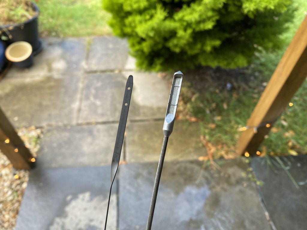

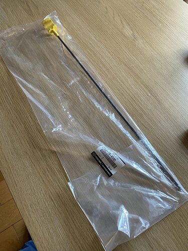

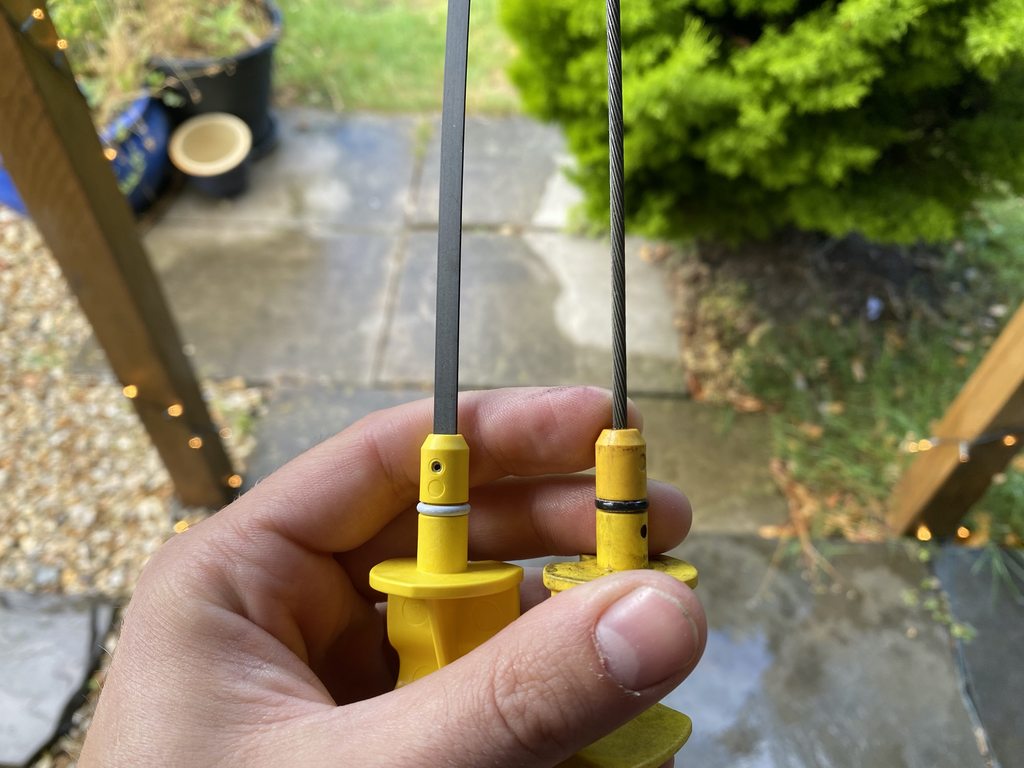

Anyway. In the meantime I’ve ordered a new oil dipstick as I kept borrowing Ian’s to ensure I was at the correct level. I don’t know why they overly engineered a dipstick as the facelift was so much more simple; a piece of metal with two holes.
New on the left, old on the right.
Surely this would also have been cheaper for Mazda to re-produce on a mass scale? Odd decision by them.

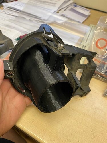

I’ve just 3D modelled this 52mm gauge pod thingy to go into the dash speaker:
I’ll 3D print it this week at work to see how the finish is. If it looks good then I’ll order some 52mm gauges (though I’m not sure what the second one would be, or even why I modelled two in the first place). If not, I’ll order a 60mm gauge as apparently the 60mm ones fit into where the dash vents are without modification and without adapters.
Here’s the 60mm gauge for the dash:
I’ll most likely go with that option as it’ll be a little more integrated, but it’ll be good to see how the 3D model looks when printed.

Or you could have drilled 2 small holes in the oe dipstick and saved yourself some ££’s (like I did :wink: ).

Hi Ger, that 3D printed gauge pod looks awesome. If it works out well, and it’s to your satisfaction (I can see you only do things with great execution), I’d be prepared to buy one from you if you have the opportunity to print a second?

I’ll be honest, having the flat simple dipstick is a tad easier to read anyway.

Of course, I’ll see how it turns out but I’d need a 52mm gauge to try it in. I may pick up a cheap chinese Ebay one for the time being as I’m most likely going to go for the 60mm pod to put in the dashoard for mine.

I didn’t realise it was swappable…… interesting! Still think the dashboard pod you’re printing would be a better solution, if gauges can be sourced cost effectively of course. Look forward to tracking your progress mate, always great updates :ok_hand:t2:

I’m sure you know your Onions Ger but I’d be really careful about fastening a GoPro to your helmet especially the front. Your visor will be no match for that tough poly carbonate clad camera if you have a serious impact. Michael Schumacher had a GoPro on his ski helmet as I recall and it was a likely contributor to his injuries.
