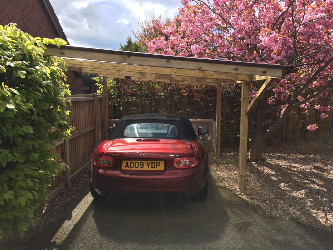

Hi there - this seems to work ok for me, near Blackpool, major westerly winds in winter. I must admit I put in a sheltered position, but still there are pretty severe winds every winter.
4 X4 wooden posts and 3x2 beams seem to do the trick - maybe extra securing of the polycarbonate roof would be prudent for hurricanes, but if you slope it into the prevailing wind direction it should be ok. Glass was out of the question I’m afraid.
https://s31.postimg.cc/60phaczm3/IMG_2006.jpg
Something like that might be possible - and relatively inexpensive too. It would be just enough to keep the worst of the weather off. Thanks for the idea.
