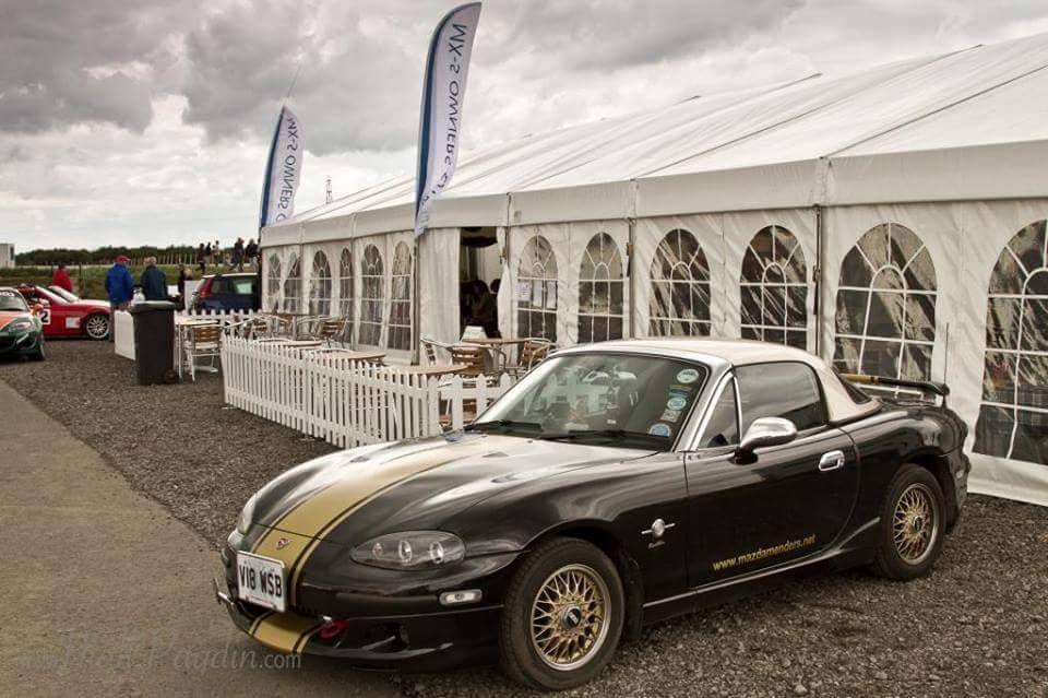

The 1999 SE came with special 10 spoke alloys which I believe were 15", so would have had 15’s from new.
I know because we owned this one.
Not sure what size the tyres were, but somebody with more knowledge than me will probably advise.
What I can say is the car drove well and roadholding and cornering were great. Not driven a Mk2 on 14" wheels so unable to compare.
There were several Mk2 (and Mk2.5) variants fitted with 15" wheels so I wouldn’t think there would be an issue providing the correct spec tyres are fitted.
