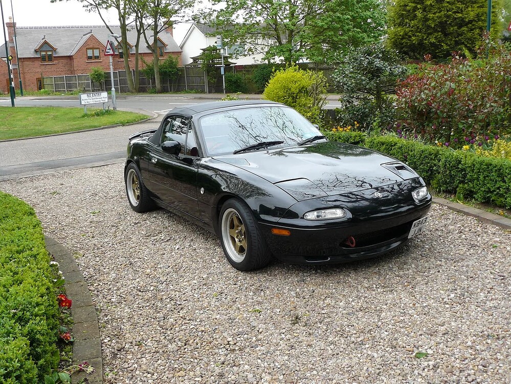

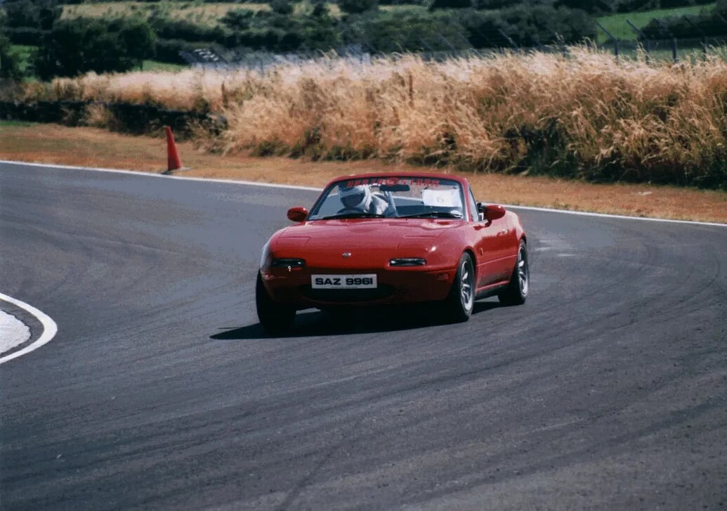

Incidently, the silver car was on 15x8 Lorbers, with 206/50 tyres. They caught a little.

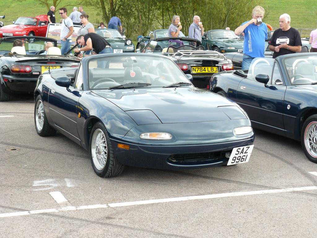

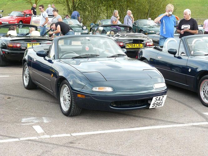

My 96 with factory BBS (15x6, 45mm offset)
