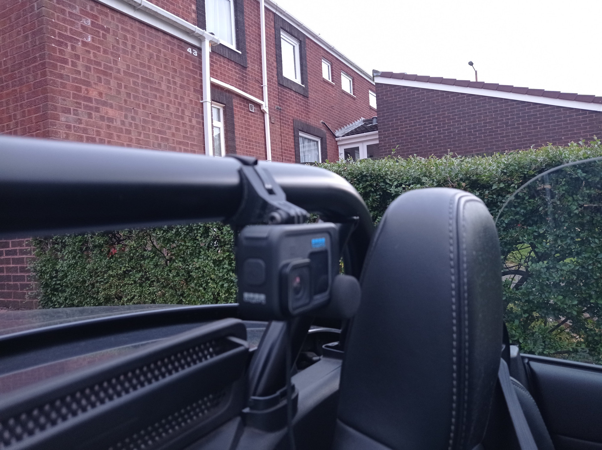

Well.. Its been a few years since this thread was mentioned, so I thought to update with my final solution.

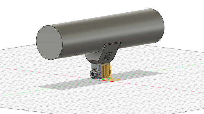

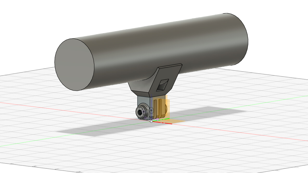

I’m using a 3D printed adapter that I have designed to fit my roll bar. I used a bit or UHU por glue to make sure it doesn’t slip (it doesn’t slip and its been there for years now) and its secured with two tie wraps. It’s been perfect since.
Camera solution - I have two of those mounts, one for the forward-facing GoPro with the mod adapter. I ended up using the external speaker and I use a rode VideoMicro Compact On-camera Directional Microphone attached to the glove compartment via another 3d printed mount. The induction and exhaust noise is perfect and if I’m driving with the roof down I use the supplied sock on the mic.
The rear GoPro is standard I don’t need to use the recorded sound for editing other than for synchronization, so wind noise is no problem. Both cameras are powered via usb C cable from an Amazon cigarette lighter DC power socket.

If you want the stl for the adapter, tell me what dimension your roll bar is in mm and an email to send the stl.
If the roll bar is anything between 25.4mm and 34.9 mm in diameter then there should be plenty of readily available bicycle handlebar mounts which will do the job (possibly needing a simple shim depending on the roll bar size).
