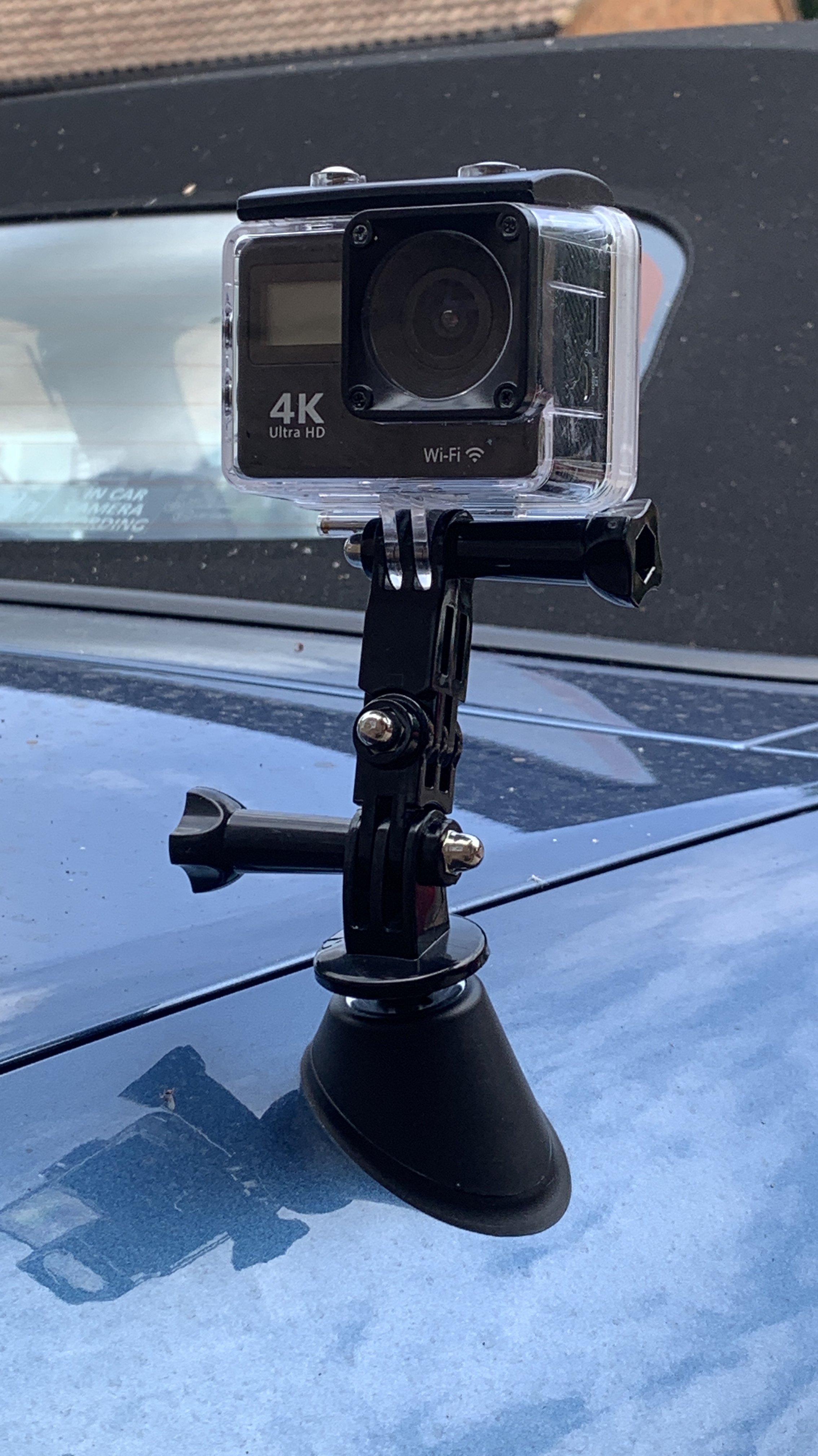

Some ideas for you, all made with one of those cheapie gopro addon kits from eBay around £15 or so.
Should all be self-explanatory! I would also recommend a cable in case of something vibrating loose.
The roll bar hoop is the one I’m aiming for I think. I’ve had it on the front screen and while it gets fair footage, it can be a bit boring without some frantic elbow out involvement :smile:
I’d expect a fair bit of vibration and/or movement with all of those fixing arrangements.
No better or worse than when my camera was on a double-sucker mount. After all, if you can feel a vibration, then the camera will as well. I have a 3D anti Shake Rattle and Roll camera mount that cost over £100 and that gives images like you see on car mounted cameras on TV. The ones I experimented with give +/- on what you will see from a car safety camera mount.
