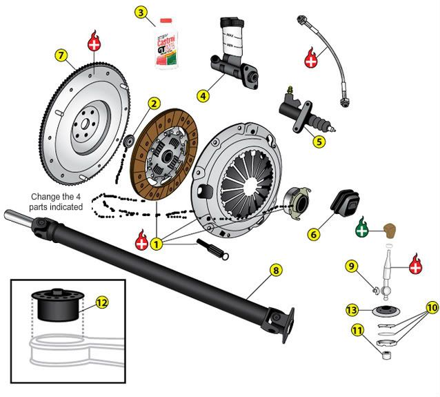

A 3 part kit is usually the cover, plate and release bearing. The spiggot bearing is rarely included in the kit, although for a bearing that costs a couple of $$ I really don’t know why.
Here’s a pic that shows the components
From left to right down the middle. [7] Flywheel, [2] spiggot bearing [1] friction plate [1] Cover [1] release bearing and [1] alignment tool
Brilliant. Cheers Geoff, that’s made some things a little clearer - I’ll keep you posted as to what happens!
