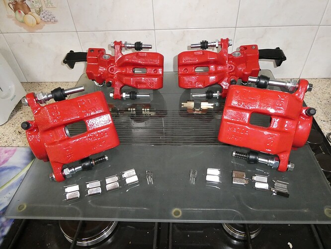

Ooh you are 24 hours too late in asking, i could have took a pic. Had mine all lovely and greased yesterday on the bench ready to refit.
Here’s a another pic instead borrowed from another thread.
The nice shiny pins in the red calipers (yours will probably be a dull worn silver type colour, standard) are the things that need greasing a pair on each brake caliper.
Similar for front and rear brake calipers. Just to add not to use any grease, red rubber grease is a favourite, it’s kind to the rubber sleeves, for instance don’t use bearing grease, a no no!.
