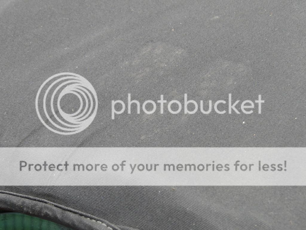

What do you recommend for re-blacking the roof - mine has some marks, looks like the glue from underneath where the panel attaches that could do with a dye to hide ?
cheers
