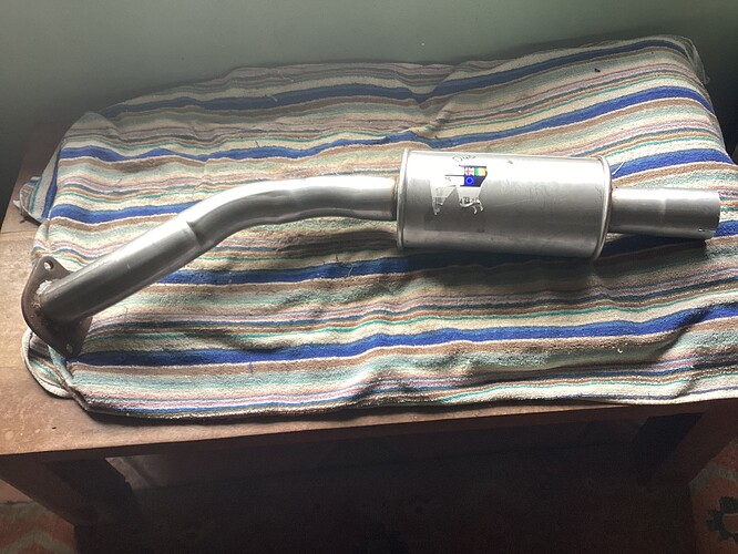

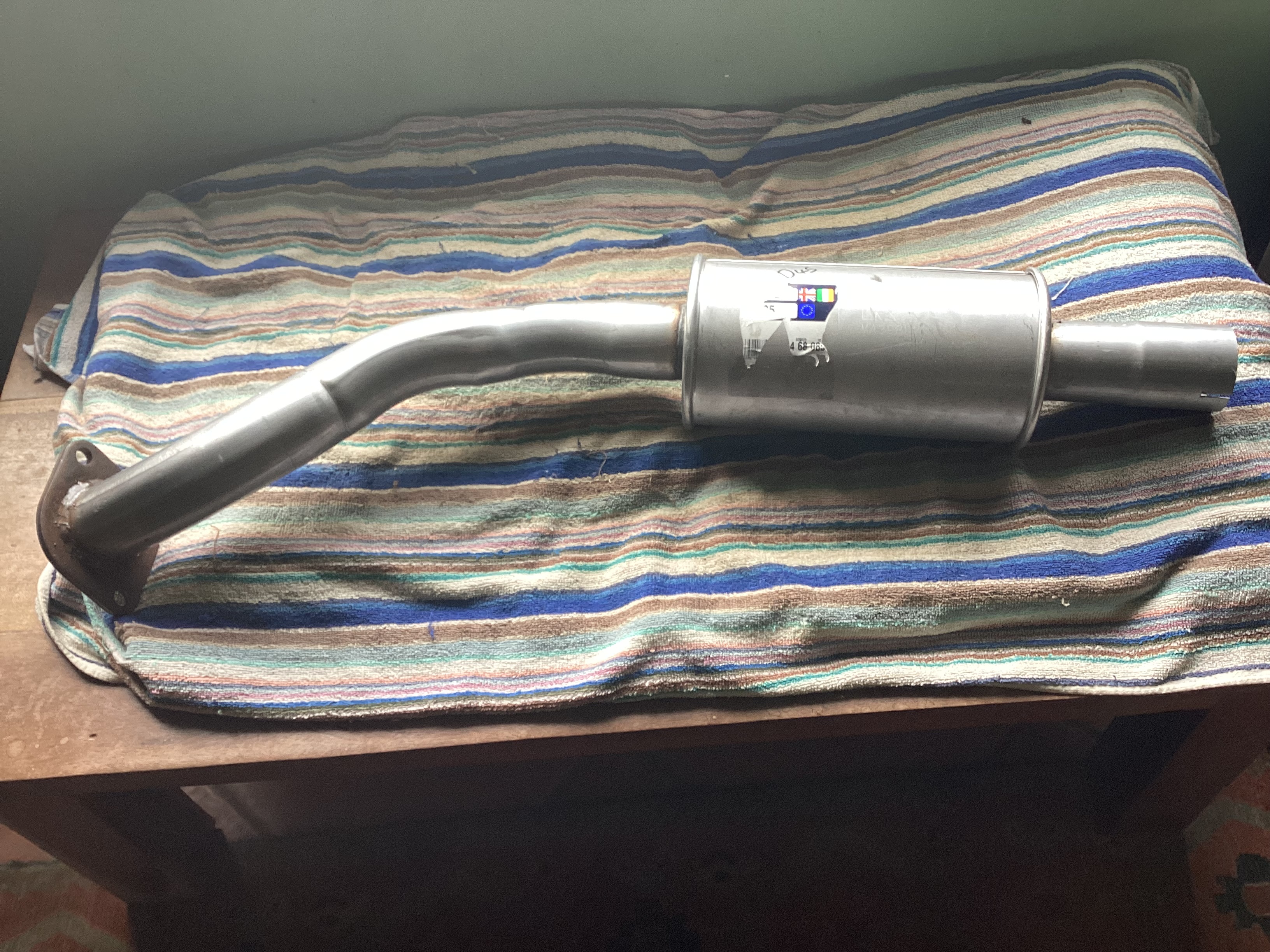

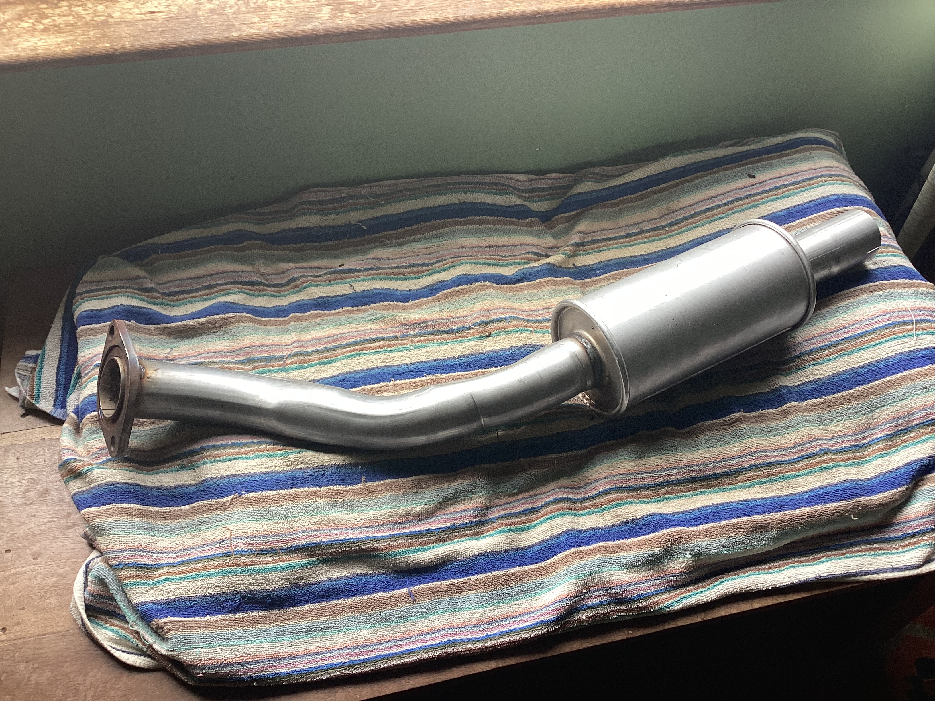

Was sold this as for an NC. Sadly it’s about six inches shorter than the resonator section of my exhaust on my NC1.
Ive already come across lots of minor changes between the various manifestations of the NC. Maybe this is another example?
Sadly the toe rag that sold it to me won’t do a refund ( “ it’s Facebook MarketPlace innit” [ no postage involved]) it was just £30 so no great loss except to his Karma.
It looks like a std NC repair section to me.
Have you offered it up to the car? These are meant as repair sections, you cut the pipe section and this just sleeves over the existing pipe. As I’ve seen others with these the weld goes on the box, cut and fit to suit.
Thanks guys! I assumed it was a replacement rather than a repair part.
