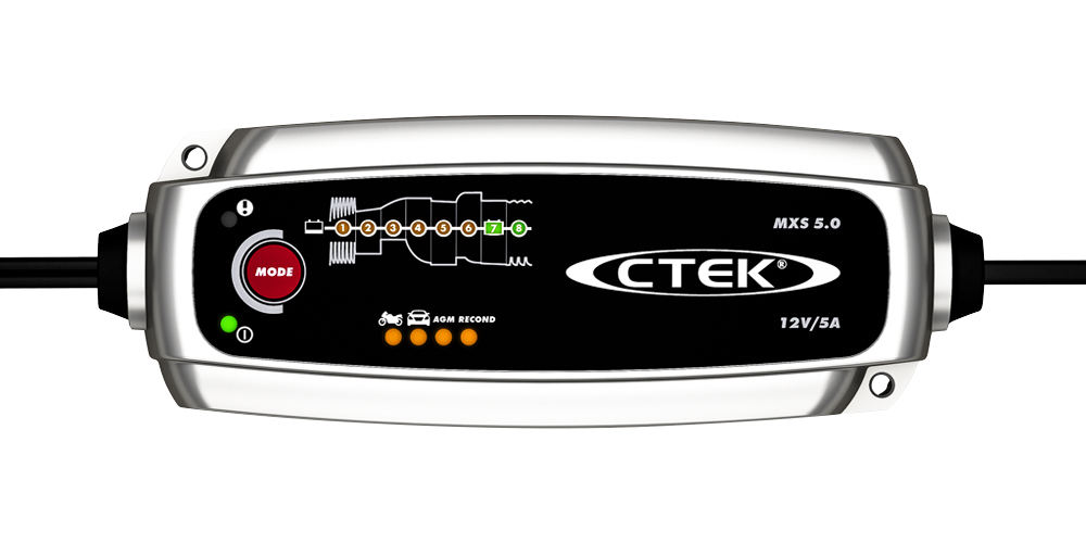

So, the Ctek charger crops up more than once and appears to be a must have item, any recommendations on which model, I looked on Amazon and there are loads of different ones. My booster pack is a NOCO Booster Plus GB40 (I don’t think it does trickle charging) and after digging out the manual, it turns out, as some of you have said, that it doesn’t work unless it detects a certain level of power in the battery - the good news is, there is a way to override it.

I use a CTEK-MXS 5.0 (link is for info, it’s cheaper elsewhere)

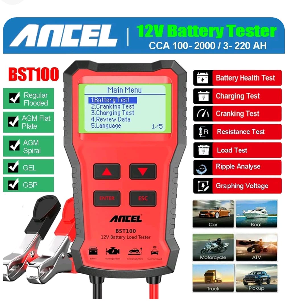

I’ve just replaced my battery tester to this below. You can keep an eye on the condition of each battery. I have three and as suspected one is taking a charge and showing it’s fully charged but really the battery is past it’s best. The other two show in good health.
