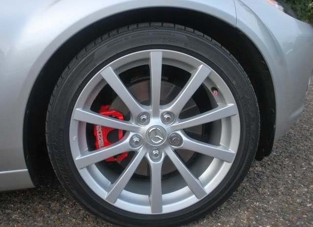

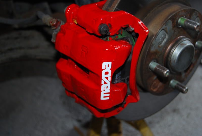

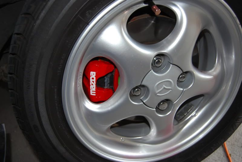

 I’ve used it.
Good coverage, easy to use, dries quickly, no peeling or issues yet.  Thumbs up
 I’ve used it too.  It works a treat if you follow the instructions on the tin.
 Me too, followed the instructions - no problems whatsoever.
 Wow, very pretty you two! Thumbs up Looks like the old Hermetite red engine enamel, very glossy and almost translucent, done a couple of engines with that, lovely. Where did you get the Mazda graphics?

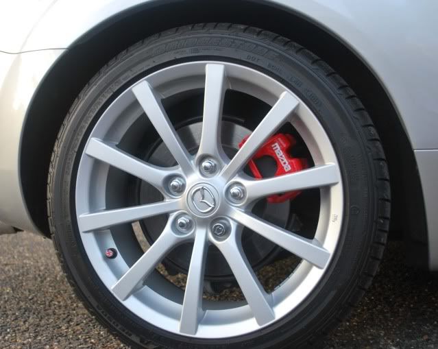

 I did mine with Halfords red last summer - great results, just like the pics above. Time wise, I had it up on four axle stands, and by the time I’d got the last one finished, the first one was ready for another coat - I did four coats in total. A lot will depend on the air temp, but I’d read that the subsequent coats should be applied before the the paint has compleately dried - can’t remember if it says on the tin?
E-bay, from somewhere in America if my memory serves me correctly.
When painting, I worked round the car and by the time I had finished the fourth caliper and had a cuppa the first was ready for another coat. I think I applied a total of four coats.
Six months on and they’re still looking good.

Got mine from http://funkygraphics.co.uk/ nice guy and you get what you need unlike other ebay sellers.

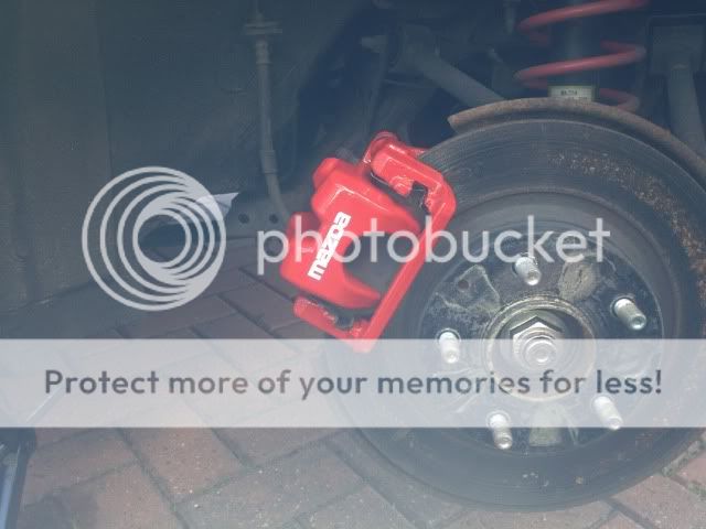

Paint dried quick enough to do multi coats until i was happy, about 3 i think.
These are mine on my mk3
