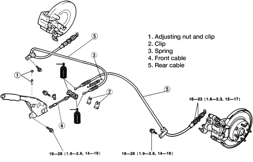

https://www.autozone.com/znetrgs/repair_guide_content/en_us/images/0996b43f/80/e4/33/29/medium/0996b43f80e43329.gif

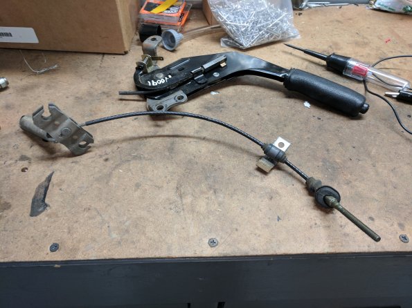

I would think about backing off the handbrake adjuster, and investingating the cables further. NA and NB handbrakes are the same. Slip off the handbrake cover (single screw, then it unclips apart) to expose the adjuster screw
http://twitswithspanners.com/post/2017-05-13-the-mx5-handbrake

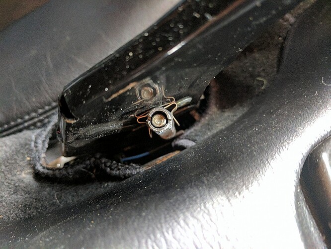

With the platic cover off, this is the adjuster to slacken, using a screwdriver or spanner
The guts pf te handbrake handle
