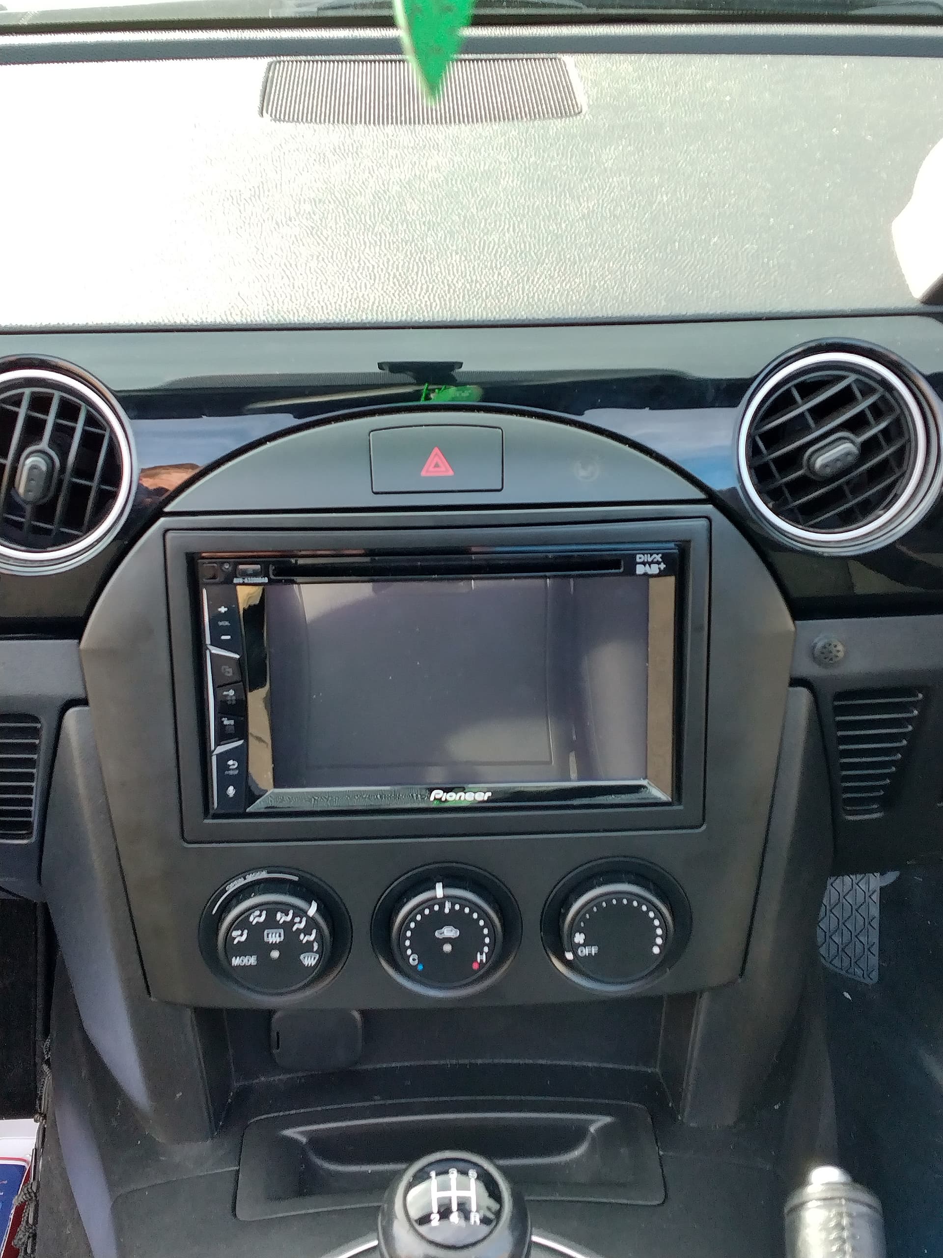

Hi all, the phone handsfree in my MK3 isn’t very good sound wise. At the moment its mounted on the centre consul just in front of the gearstick. Is this a poor place for it or could it possibly be a poor microphone? Would up on the A pillar somewhere give a clearer sound? If anyone has a photo of theirs I’d be interested to see it.

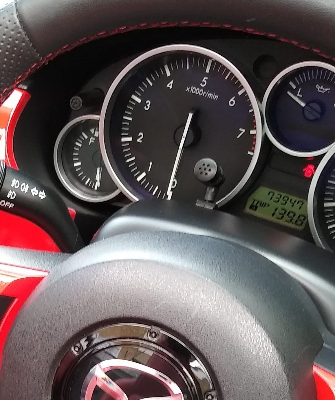

I mounted mine to the underside of the instrument cover thingy ,my mic had a clip and a self adhesive pad option , great quality sound , not the best pic but should give an idea .

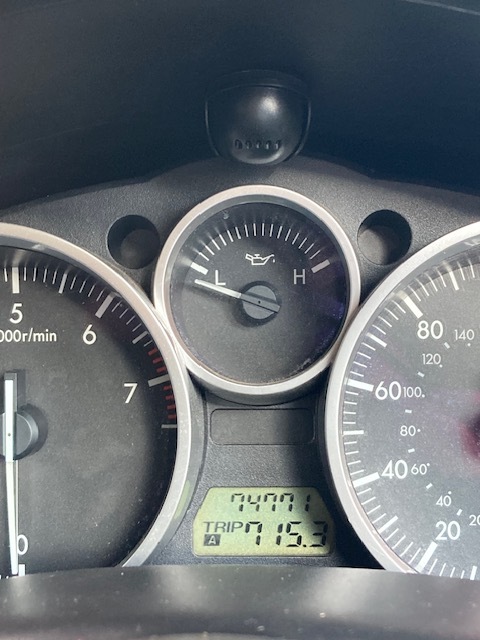

Never had a problem on 2 NC’s mounting it in a similar position to the pic above. Mine was stuck on the shroud behind the steering wheel. I stuck the bracket on that comes with the mic with some 3M tape.

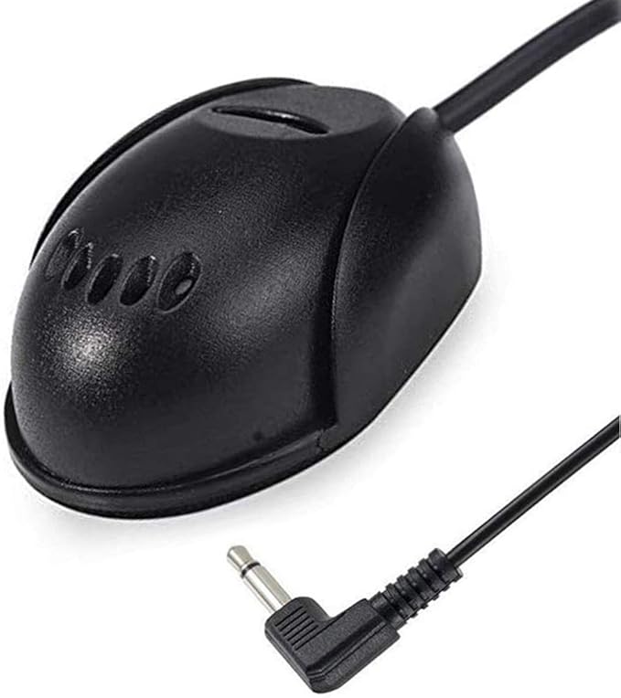

My microphone is similar to the one in MickAPs photo but I’m thinking of changing it for one of these as I think it would blend in better.
That is the type that arrived with my EONON Q04pro
Can’t fault it.

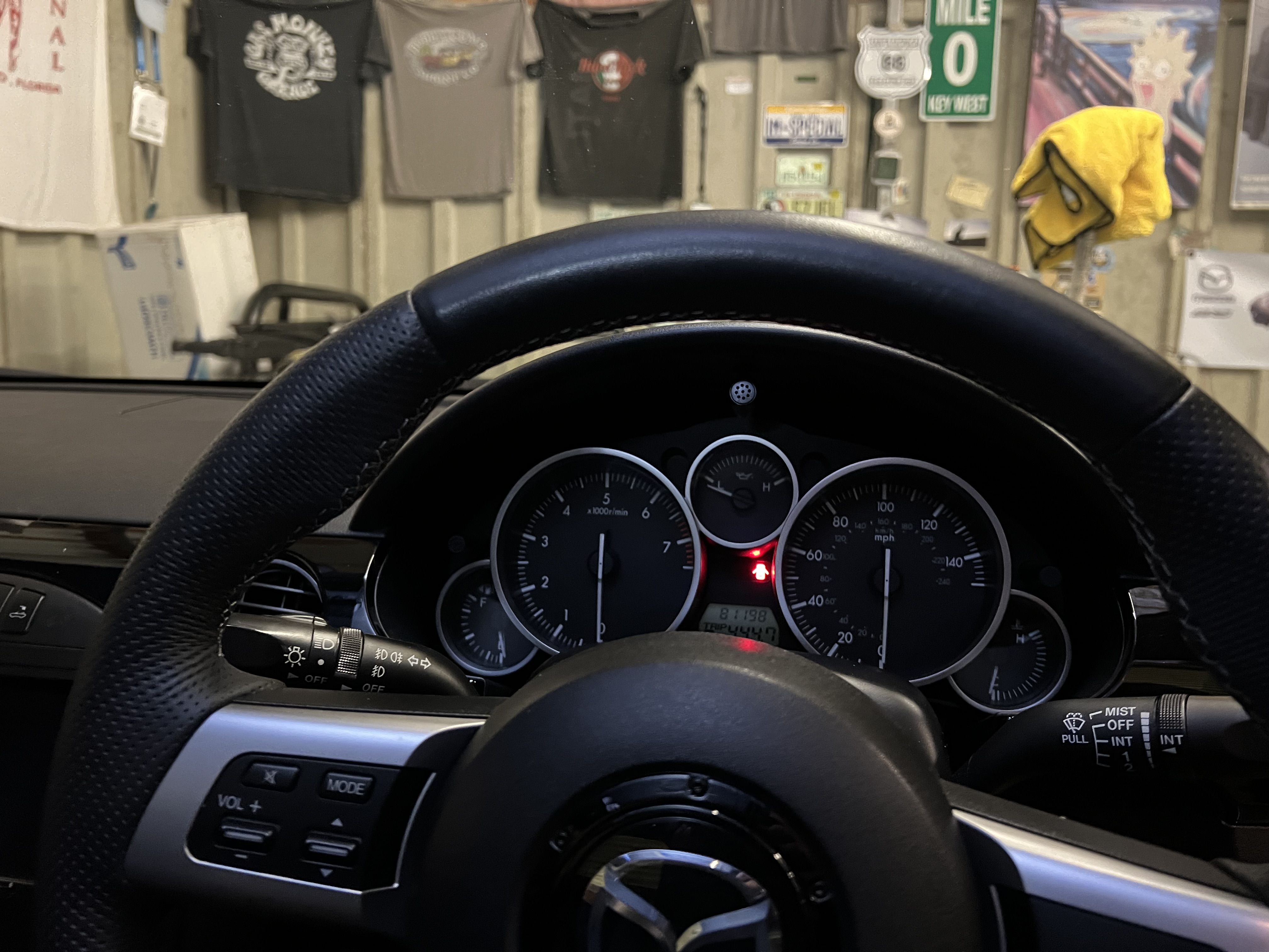

Mounted on top of the steering column shroud
