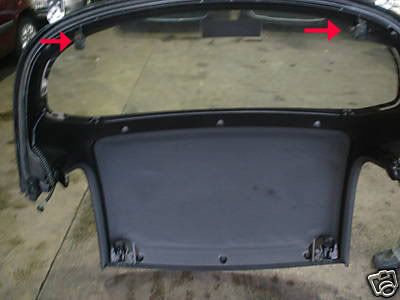

Just purchased my hardtop today fits a treat except I seem to have some extra locking points. There are 2 at the front top of windscreen, 2 at the side by door pillars and 2 brackets at the rear of the roof. Here is a picture of what I mean, I have not seen these before was told by the seller that it is a genuine Mazda.

I don’t think I have explained properly, the arrows are pointing to parts INSIDE the roof. The parts you (Martin Young) are talking about are chrome brackets on the OUTSIDE of the roof which are sitting nicely on top of the bolts.
As I explained the roofs fits perfectly, only reason for my question was to find out what the 2 spare brackets (arrowed) are for?
A close up, clearer picture would be helpful but the brackets inside my hardtop do line up with the softtop catches although they dont actually touch them without packing with foam or rubber or something. (i have never bothered). I always assumed they were there to stop the softop rattling up & down. Would i be right?
