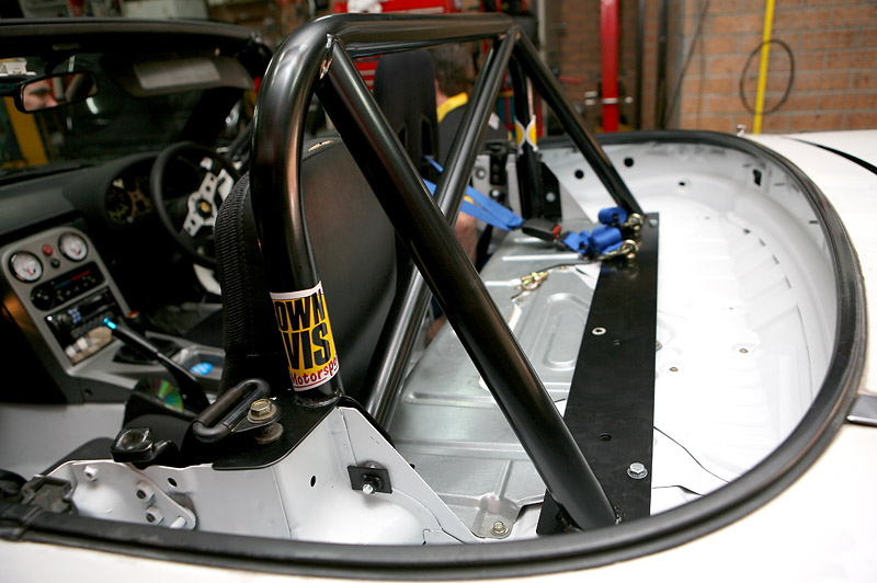

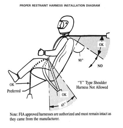

Most rollbars can be specified with a harness bar, which usually includes UNF tapped points to fit the shoulder straps. Some people wrap the straps around the bar to attach, but I prefer using the tapped points so the straps can’t move outward. Do not use the 1.8 factory cockpit brace as a harness bar; its not strong enough. If your rollbar doesn’t have a harness bar, the correct place to attach the shoulder straps is by drilling points at the rear of the shelf behind the seats, and fitting strengthening plates.  This point is specified by the JAF for Eunos Roadster racing (they frown on bolt in harness bars), but is suitable only for the drivers side. Scrutineers had no issue with my chosen mounting point in hillclimbs/sprints. This also gives the correct 10 degree deflection from the driver’s shoulder. When I’ve used harness bars, the loading from the shoulder straps can be pretty painful.

This is a bad way of attaching shoulder straps in a MX5; seen it too often in this country;
This Japanese owner did what I did, basically;
The yellow hatched area is the part you can’t use.
Strengthening plates (you can fit bigger)

Having seen many a crashed Mx-5, I wouldn’t attach shoulder straps to the rear parcel shelf for love nor money.I don’t care who says what about the strength, a substantial rear end impact and the shoulder will be loose.
A substantial rear end crash will also compromise a bolt in rollbar. A substantial side collision will also cause failure of the seatbelt tower in 89-93 cars. In a properly run trackday, it is unlikely that one car will run into another. If that happened, the organiser will likely be facing HSE investigation and criminal proceedings. A car will not run into the back of another during a sprint or hillclimb.
An Australian CAMs approved solution; the harness integrity is no longer dependant on the integrity of the half cage
And in what way what so ever does a statement like that make a pikey modification of drilling through your parcel shelf to fit harnesses mitigate doing the job properly?
Of course no one has ever parked backwards in a hill climb, track day and never ever on the road. Do it right or go home!
That’s the most stupid thing I’ve seen all week.
Every other decent rollbar bolts down to the chassis, not onto some weak metal.  You can rip through that material quire easily.  I had to cut a load of that out to fit a Hard Dog bar (which is held in by 3 much larger bolts per side).
