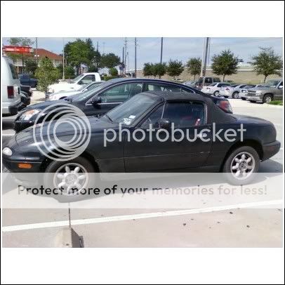

The yellow car is a base refreshed car, using stock Mk2 shocks (Bilstein package), springs and tops. It rides a bit high, even compared to the 96+ cars, which are jokingly referred to as having a 4x4 ride height. Note, Mazda supplied Mazdaspeed with brand new off the shelf parts, not used or refurbished parts.

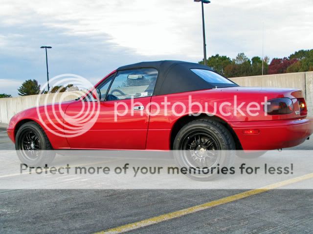

A US owner having fitted a NB setup (he doesn’t say which package):
Owners report an average 14.5-15" wheel centre to arch lip measurement.

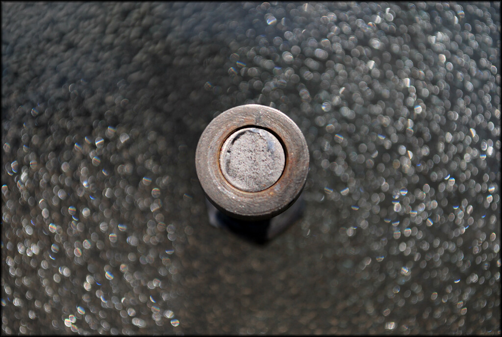

Wow, threaded shaft of a factory Bilstein snapped clean off:
Slight corrosion visible indicates the part had been previously stressed, possible after an accident (or over tightened)

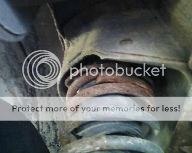

Broken MX5 spring:

 I don’t think wayne charges £45 an hour for replacing a shocker.  After all who would be mad enough to put a spring on like that one on the picture you show.

Not at all. The Bilstein failure was a new one to me; posted it as an example that when you check a used shock, you don’t merely check for leaks, lower bush or damage to the shock body, but also to check the threaded portion of the shock, which can only be examined if you dissemble the entire assembly. Check as well how the breaker has taken the part of the car. Some will be brutal, and use torches to rip it off. Dpends how familiar they are with the car. Autolinkuk is familiar with the cars.
