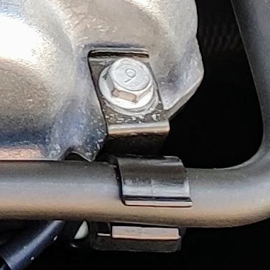

I have spoken to the garage who just say it was done, I am convinced it was not.

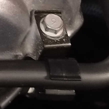

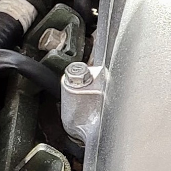

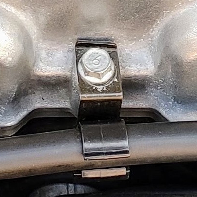

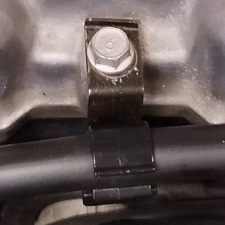

If I can add picture I will show you each bolt before the supposed cam belt change and after. you will see that they are in the exact position, even the washers holding the brackets have not moved.
Bolt 1 new
Bolt 1 old
Bolt 2 new
Bolt 2 old
Bolt 3 new
Bolt 3 old
Bolt 4 new
Bolt 4 old
I am convinced that after fitting the cam cover back onto a rubber seal with sealant in some places the bolts would not line up so perfectly.

All very concerning. To play devils advocate, the bolts holding the clips that hold the rubber pipe don’t need disturbing for a cambelt change, the pipe can just be removed from the clips. The cam cover is actually bolted metal on metal the rubber gasket just fills the void, there are metal “inserts” in the cam cover that protrude through the gasket and contact the head. There is a (very slim?) chance that if the bolts are torqued correctly they could end up in the same orientation.

In your opinion do you think that the cam cover has been taken off and put back?
Agreed, I would say impossible. Every one is the same.
I would be surprised to see all the bolt heads in exactly the same orientation if it had been taken off.
When I work on a car, I do like to put stuff back as it was so there is little evidence that work has taken place. Maybe this is an extreme example of that sort of behaviour. I’m being optimistic again here…

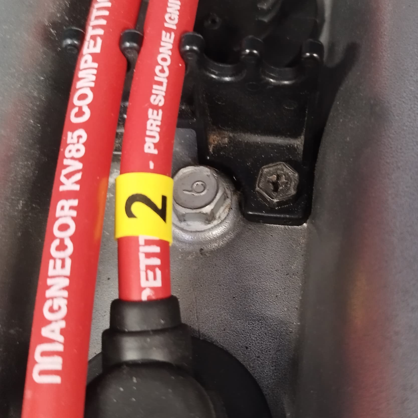

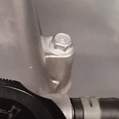

Here are some more images that show the bolts in the exact same orientation.
Bolt 5 new
Bolt 5 old
Bolt 6 new
Bolt 6 old
Bolt 7 old

I very much doubt those bolts have been removed and put back in “exactly” the same place even by torquing them up.
More than happy to be proved wrong.

Are there no witness marks / highlights on the bolts/ studs at all where it may show evidence of work been done ???:thinking::thinking::thinking:
It does look suspicious :face_with_raised_eyebrow:
