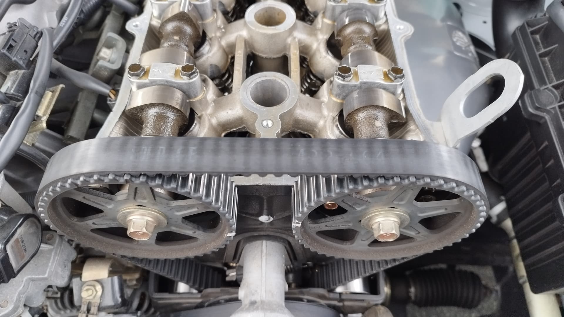

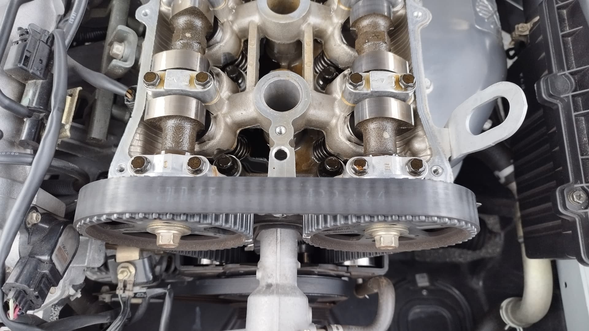

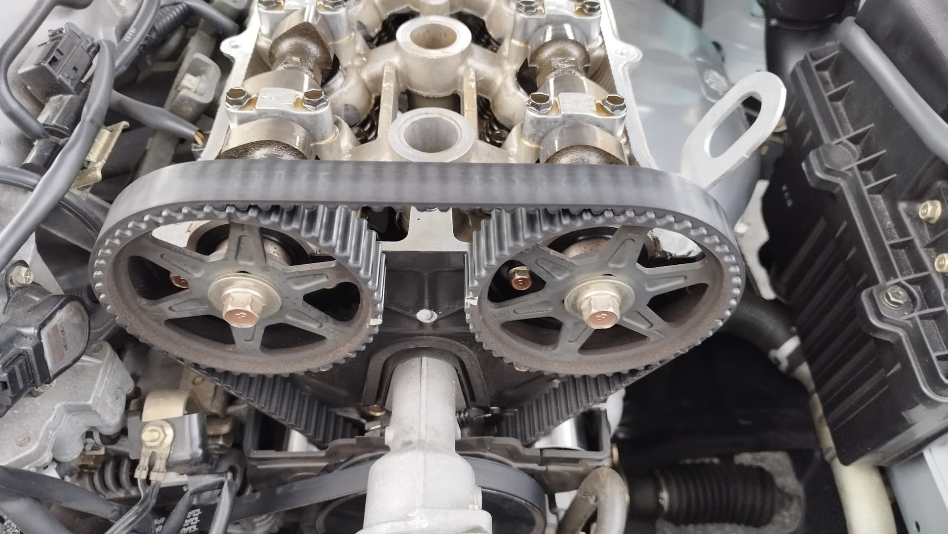

Quick update. Cam cover removed and inside was an old cam belt. Yep I was done over for over £400.

I take it the mechanic who did the work isn’t an apprentice who could have confused an alternator belt with a timing belt, because the alternator belt looks alot newer than the timing belt.
Absolutely not there was no confusion.
I have all my evidence now. I am gonna take this as far as I can go.

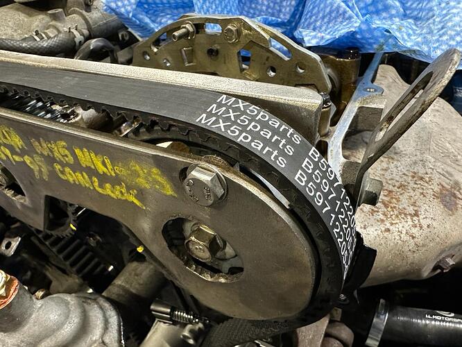

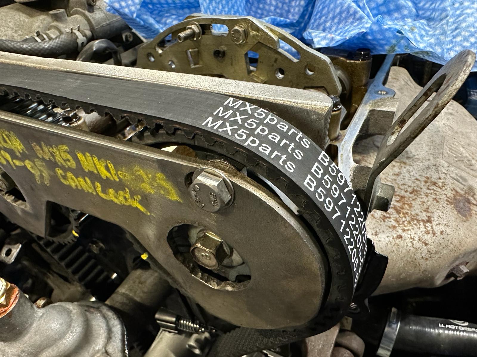

Just for reference … you can clearly see the satin finish on a new belt( taken from the NEC stand project roadster in march)
